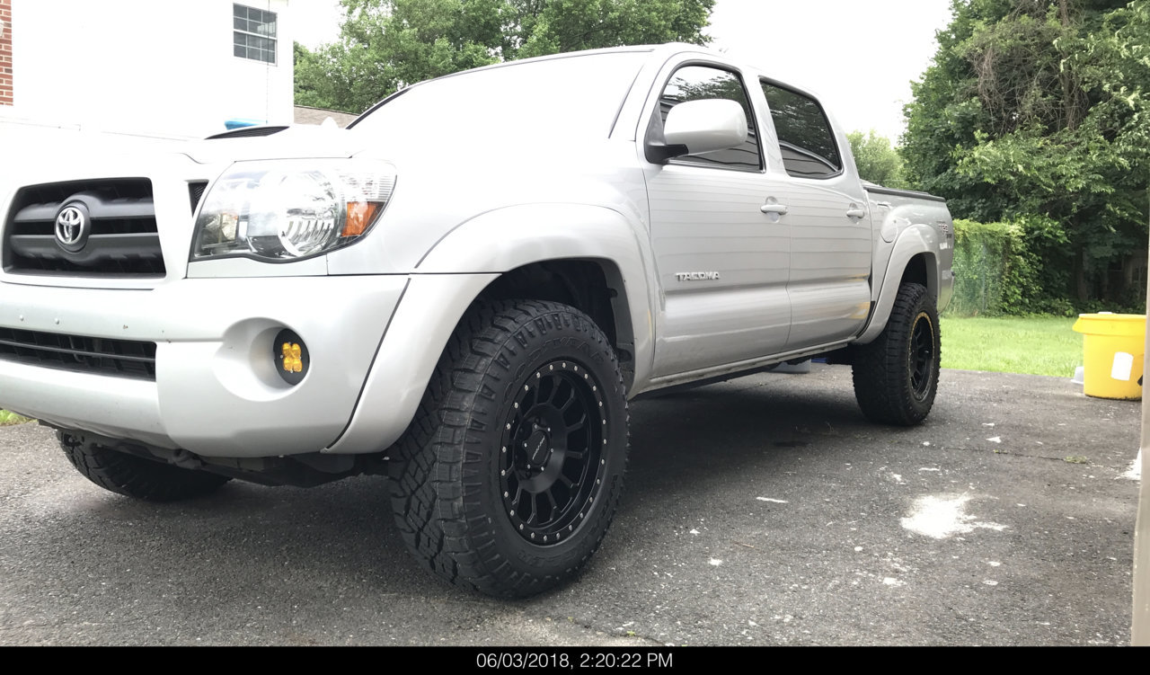

    I love my duratracs also im getting 18-19 mpg with mine. I also like the wildpeaks but I think there 8-10lbs heavier per tire than the duratracs that’s why I went with themF19E3EA5-CEA8-40AD-9257-430C42FF0619.jpg
