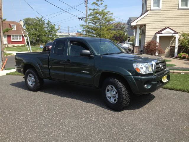

    265/75/16 with (4) 5100 set 2.5" front 1.5"AAL rear

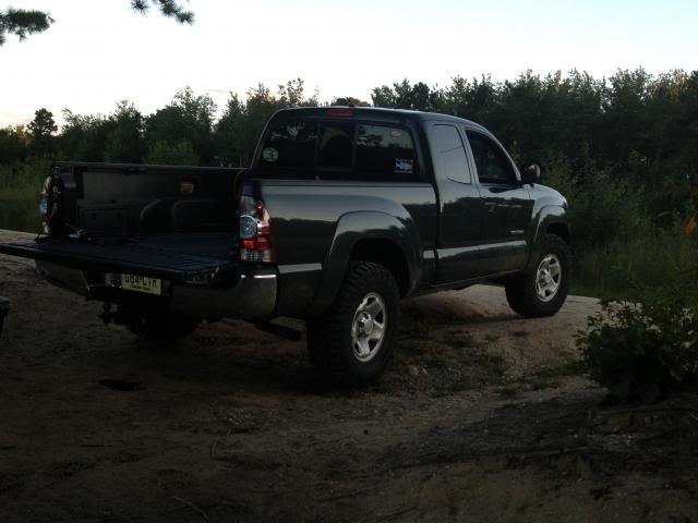

    Bilstein 5100's set at .85, OME 885x coils w/ 1/2" top plate spacers, Total Chaos UCA's, Wheelers 1.5" HD 3 leaf progressive AAL w/ factory overload leaf, DT Pipe Bomb Ypipe, Vibrant resonator, Magnaflow pro series catback system, URD Short Throw Shift Kit, Debadged, BHLM, BTLM, 6000K BiXenon Headlights & Fogs.
    They fit stock sr5 and on the stock wheels. I removed my mud flaps tho while i still had the stock dunflops. Couldnt stand dragging them on the ground every time i pulled out of a driveway. Look great stock. Look great on 2.5" lift. Look good anywhere in between Do it :thumbsup: :thumbsup: :thumbsup:

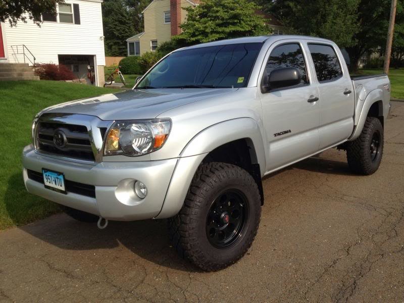

    Truck is running the tires you want with a 2.5'' lift up front and 2'' at the rear AAL

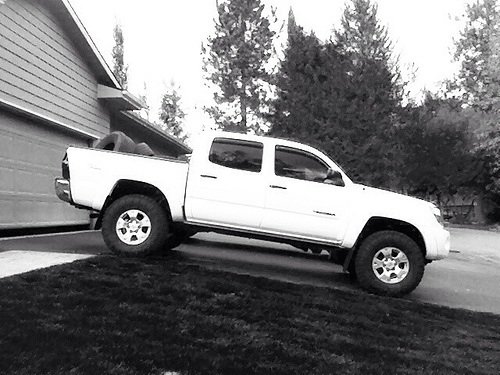

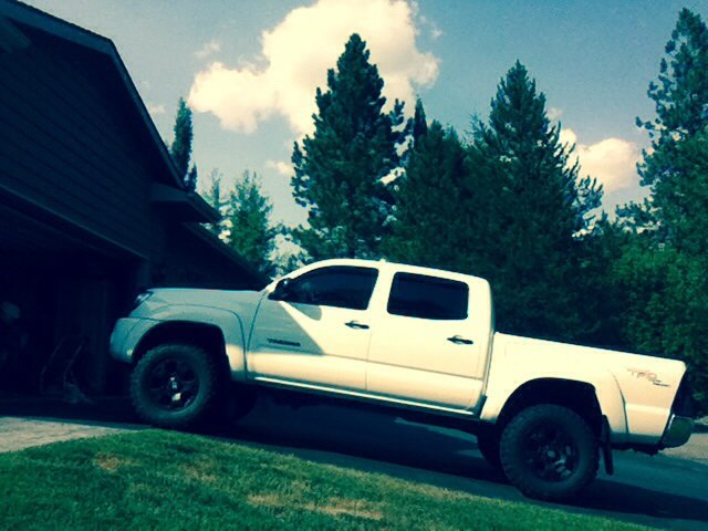

    No need for the lift to run 265s but a lift would make it look that much better here is my truck
    2.5in lift with 265s
    2.5in lift with 285s

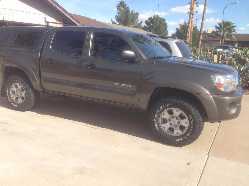

    This is my '11 with 265/75/16 duratracs. Love em. No issues other than they seem to hunt on well worn freeways a bit more than other tires I have had.
