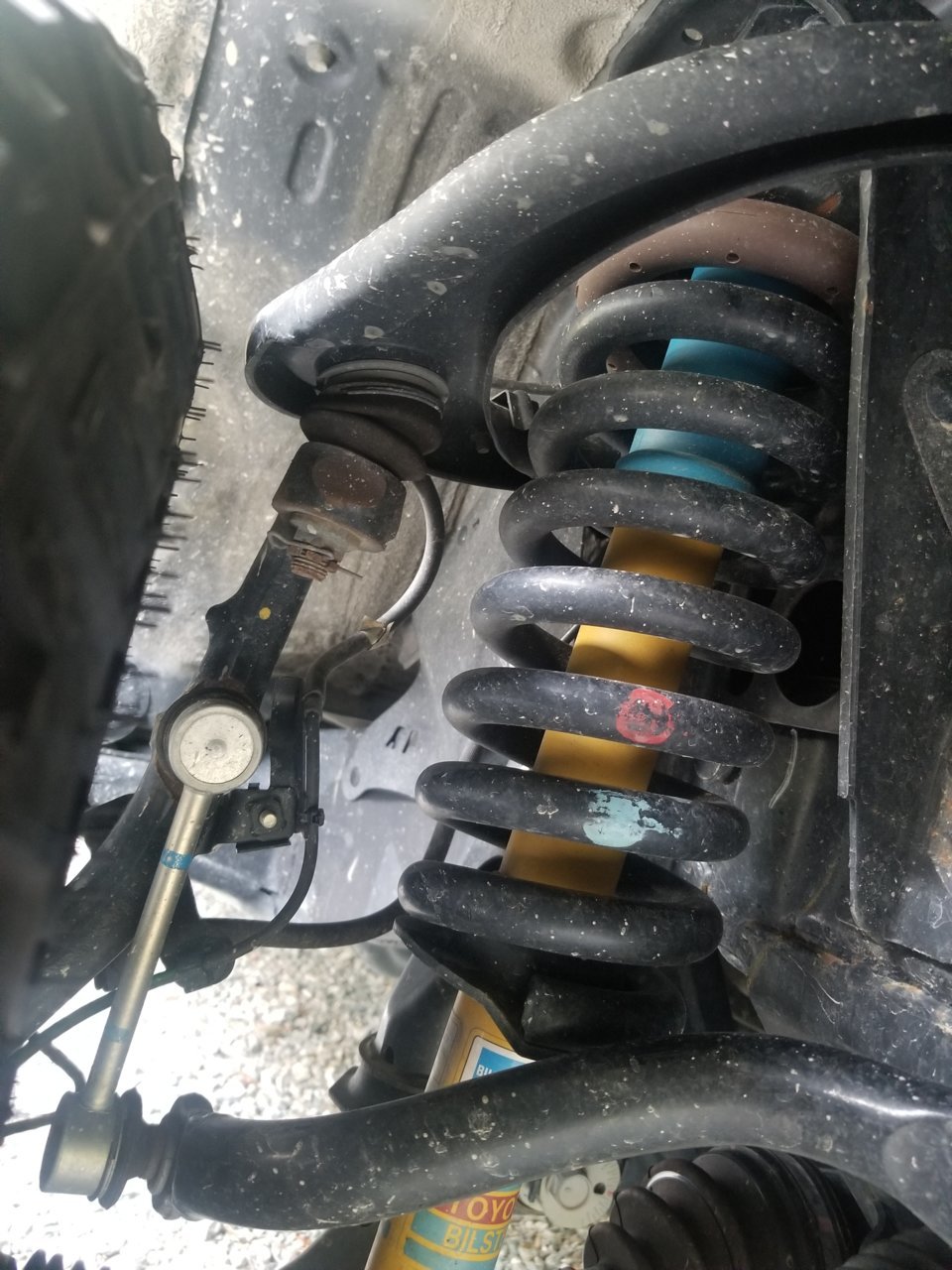

    pulled the trigger...got 5 285/70r17 coming to swap for he dealer packaged 275/60r2020... going to loose 2mm in offset and down from 4.50 to 4.30 bs so here's to hoping I clear the uca! this is the current setup20190522_165116.jpg 20190522_165141.jpg

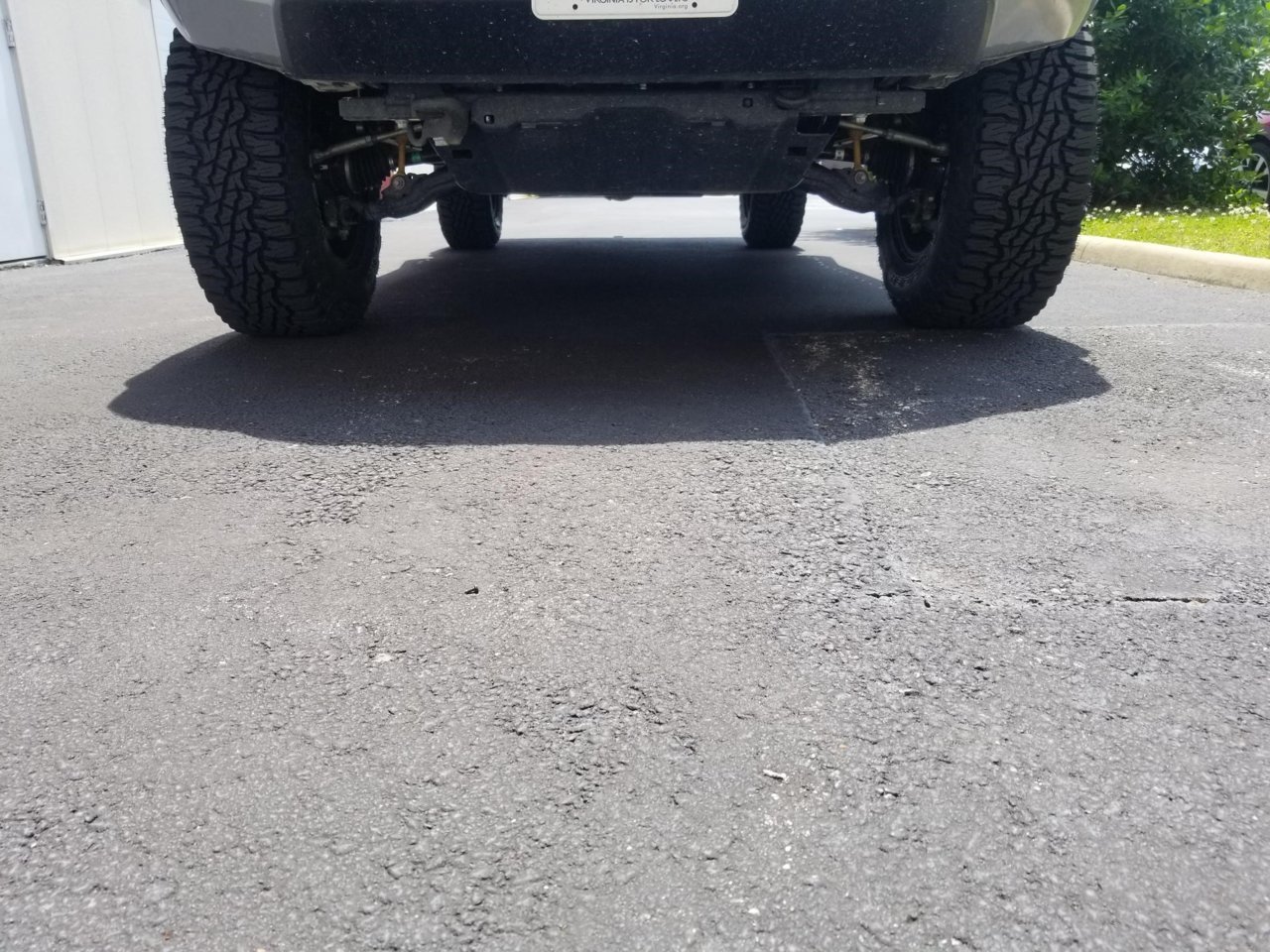

    Got the SCS 17x8.5's wrapped in the Wrangler Ultraterrain ATs this morning. Plenty of room with stock UCA...I'll be getting them out and about and provide feedback as the miles rack up!

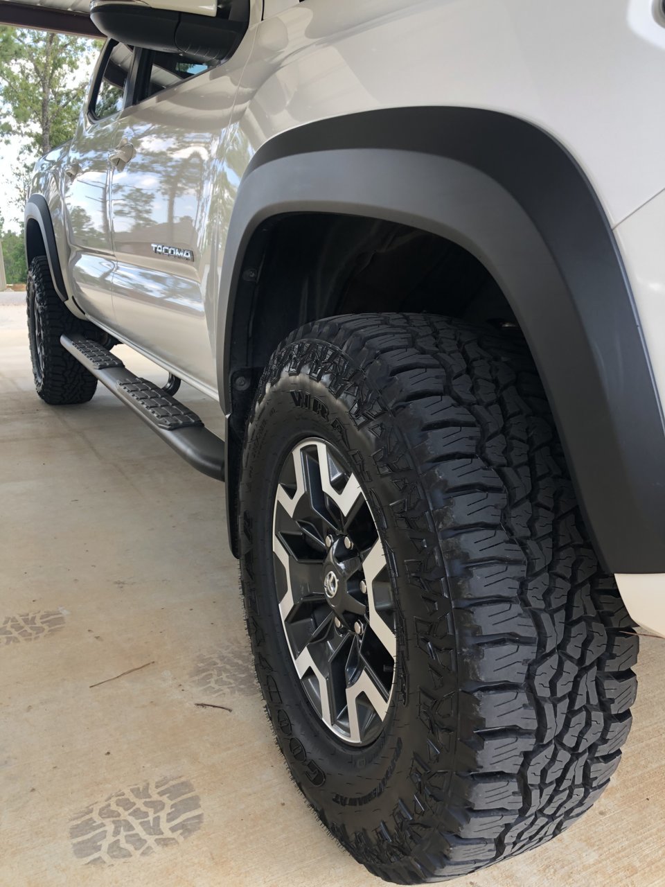

    CC346A3A-515B-4D86-B142-105A9441083F.jpg4EDA01B2-5DAA-47B5-BCED-1819AA5BF806.jpg I’ve had them on for about 400 miles now.
    They are stock size SL.
    Balanced well, not much louder than stock if at all, maybe lost 1 MPG (haven’t checked).
    Doesn’t seem to have made the truck sluggish (disclaimer I use the ECT button ).
    Only dry weather so far, and nothing off road yet......not that I do anything very harsh in the off road department.
    I love the look and I’m pleased with how it all turned out.

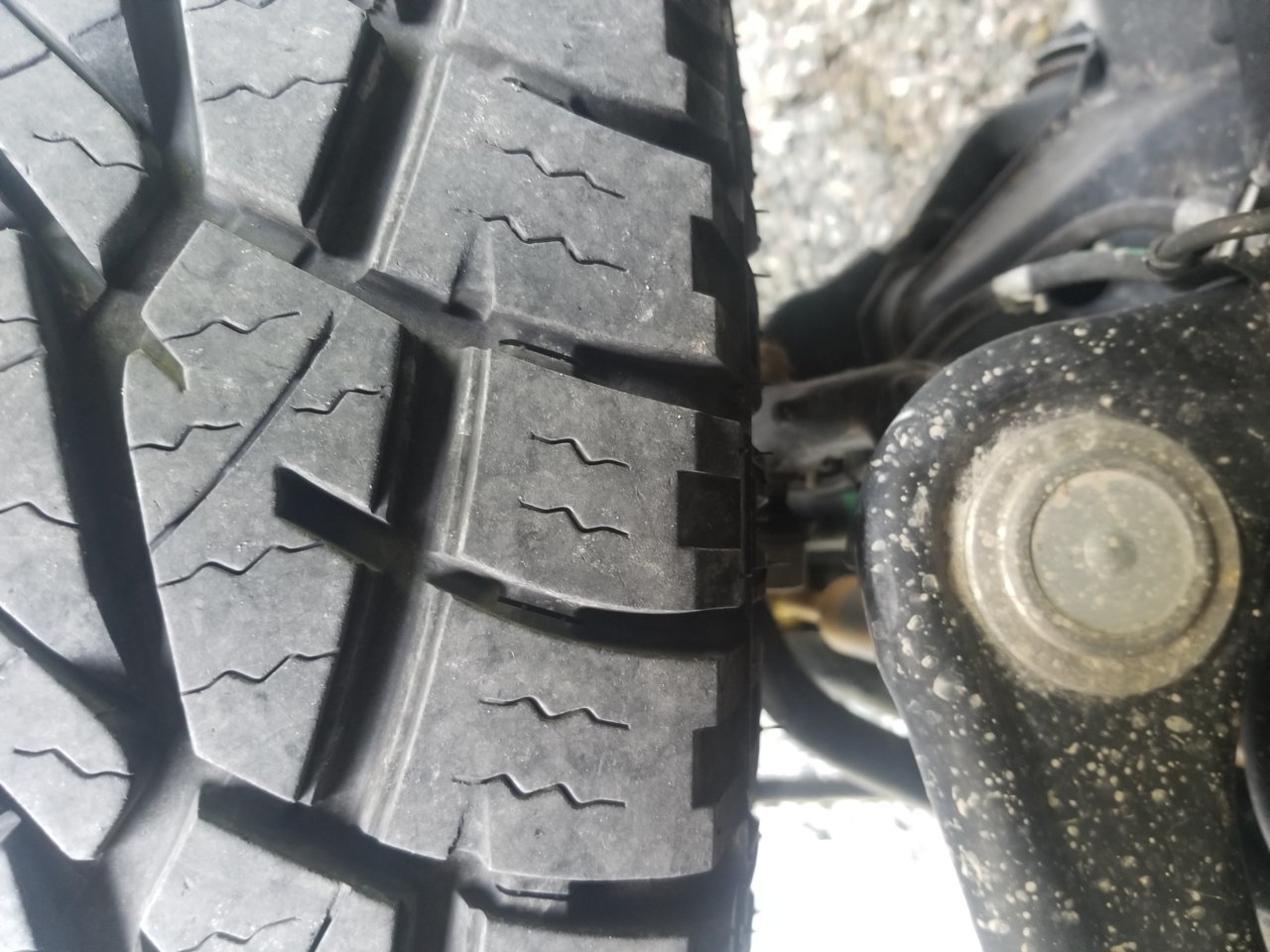

    I have 400 miles on them now (OBX trip over Memorial Holiday Weekend), they're slightly noisier than the 275/60r20 Pro Comp AT Sport's...and granted going to the SCS S6 17x8.5 wheel saved me ~54lbs over the 20x9 wheels, I also appeared to shed 2lbs for each tire (not counting the difference in replacing the spare with S6 and 285/70r17 in OEM spare spot)...but I've gone from averaging ~18.9 to nearly 20.1 mpg (actually averaged 21.16mpg on the OBX round trip).
    Spare fits, but has the slightest gap between the exhaust heat shield and the spare up under the bed...but eventually plan on chopping back the exhaust, so that might not be "an issue" further down the road.
    No off road driving (aside from our private rutted out gravel road and my mostly dirt and weed riddled backyard, dropping wood off for splitting), no wet weather experience to-date, but then again I just got them put on last Thursday 23 May 2019.
    Plenty of UCA space with the 285/70 on a 17x8.5 w/ 4.30 backspace and -10mm offset.scs 285-70r17 front-end  road view work shot.jpg UCA w_Ultraterrain 5-27.jpg

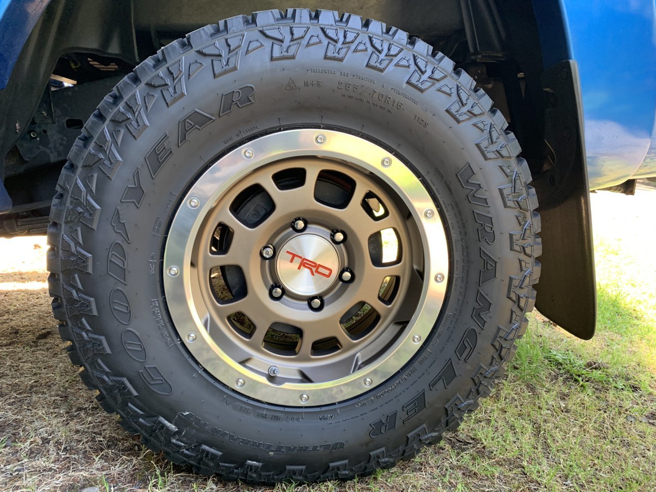

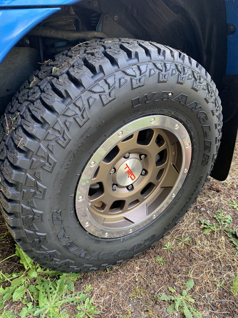

    Up close
