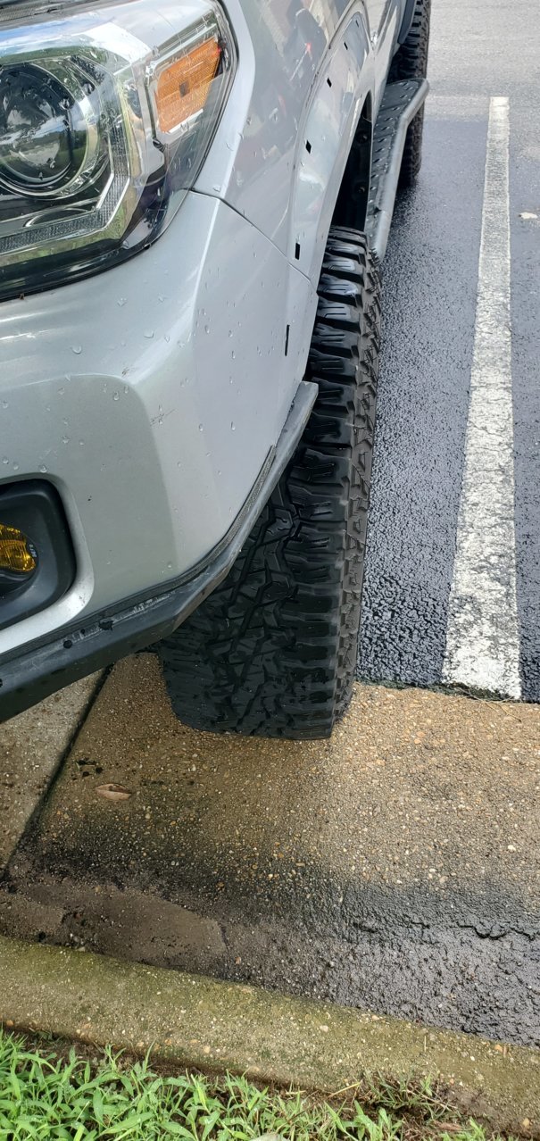

    That's a good deal for a set of 5! I don't regret spending the extra cash on the full size 5th.
    Basically truck came from dealer with 275/60r20 (32.99") front 1.5" spacer up front and 1" block in rear. Went with SCS Stealth 6s for weight savings and 17s give a pretty wide range of sizes.
    I moved down to the 285/70r17 (32.71") and only had minor plastic trimming in the front end. Here's what it looked like after installing with the above spacer lift on the stock OR suspension.20190528_165408.jpg

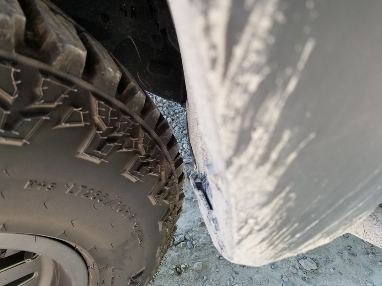

    I did trim both fronts with the 285/70's:
    Then earlier this summer I jumped on a local member parting out/going stock, so I swapped the front bumper for his SSO Slimline + stage 2 (wings), I had to cut even more of the fender liners to avoid them flopping on the wheel while just resting, let alone driving...did it right there after we swap at the members place. I traded my stock front bumper for the SSO slimeline stage 2 bumper which opened up more front wheel well clearance potential.
    Then upgraded my leafs and removed the block, then two months later my Elka suspension arrived and I removed the stock front and rear suspension.20200731_211208_001.jpg
    I know it's a bit of a far cry from your plans, just figured it'd be helpful. The LT has more tread depth, weighs more, but surprisingly less than most similar aligned AT tires (likely due to only 2 sidewalls on these Ultra Terrains). I swapped and saved something like 64lbs just in the 4 wheel/tires on the axle...I think the stock spare swap meant I added 21lbs or so to the bed...but the 17 SCS wheels have to get most of the credit for the weight cutting over those 20s!
    Not a lot of snow down my way, but they did great on sand, dirt and especially on wet roads...we've had quite a few opportunities with interstate speeds and standing water/pooling water standing on highways, too.

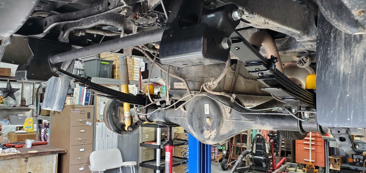

    I went with Dobinsons Heavy Leafs L59-111-R, I have an ARE hardshell plus another ~230# of EDC gear including the 285/70r17 spare in the bed...fyi I was able to fit that size spare in the OE location until I did my Hammer Hangers and added a cross tube.20200524_152132.jpg

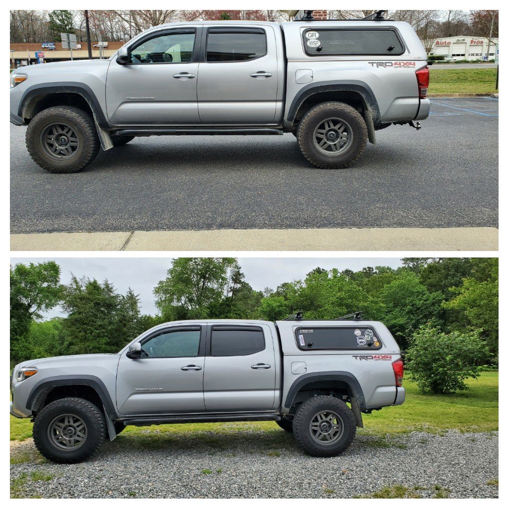

    Here was stock leaf on block lift vs. removing and putting in Dobinsons, I netted 2.75 inches in the rear.

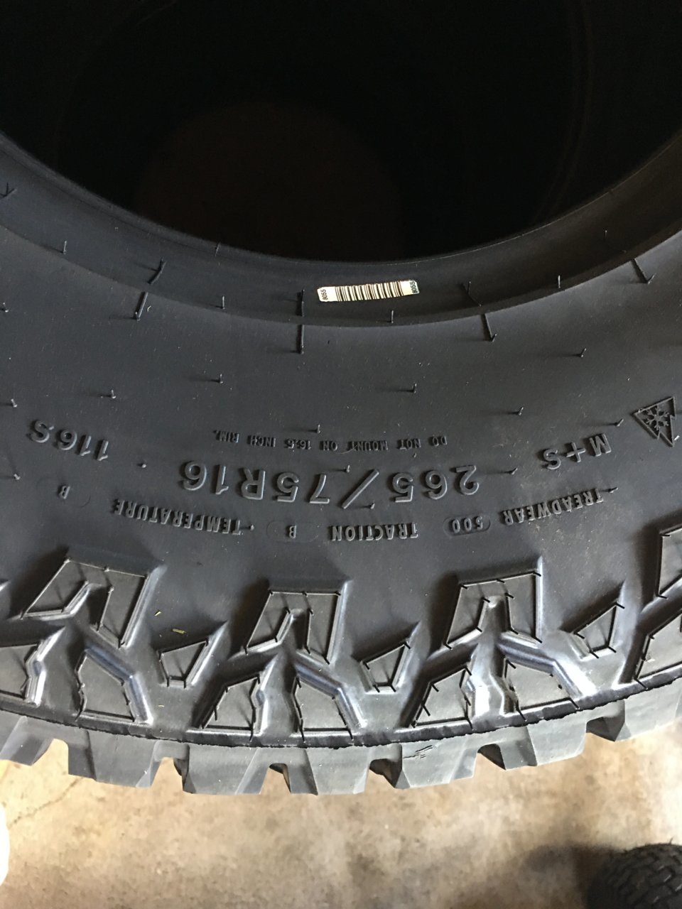

    Big shout out to Matt at Discount Tire Direct. These just arrived and can’t wait to get on the Taco

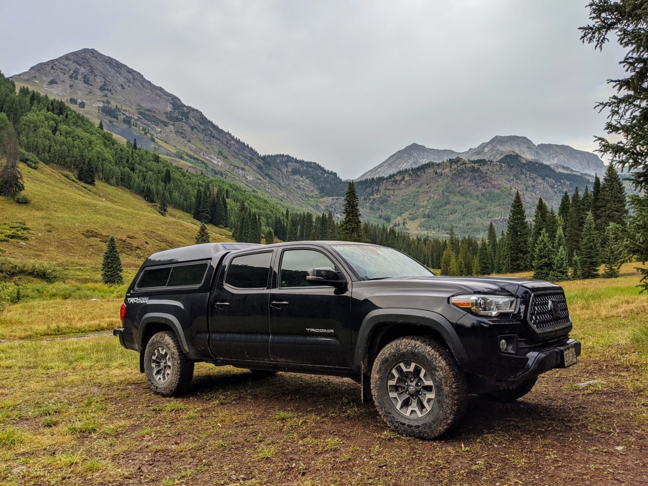

    Even though I really liked my Duratracs, they were WAY too loud on the freeway. Considering that I'm not a big mudder or crawler, I think they were more than what I needed, so I traded them in for some 265/75/16 SL Ultraterrains last weekend.
    Drove out past Crystal Mill to Lead King Basin this weekend, and the Ultraterrains performed like champs! Big sharp rocks, wet slick rocks, to mud and gravel; I was really happy with them. It ended up raining/snowing, and I was worried about their traction on the way out, but zero issues. Depending on their long-term durability, these may be the best all around tire for me.
    IMG_20200828_182633.jpg IMG_20200828_191831.jpg IMG_20200822_185557.jpg IMG_20200822_185543.jpg IMG_20200822_185530.jpg

    ^ nice pics of the beautiful area and of the tires. I should get these loud Authorities off for the same reason but they still have some life. :thumbsup:
