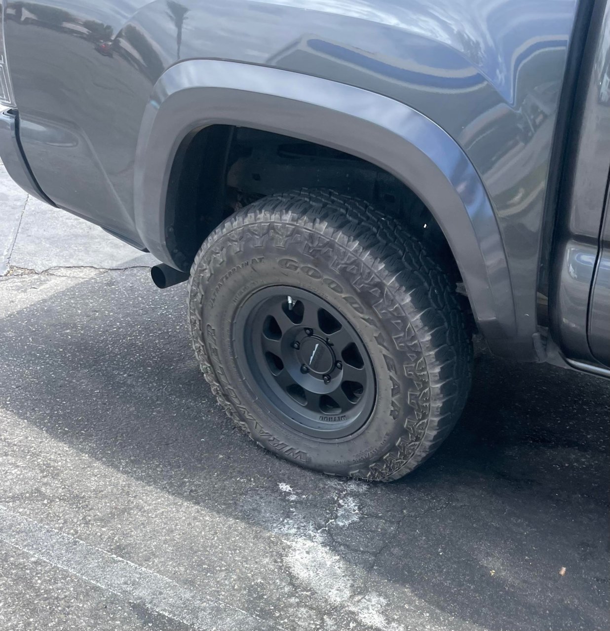

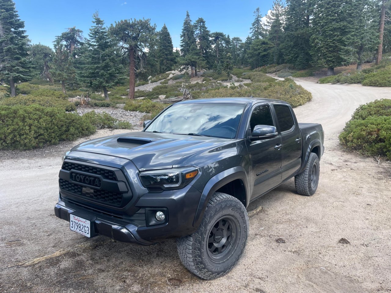

    So unfortunately on Monday, my tire became flat after hitting a trail in Big Bear. The tire was irreparable and had 2 punctures according to the technician I spoke to. Fortunately, I paid for the warranty with Discount Tire.
    This is my 3rd time taking my truck off road since I bought these tires last September, and this tire had just about 7,000 miles on it. These tires are 265/75/16 standard load 116S, wrapped around some Method wheels.
    Now it could be my fault to an extent. I chose not to air down this time around because the trail was labeled as "Easy" on Alltrails, and it was only 11 miles. The trail was basically dirt with some small rocky areas. The other times, I always aired down.
    After the trail was done, I hung out in the village for about 2 hours until heading down the mountain. It wasn't until I was nearly to the bottom that I noticed my rear passenger tire was at 25psi (normally at 34). I pulled over to take my compressor out and filled it to 33 psi, but it still dropped another 3 psi over the next 20 miles home. The next day, completely flat at 2 psi.
    It's a bit concerning that this tire was damaged on such an easy trail, even without me airing down. I had originally got the E load rating of these tires put on, but switched to SL to save some MPG, which I did (about 2-3mpg).
    I just wanted to write this up to give my experience. If you are heavy on the trails, I might suggest either airing down every time like I should have, and possibly consider just getting the E load of these since they'll probably hold up better.

    You prolly just had some bad luck. I ran SL Duratracs that supposedly have weak sidewalls and such, but I never had an issue. Often not lowering my pressure as well. I'm running E now, but only because I haul around a camper. I wouldn't stress too much about it. In fact, just be happy it wasn't a catastrophic fail/puncture.

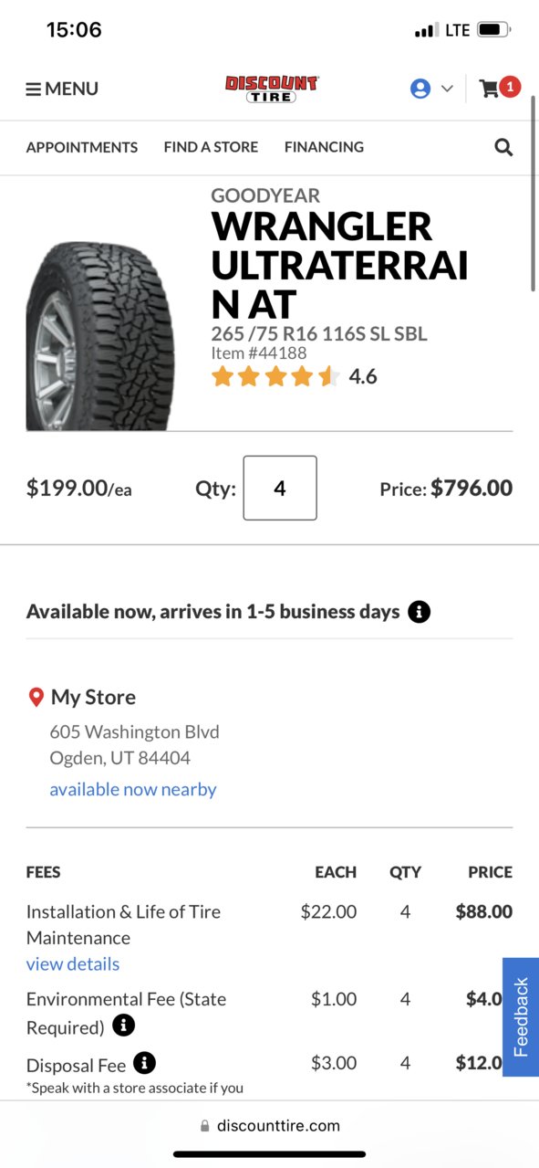

    New to the Tacoma world and will be replacing my stock tires here soon. Stock height 2020 SR5. My question is will discount tire put these on? Great deal with the $110 instant savings and taxes come out to be 800+ with install as well.
    Or should I go 70/r16? Thanks!

    Discount tire will definitely put that size on your Tacoma. If you go up a tire size there will be a measurable, but very slight decrease in fuel economy, maybe 1mpg. Still, you'll gain about half an inch clearance under the truck. I bought that exact set from discount tire, that's a good deal you're getting.

    Yes, we will absolutely put those on! We would love to earn your business.
    Feel free to reach out to us here if we can be of any assistance.
