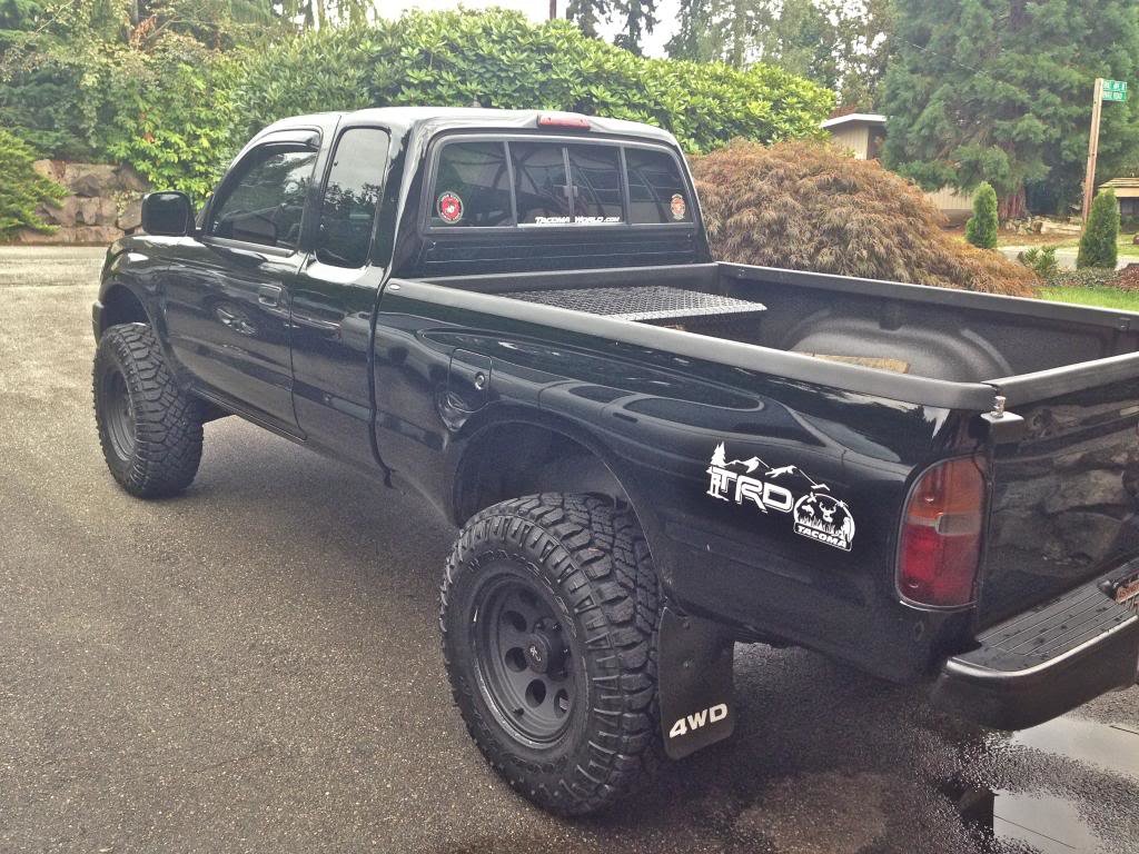

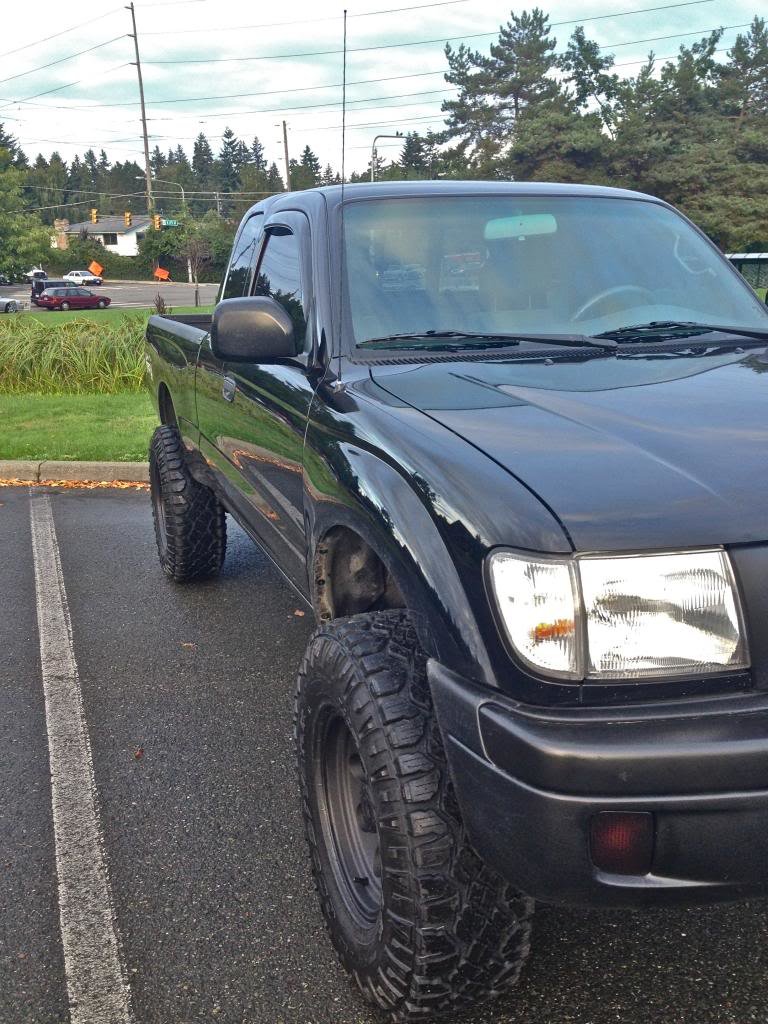

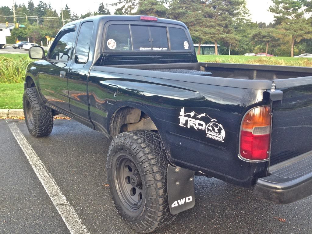

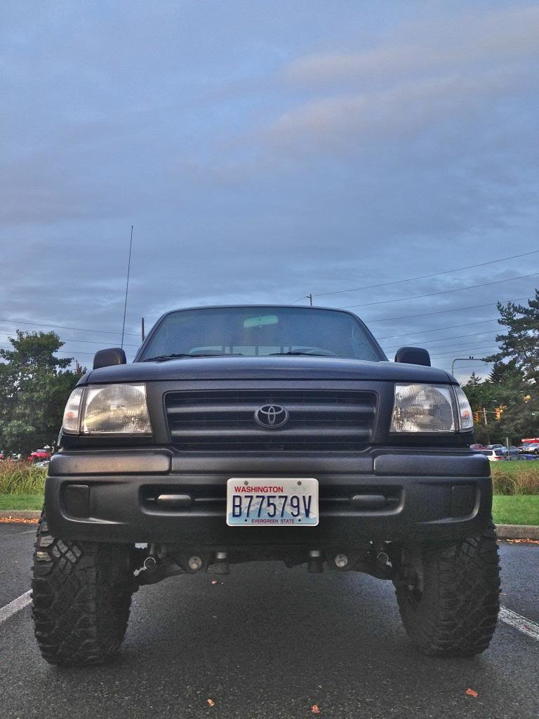

    Not a very helpful opinion in terms of size, however I just got them and love em. The look, the road noise is not as loud as I'd expected (given it's a more aggressive AT tire), snow rated and I heard it's not too bad off road either.
    Here are my 285/75/16s:
