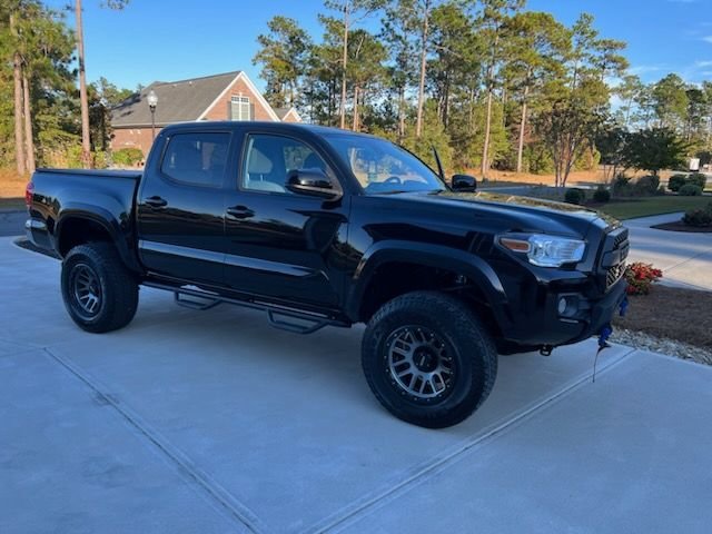

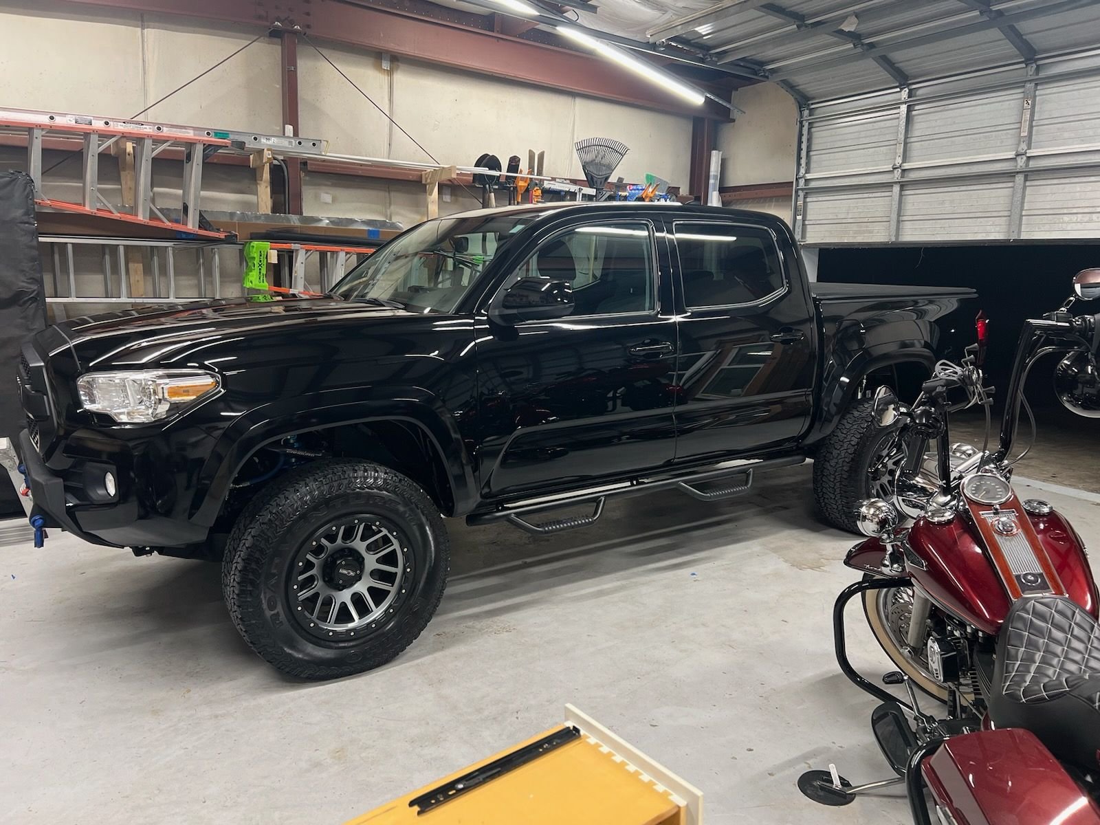

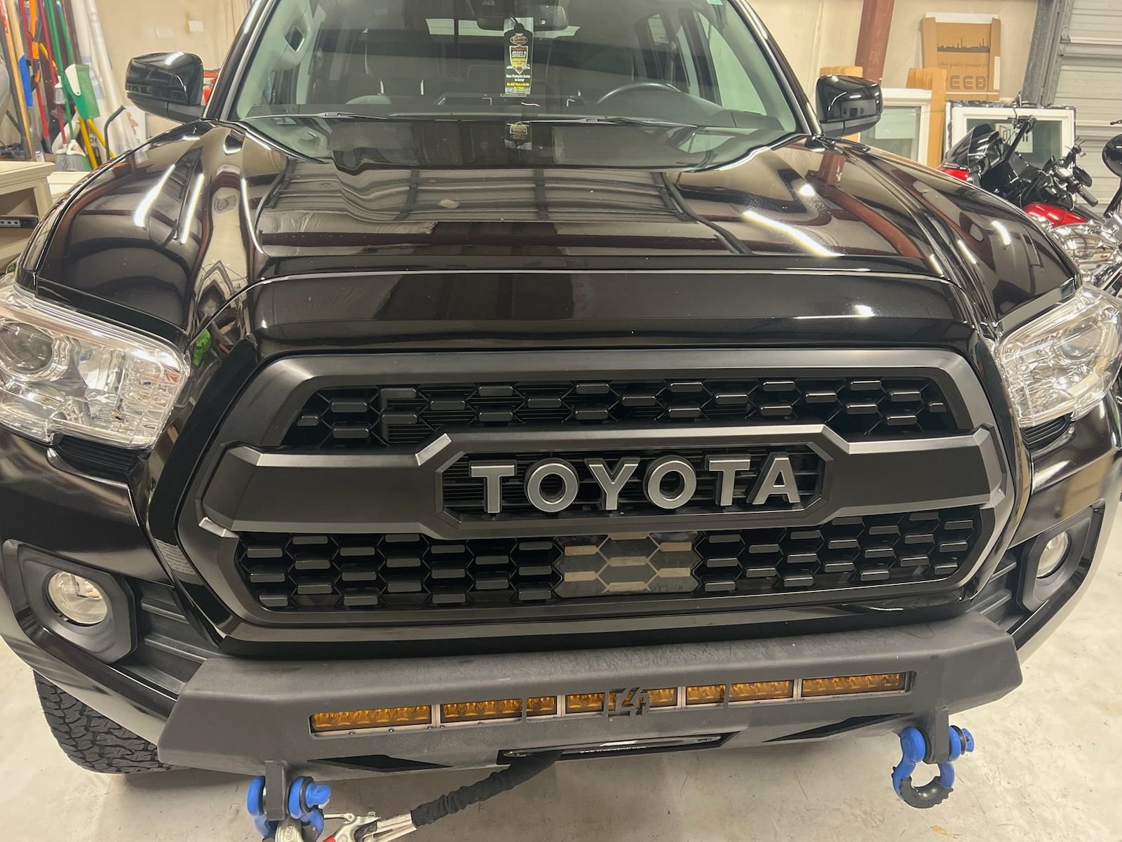

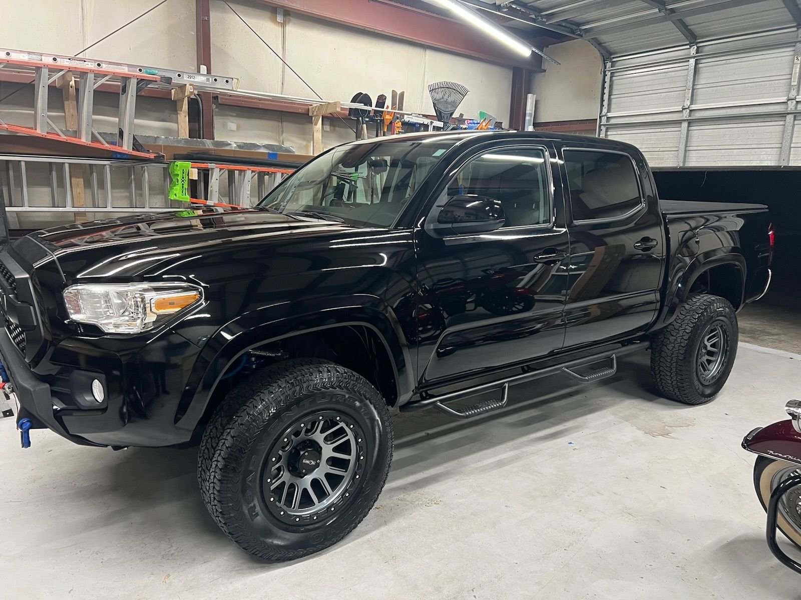

    I recently sold my 2nd Gen and ended up buying a 2019 3rd Gen. Was Stock, now Current Photo Below.

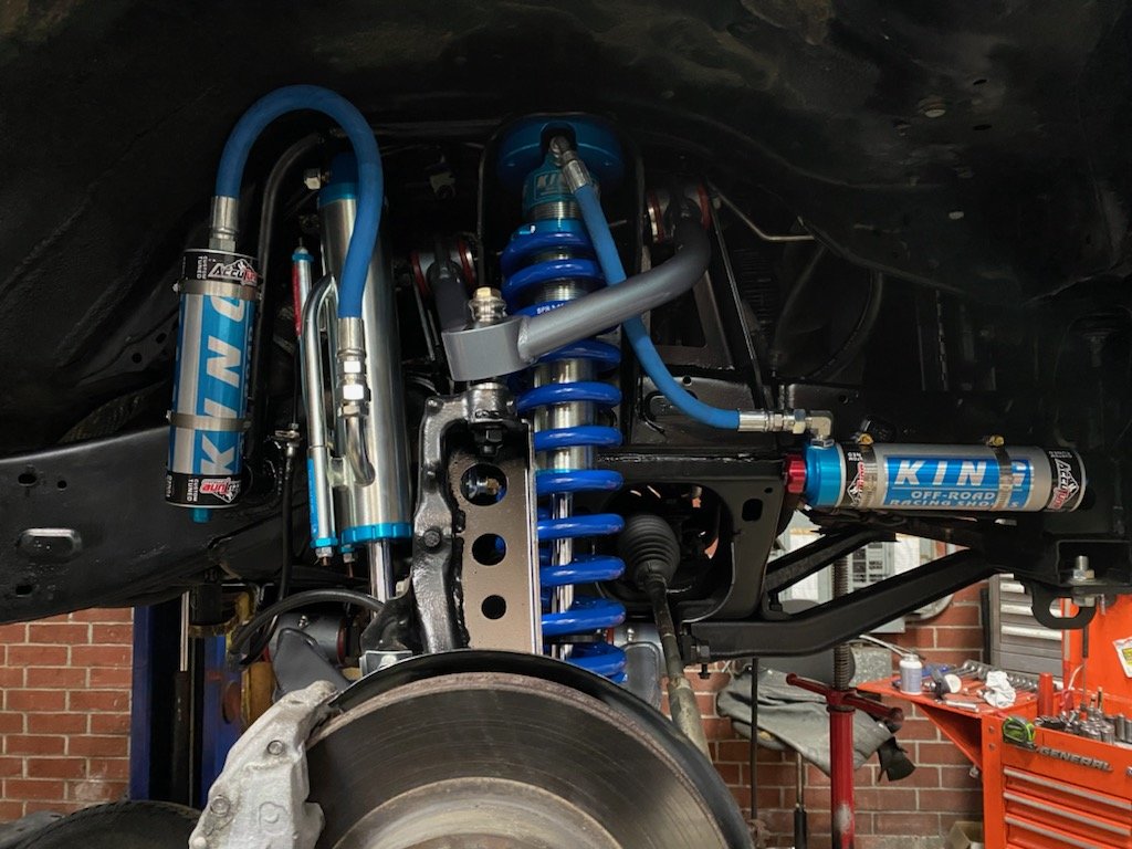

    Low Range 4x4 installed: Total Chaos 2in LT Kit, LT CV Axle Shafts, Weld-on Spindle Gussets, Weld-on Lower Cam Tab Gussets, Weld-on Upper Coil Bucket Gussets, Weld-on Dual Shock Tube, Weld-on Rear Shock Relocation, Hammer Hangers w/ 3.6in Shackle, Hammer Hanger Crossbar, King 2.5 LT Coilovers, King 2.5 Triple Bypass Secondary Shocks, C4 Fab Oversize Tire Fitment Kit, Prinsu Design Roof Rack, 40in Baja Design S8 Light Bar, Switch Pro, as well as Falken MTs on the KMC wheels.

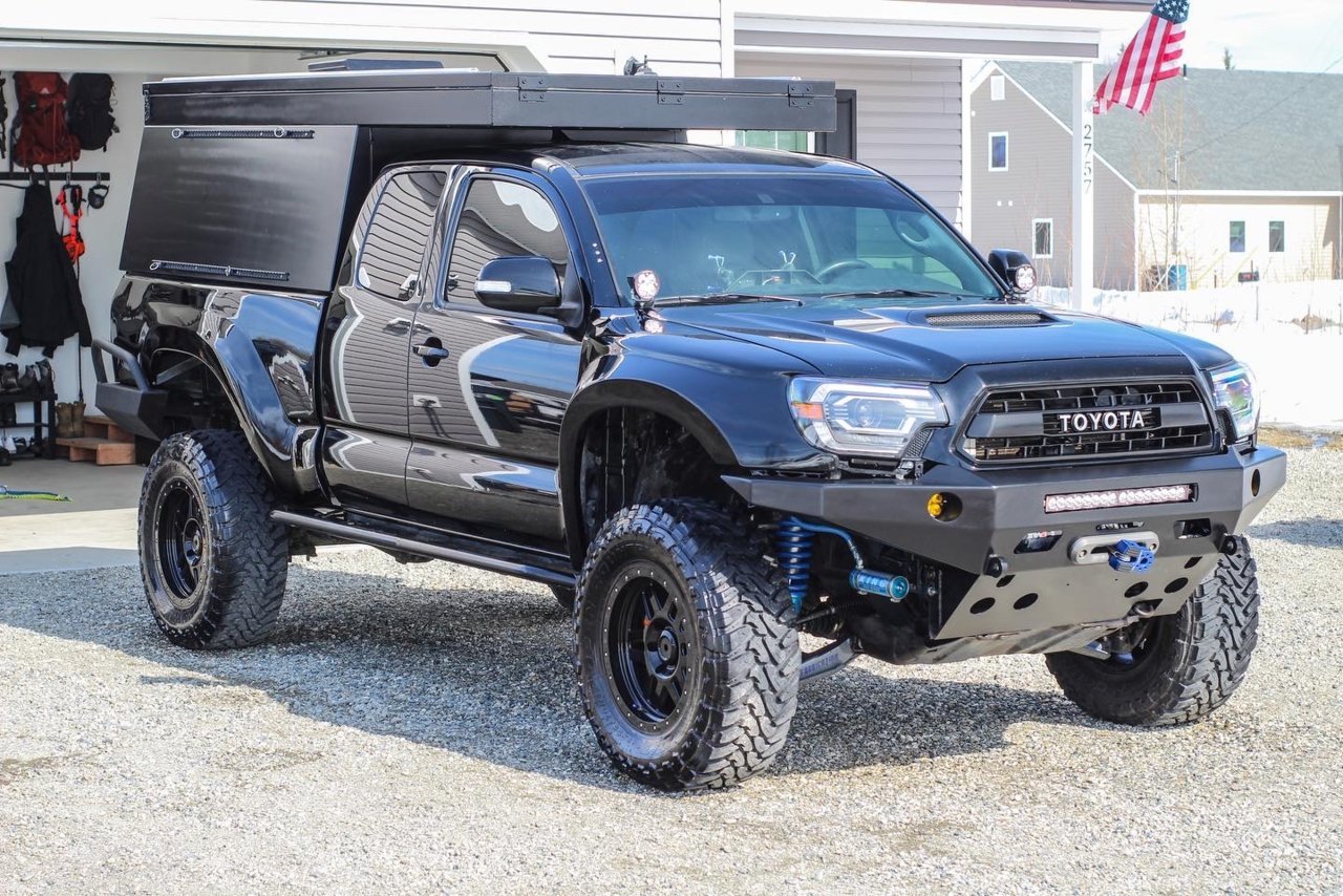

    September 24th, 2023: I will miss this 2012 Tacoma TRD SPORT truck. It is tough seeing it go.

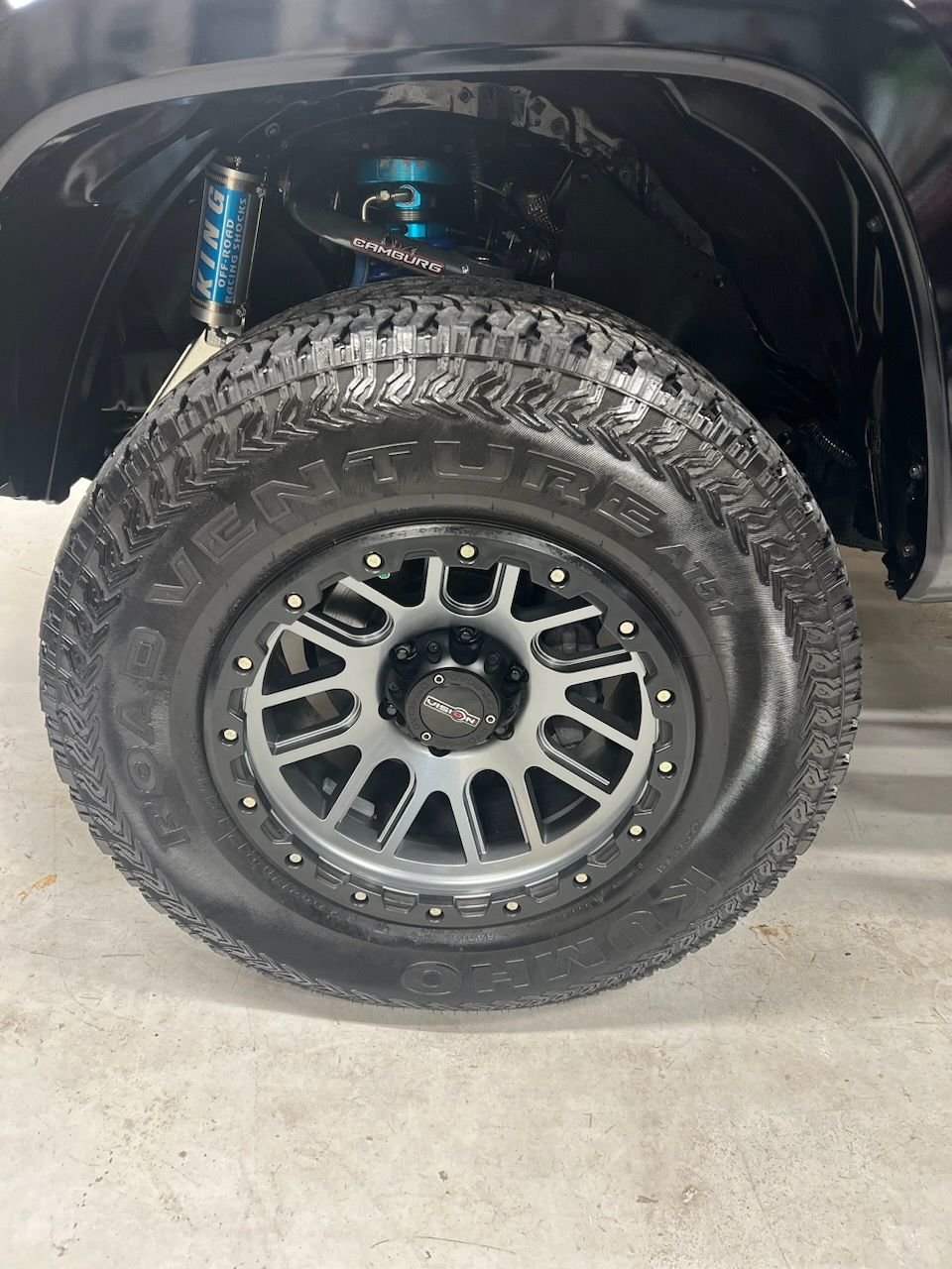

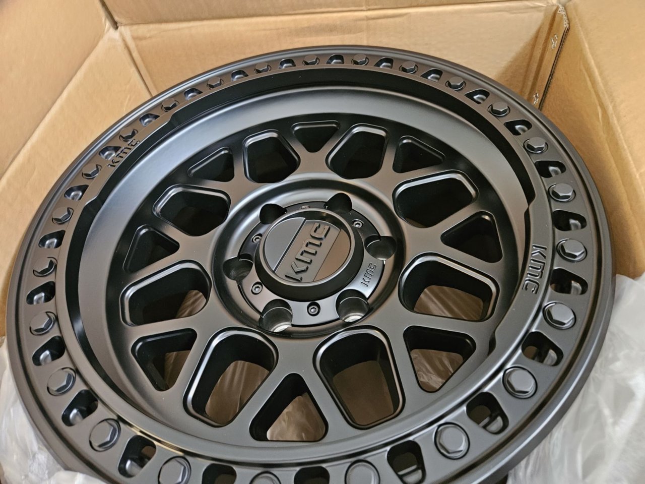

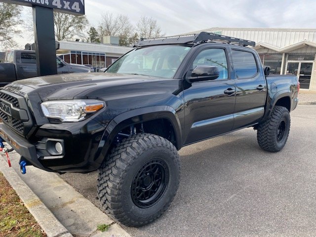

    On a side note though, The KMC KM549 GRS Satin Black 17x9 -12mm Offset came in the mail today.

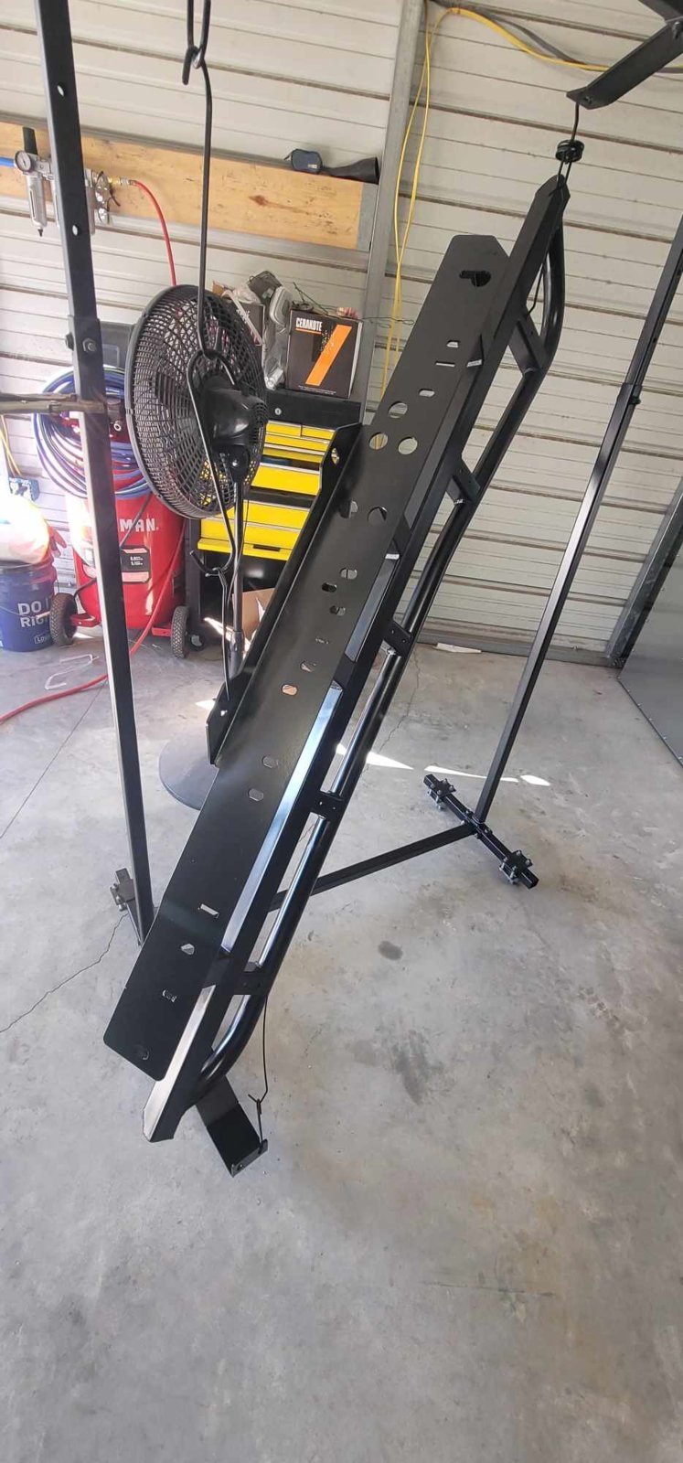

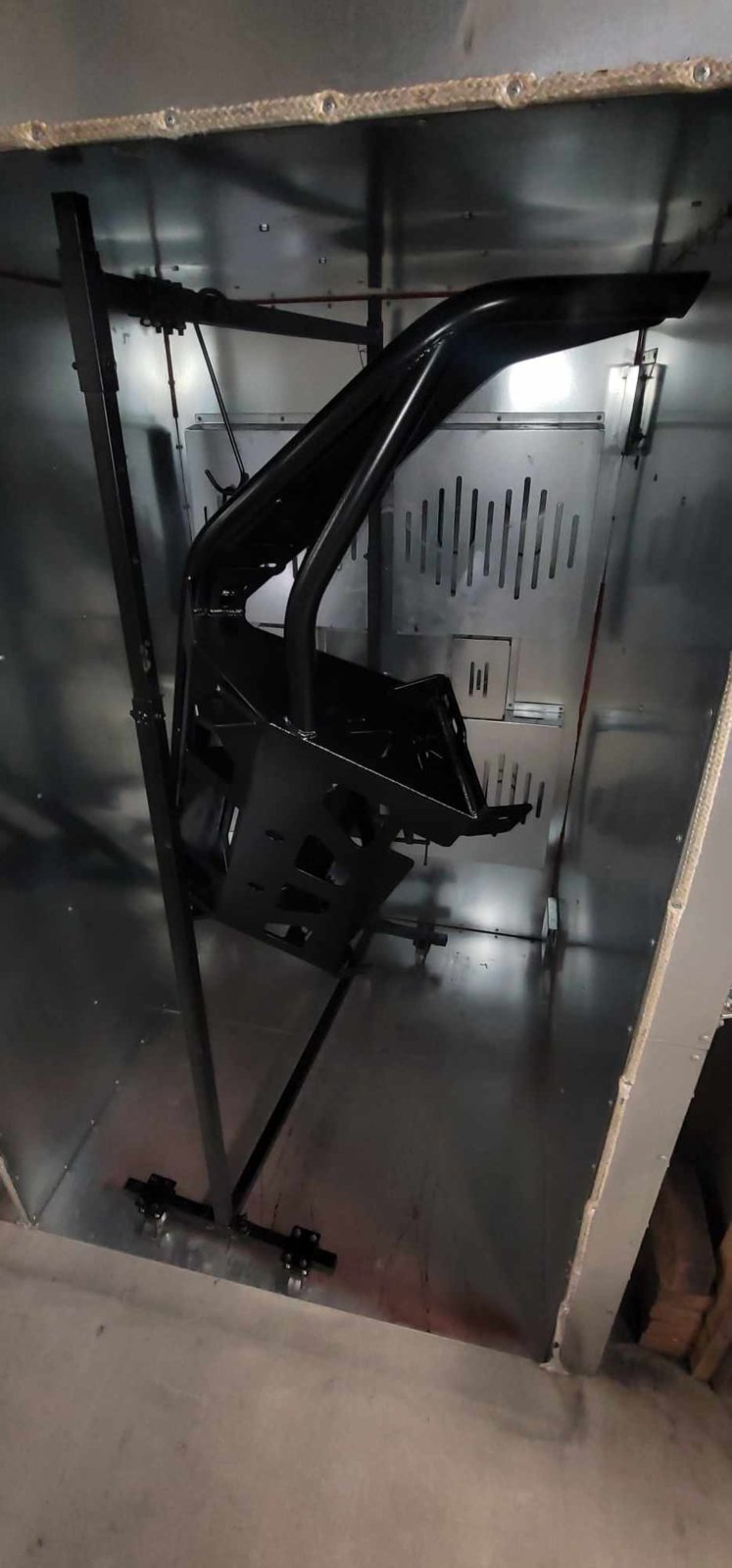

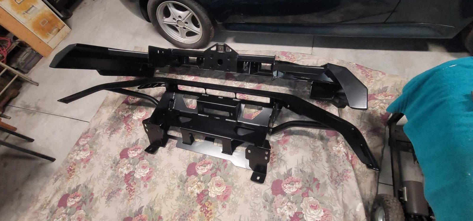

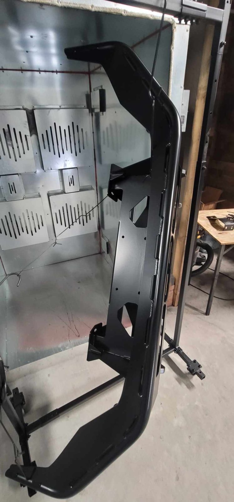

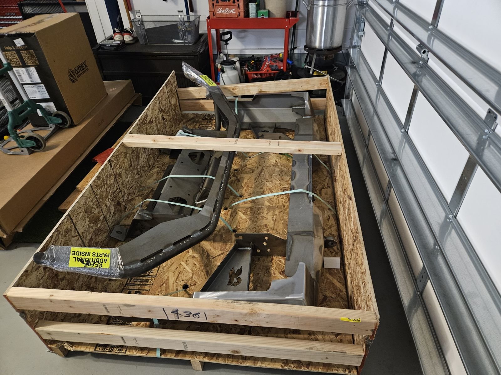

    Relentless Fabrication Bumpers arrived from shipment today. Still awaiting Low Range 4x4 to finish up the Long Travel kit and several other items. With Christmas here, I told him not to rush. Not expecting it back until Jan 1, 2024.

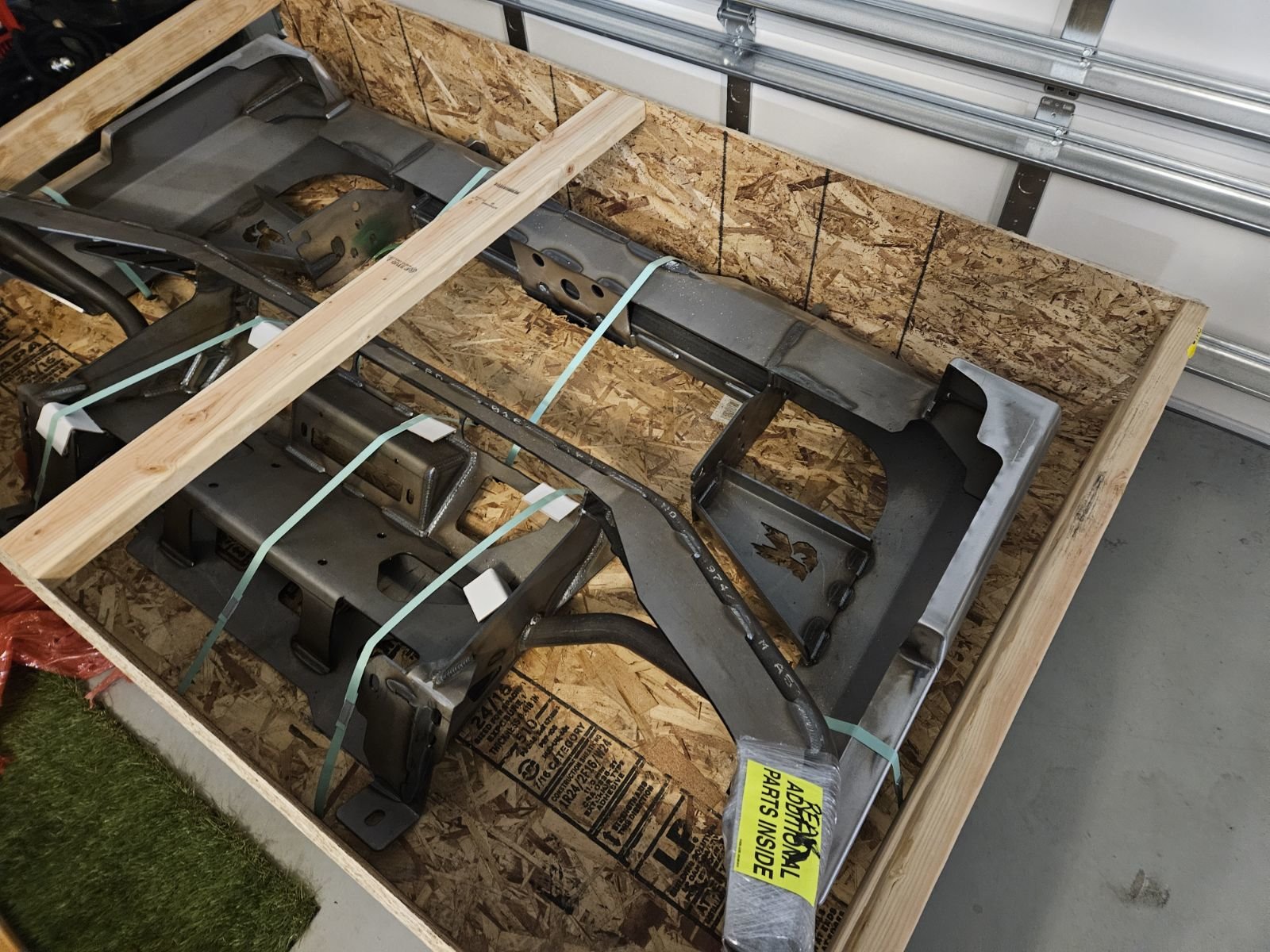

    Come the New Year it will roll out the shop with suspension and several other upgrades. I'll post some photos. Most of the exterior cosmetics will be accomplished upon my return from deployment.

    Update - Dec 31st 2023
    What a year! Today the bumpers and rock sliders were finished being powder coated.
    CygnusX191 likes this.
