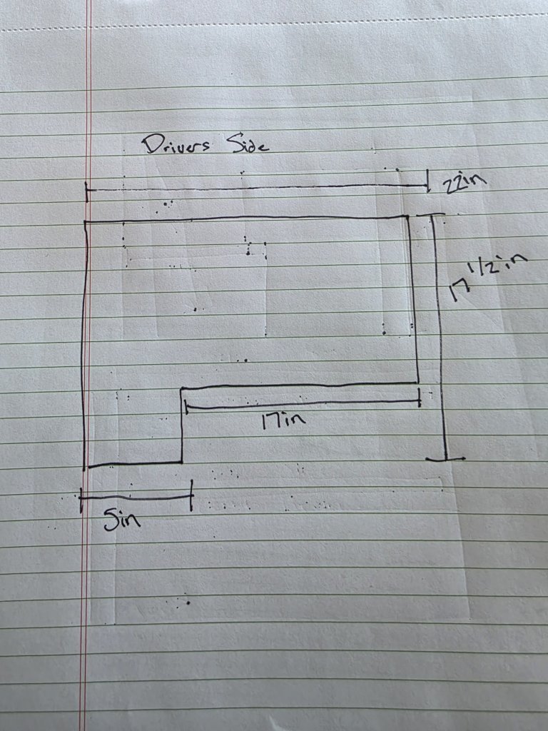

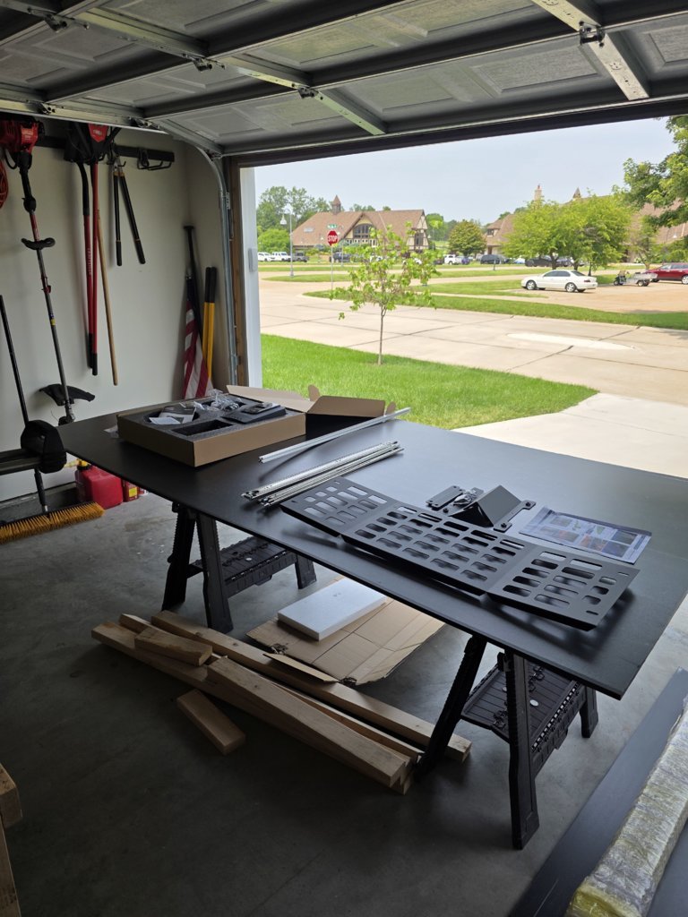

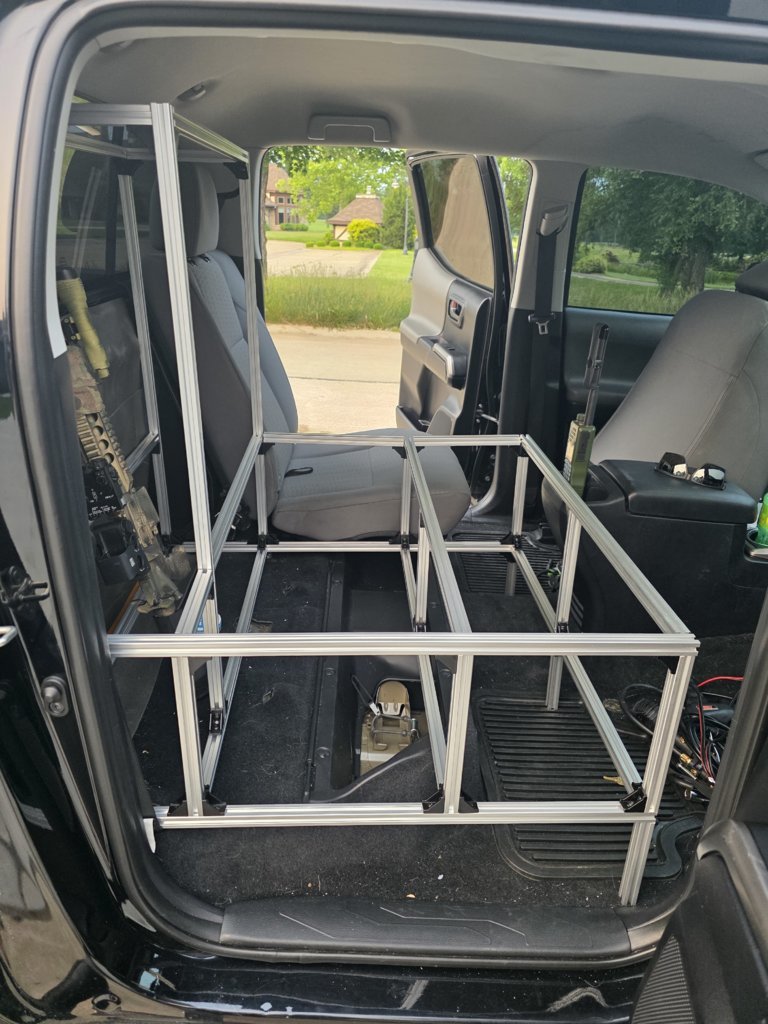

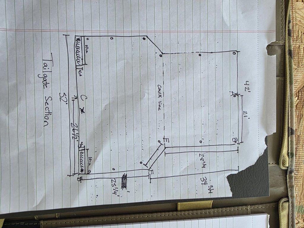

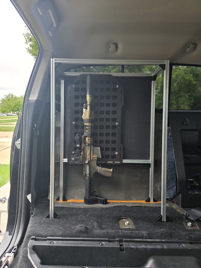

    So as I stated, im going to add the Homemade "Goose Gear" to here as well as start a Thread.

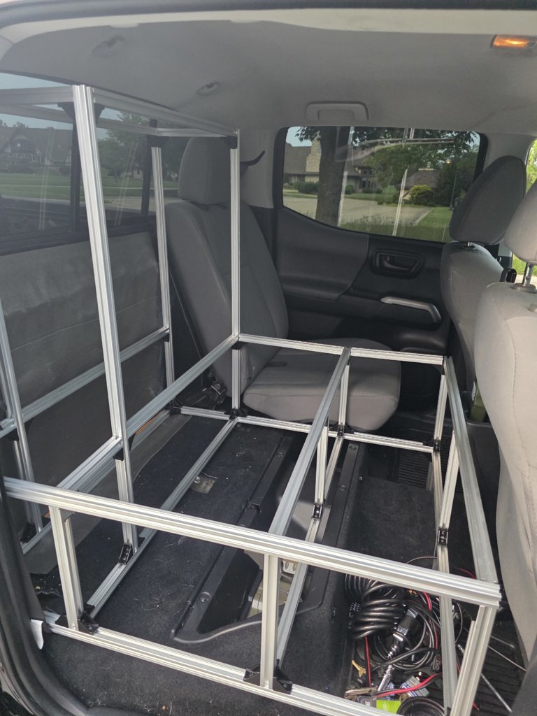

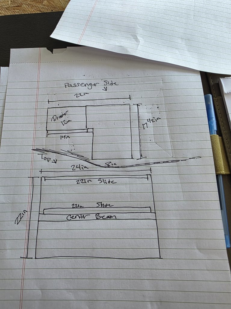

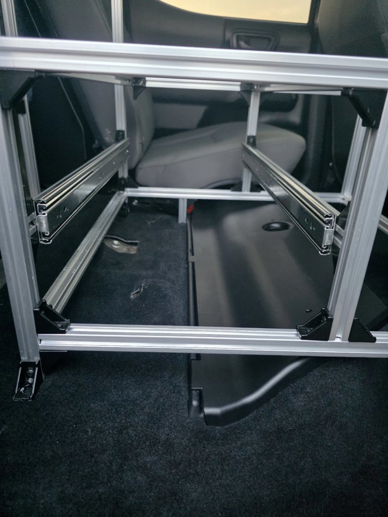

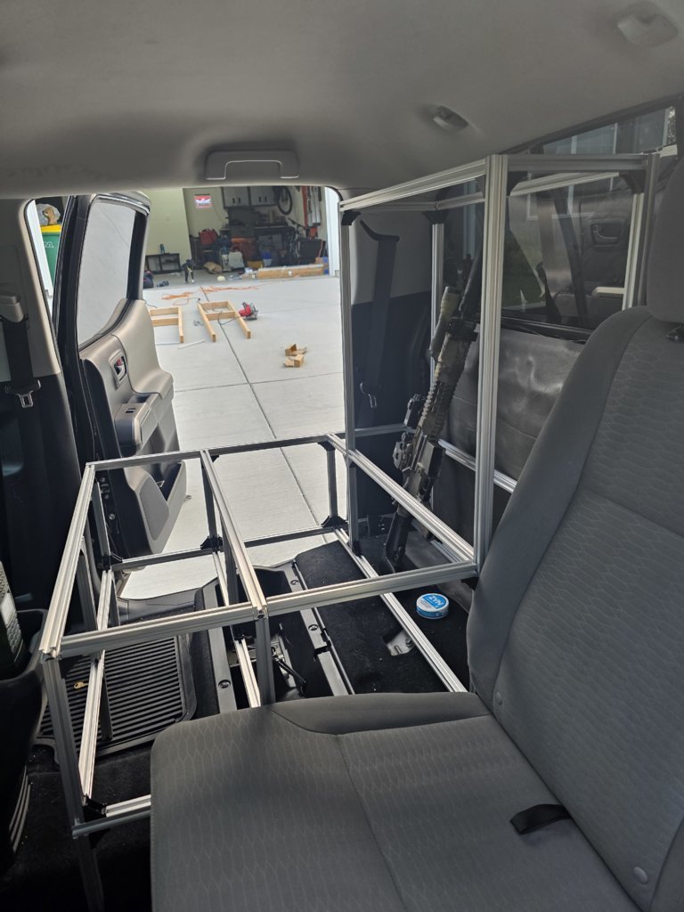

    Today was big work, got all the materials in and started measuring and everything. I was able to finish the frame prior to aluminum frame before I had to call it a night.
    I have some blueprints, ill post if yall want me to. Just on every measurement minus 1 inch. I made a rookie mistake and forgot to account for exterior.

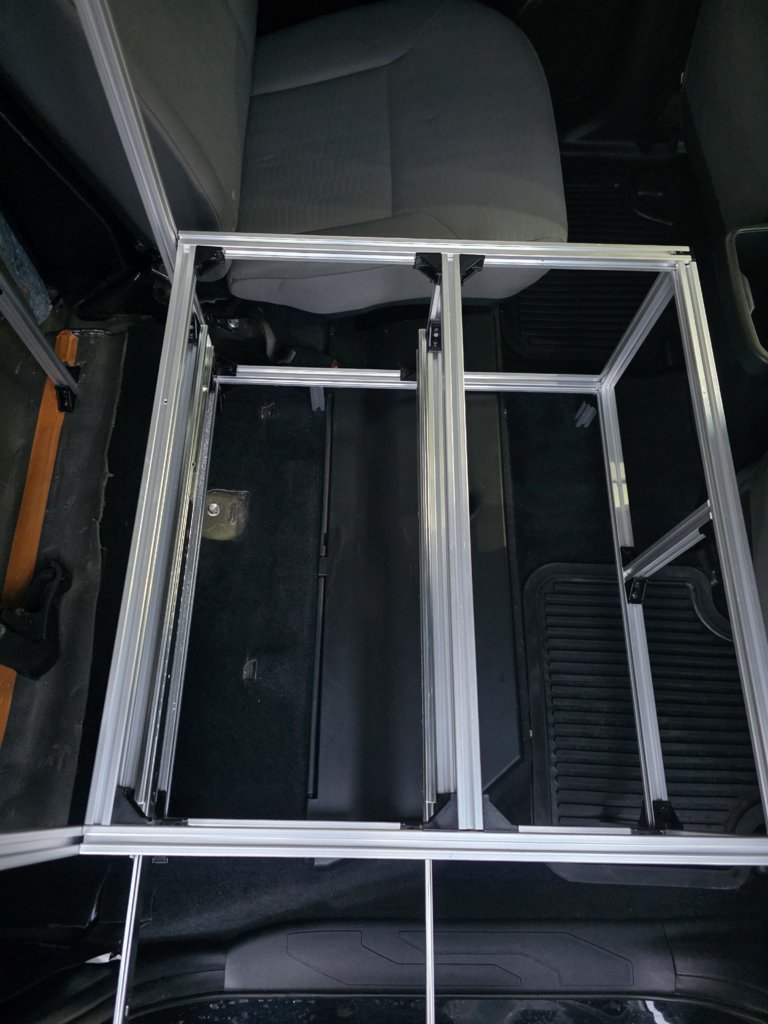

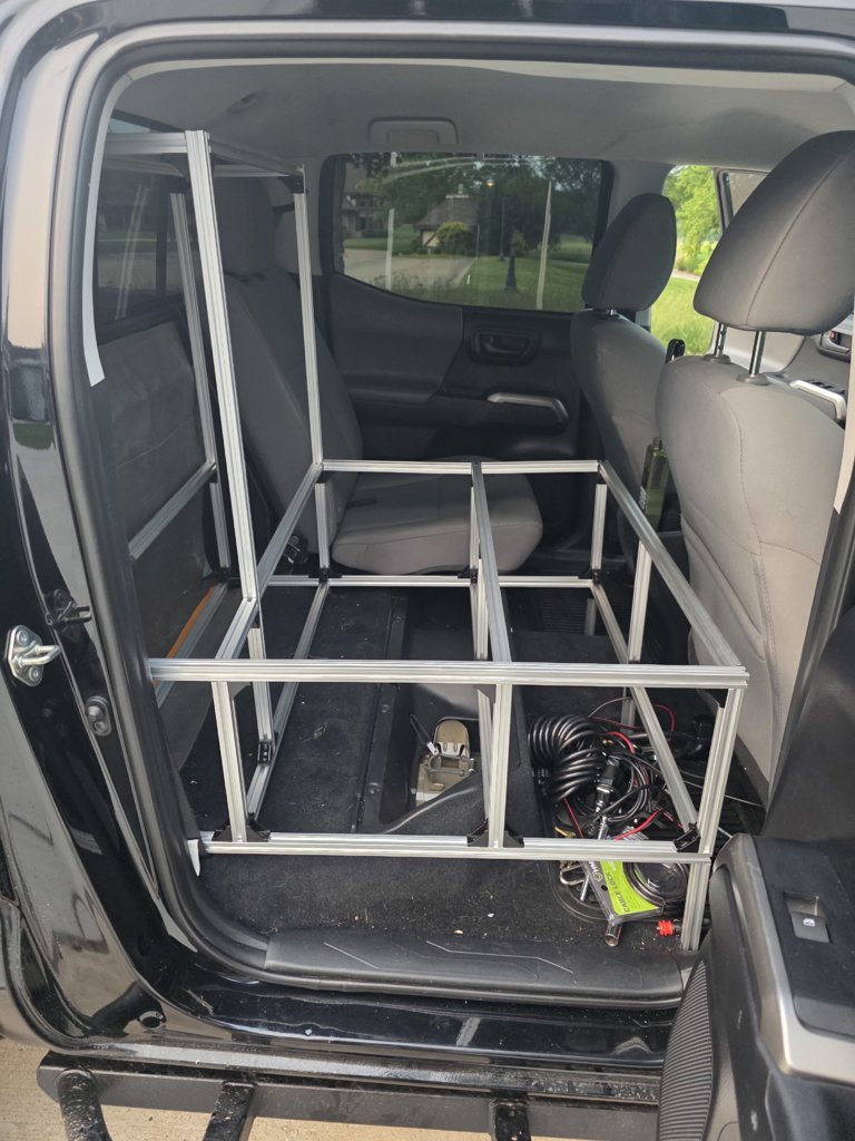

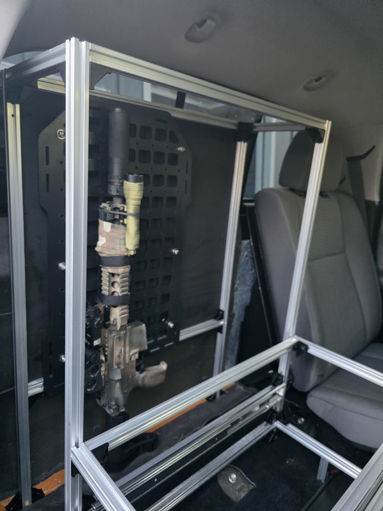

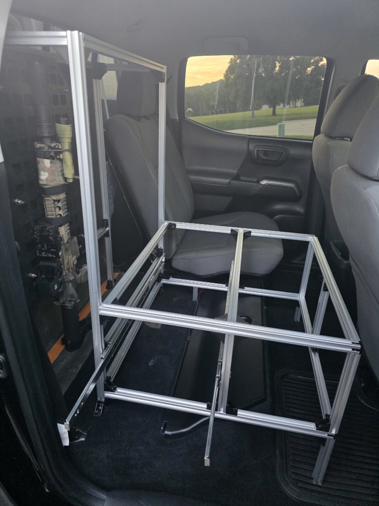

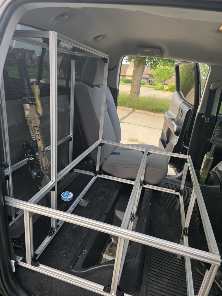

    Ok made some changes, didnt like how tight it was within the cab. So basically redid the whole skeleton. This feels much better. It has been slow though. Because we'll I drilled through my thumb. But within the next couple days I will have it wrapped up.

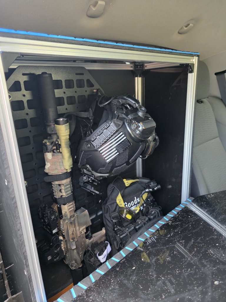

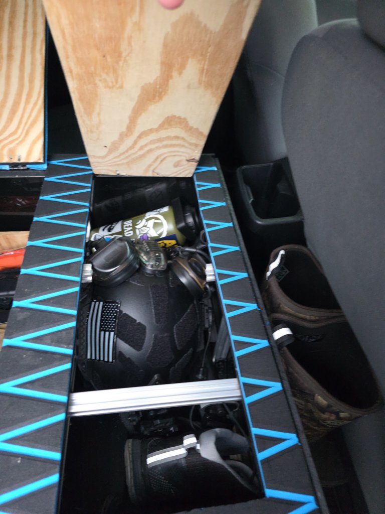

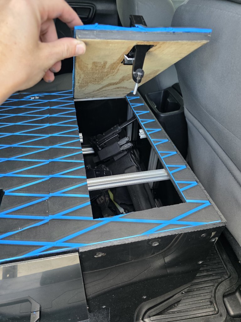

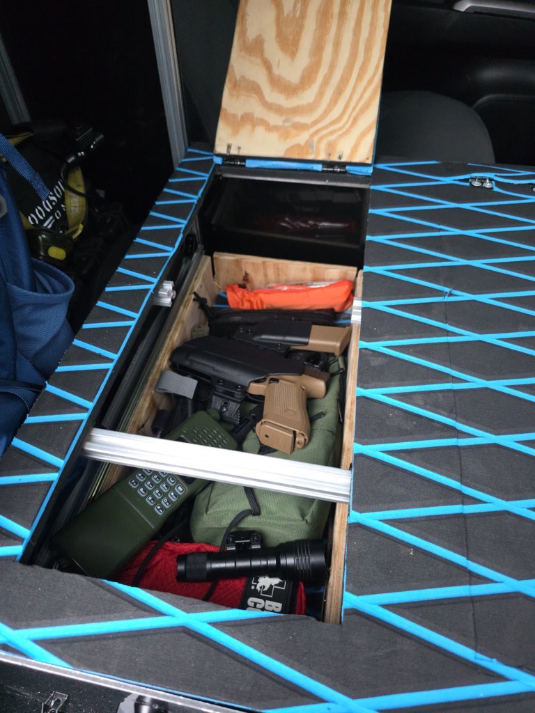

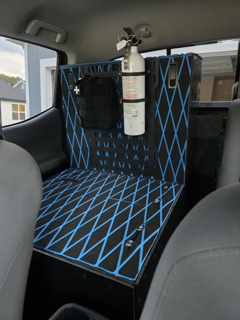

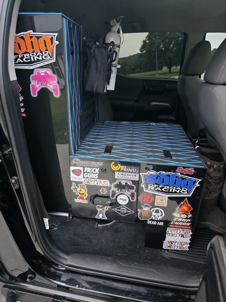

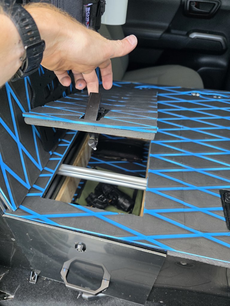

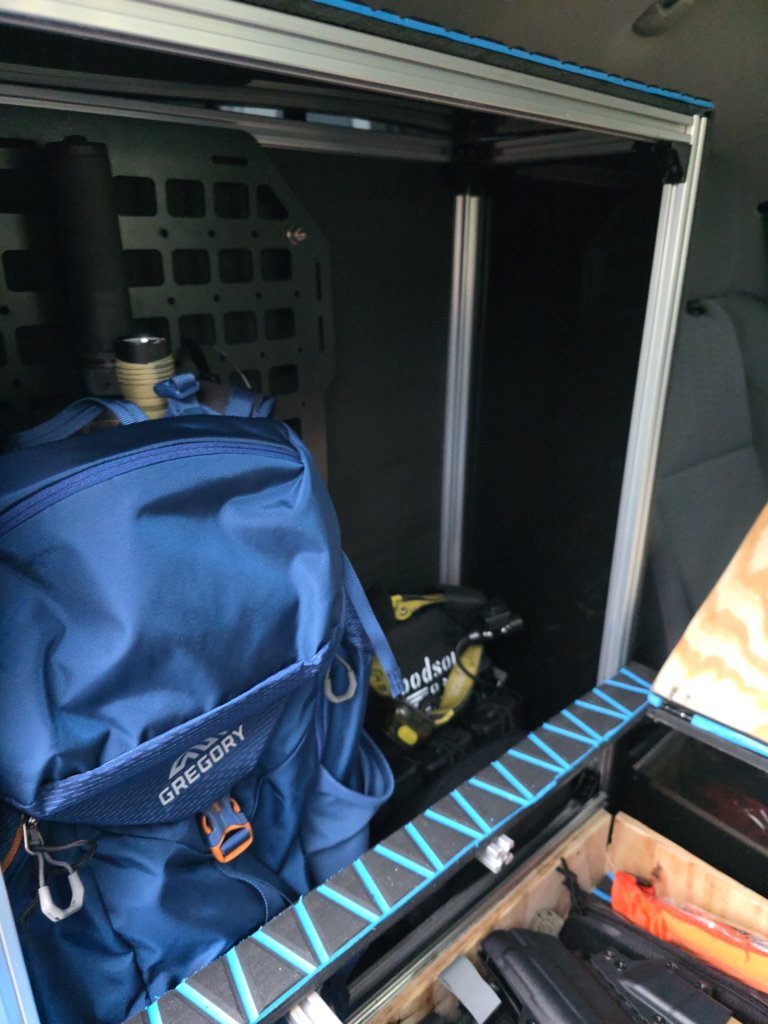

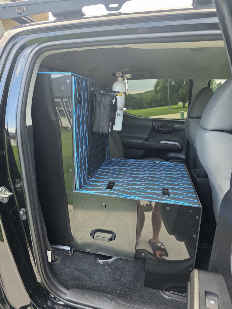

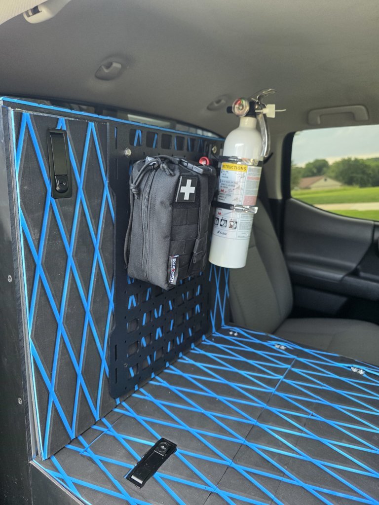

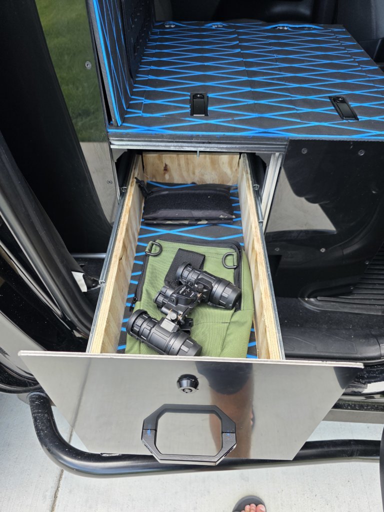

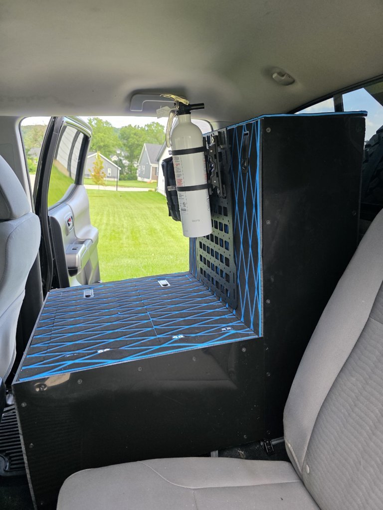

    Well here's the finished product, I do wish the HDPE was Textured black, ill just remember to order it for the rear. I think there's a few little things I could do but really its a solid platform.

    Thanks man, tomorrow, im getting all the pricing, measurements and all for a follow up post. Today was one hell of a day. Had a few sticker laying around. Figured why not. Added some more gear, surprisingly how much gear I can store,to include a 30L backpack.

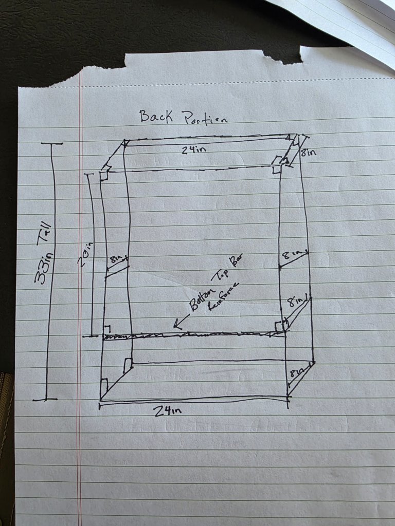

    Ok, Blueprints and Hardware plus Overall Cost.
    I used some pretty professional tool, but it definitely can he done with these tools below, just Measure twice, cut once. Also don't Drill threw your thumb. If it wasnt for VA Healthcare it would have been an even high bill to pay for this project. In addition most of all the hardware can be purchased at lowes or on Amazon.

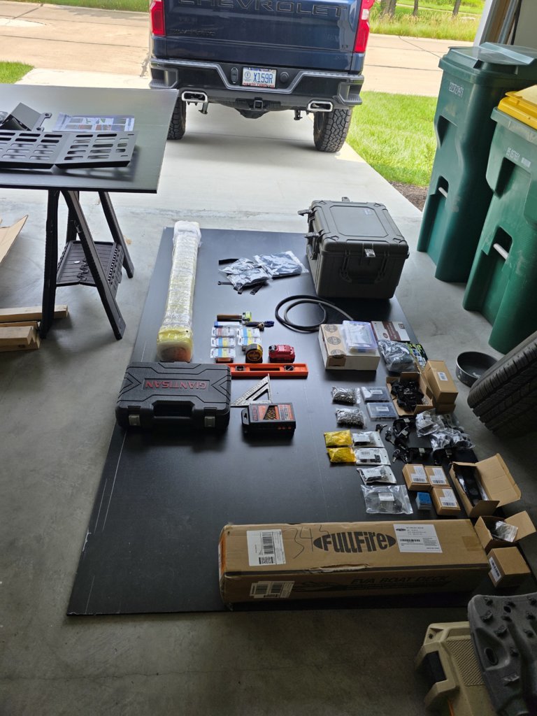

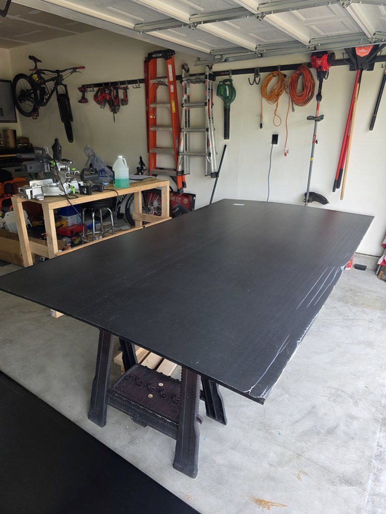

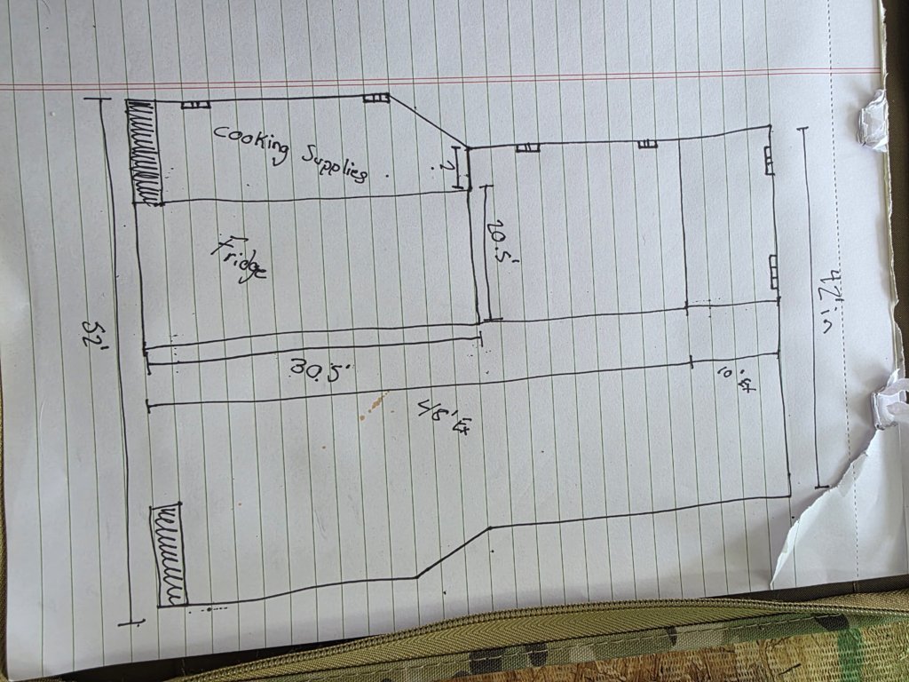

    Moving on to the next project now. I have gathered all the materials and starting to visualize how I want to set it all up.
    This will be for a start a Goose Gear Bed Platorm. I got two 54x96in 1/2 HDPE in textured black for the base. I will attached with rivet nuts, awhile replacing the bed bolts underneath and sealing all cracks and crevices within the bed.
    I will install base aluminum extrusion to the bed platform itself to start as the base for the bed build out.
    Attached I have some rough Blueprints. I wont be starting today as my truck is up at Axleboy getting a new Dual Battery system and recapping of my wiring within my engine bay, so until tomorrow I will just be brainstorming and we'll mapping out this Two Month trip coming up in less than a month.

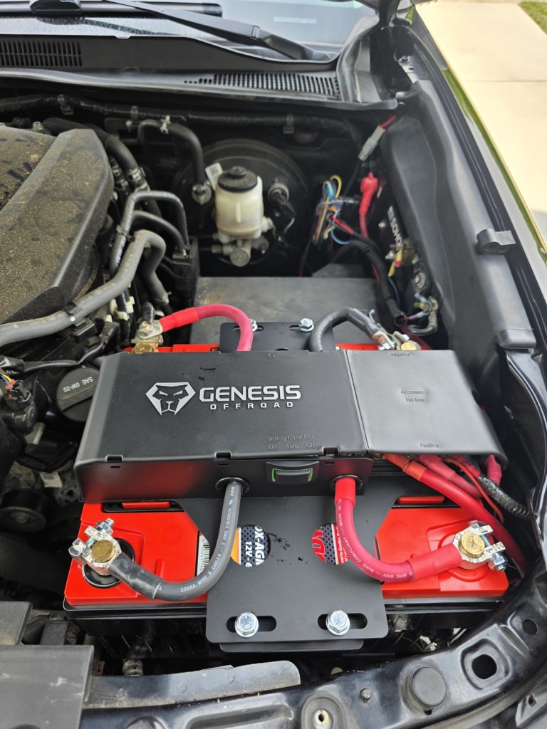

    Axleboys Instslled the dual battery setup, if there is one thing that I wish I could become more proficient at it would be electrical work. Im just always afraid of lighting the truck on fire, I mean Axleboy literally had to rewire my engine bay cause they didnt think it was proper enough. So I think I have a new year's revolution I know abit late, but im going to learn everything I can about wiring and 12v systems.
