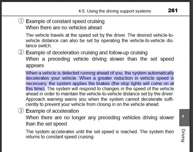

    If it decelerates, then no. If it brakes, then yes.
    Chew and BMH[QUOTED][OP] like this.
