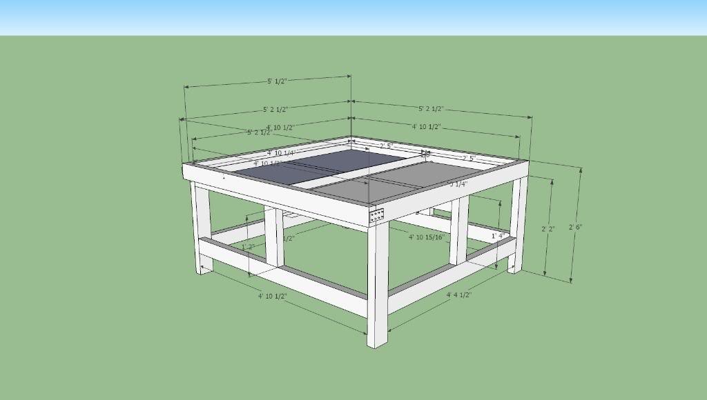

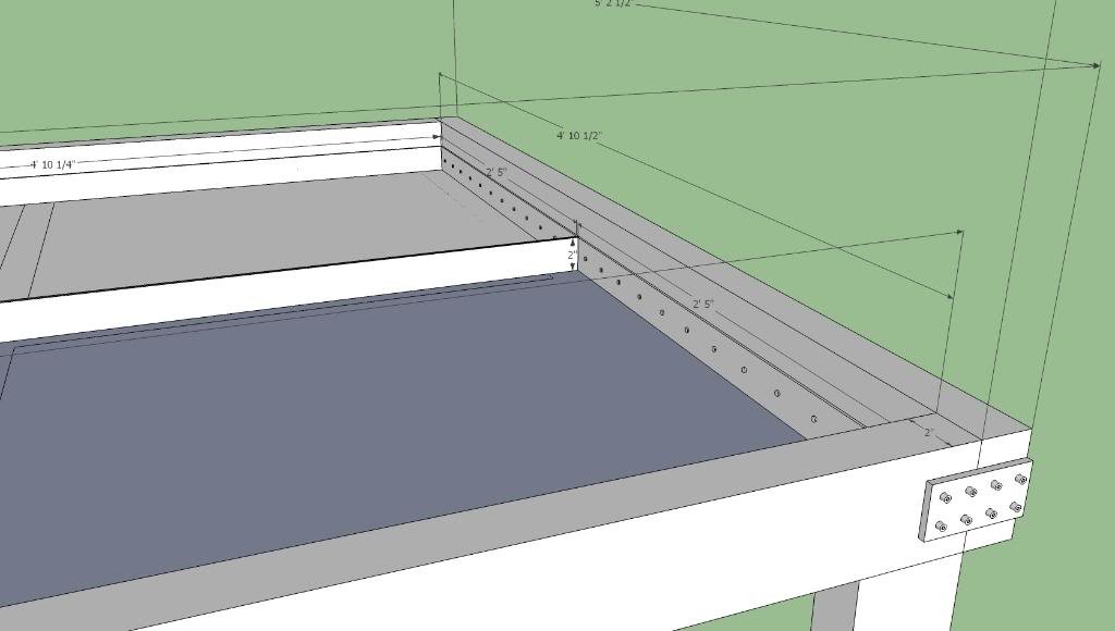

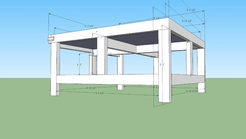

    I honestly use SketchUp a lot. I design just about all my 3D design in SketchUp Pro it's really a great program if you don't want to spend a shit ton of money on SW.
    I made this water table for my TorchMate

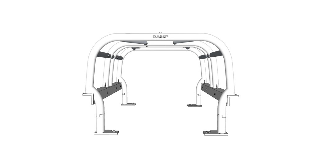

    It's okay for tube work I do most of my tube stuff in bendtech but this was done in SketchUp
    And built

    No I have a 2x4 Table right now and I upgraded my gantry to a 4' so I'm building a new table. I didn't want to spend $2,000 on TotchMate's water table when i can build one for 1/4 of the cost and stronger.

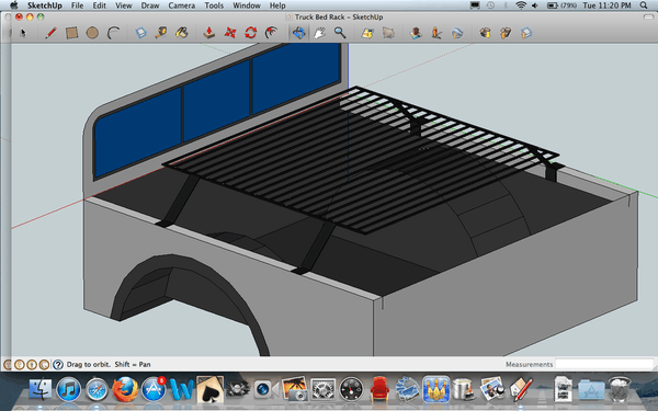

    I just made this sled deck idea to see if it would work with my 6ft bed.
    Not so sure... The swing open doors are right on the edge of the tailgate. I think the deck itself will hang off too far. I just made this to see how it would look.
