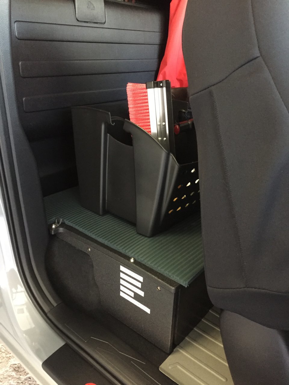

    SW Michigan
    23’ T4R
    I have an access cab with the Goose Gear set up. Seats go all the way back with a little to spare 1”+-. Without stuff on the deck seats fully recline.97394ED2-58AF-4C02-B307-49EB793B2751.jpg
    doublethebass[QUOTED] likes this.
