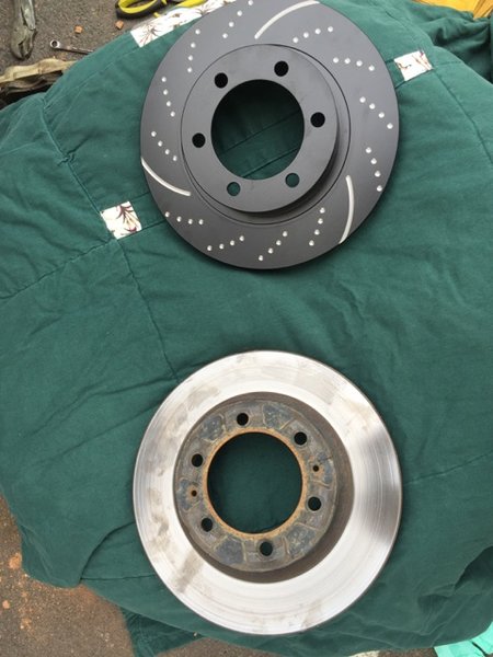

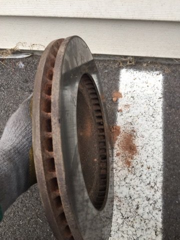

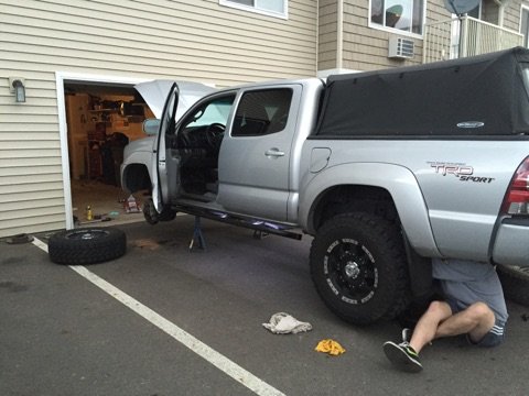

    Well it was a busy weekend:

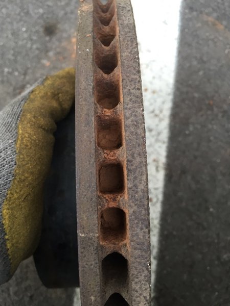

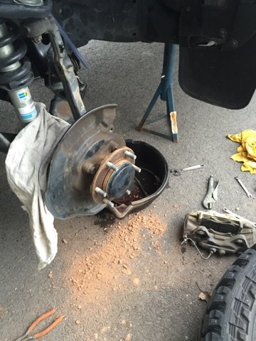

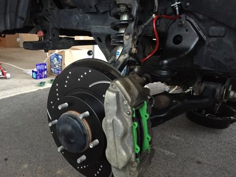

    Regarding the truck-> the previous brake pads and rotors werent very good at 34k miles, the drums had mud and rocks baked through them, which is how it was when i got it at 19k miles.
    So i swapped in some EBC dimpled and slotted rotors and green stuff pads. Also I did the extended steel braided brake lines since i wanted to upgrade all that i could plus now i dont have to worry about them and if i lift any higher i have the lines for it. Also most people recommended the flare nut wrench for taking off the lines, I went and got the only set they had which had a ratcheting mechanism in them. They were dog shit and just started to strip the nut. So i soaked the nuts in penetrating oil and uses a 10mm metric box wrench and my kung fu grip which worked on all of them and did not strip them. Also did a full bleed of the system and now it stops a hell of a lot better.

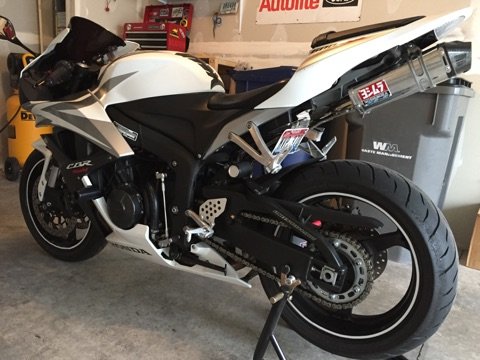

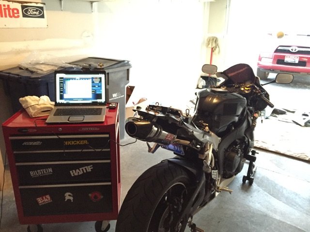

    Lastly for now an update on the 600rr, Finally the cold weather and frost is upon us and the snow is coming, I dropped in a BMC race air filter and loaded up the tune on my power commander 3, got it all installed and tuned. Then took it for a ride and man what a difference, smooth throttle and much snappier roll, washed it and put it to bed for the winter.
