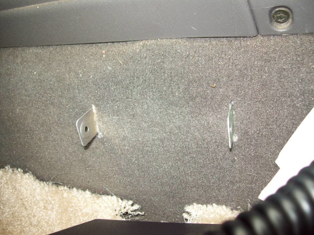

    to mount it i just cut slits in the carpet and foam with a blade and slid the little mounting plate underneath the carpet with the two prongs sticking out. the mic just sits right between the drivers seat and the center console completely out of the way. i think i can dig up some pictures if you are interested in looking at that method

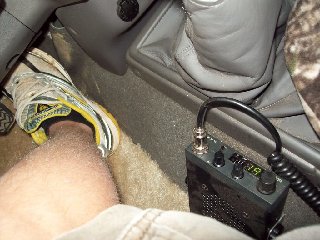

    here it is from the top. plenty of clearance for both the seat and my legs

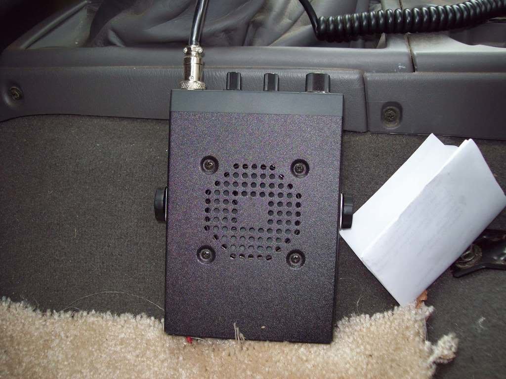

    and from the front

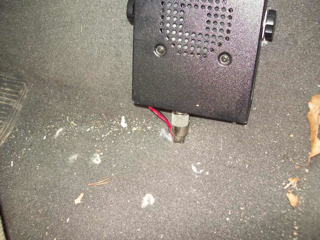

    and here is how i ran the cable under the carpet
    and finally here is the mounting plate and how i stuck it under the foam/carpet. no need to drill any holes. i have never had it move on or offroad

    That's pretty good spot. I have a brake controller mounted already so I was just trying to maximize my leg space, but this spot lookout if the way pretty well.
