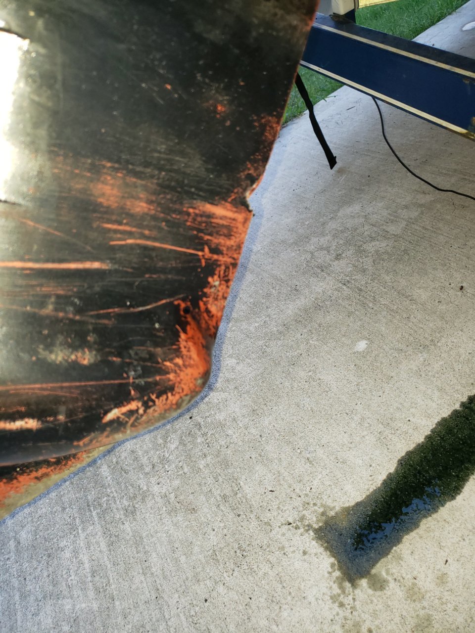

    Question... What would cause this leak? It literally just started today.
    *Edit*. Appears I don't have an alpha 1 as I have a hook on the top cap... So half the parts I bought probably won't work lol... Oops. I think this means I have an R drive?

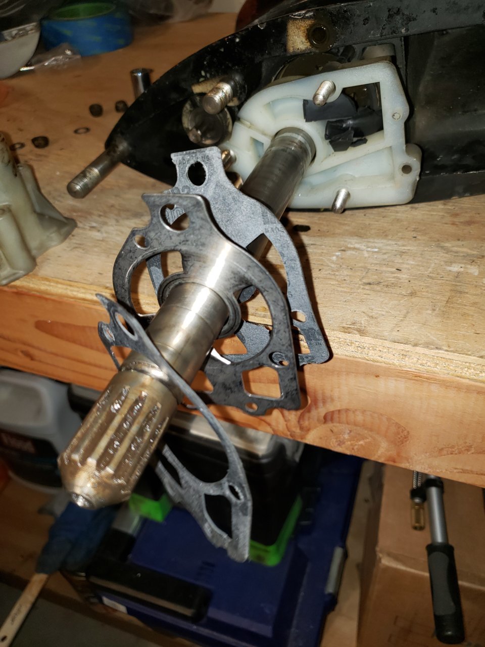

    Annnnddddd it gets deeper. HOPEFULLY This Pre-Alpha drive has been updated, as the cables for the pre alpha drive screwed in from the front (bellows) side and not after like the newer Alpha gens. The catch is those cables are no longer available, and you have to update it by using a 1/4-18 NPSF straight tap and run it in from the front side towards the prop side... Bigger catch, apparently if you mess up, the bell housing is trashed.
    So I can still use my purchased shift cable, but may need to hunt down a non-tapered tap and do this update. Unfortunately my Impeller and pump housing kit wont work, because the bases are different. So I need to return that and get the kit that has the appropriate base. Apparently the rest of it is pretty much the same, other than the base.

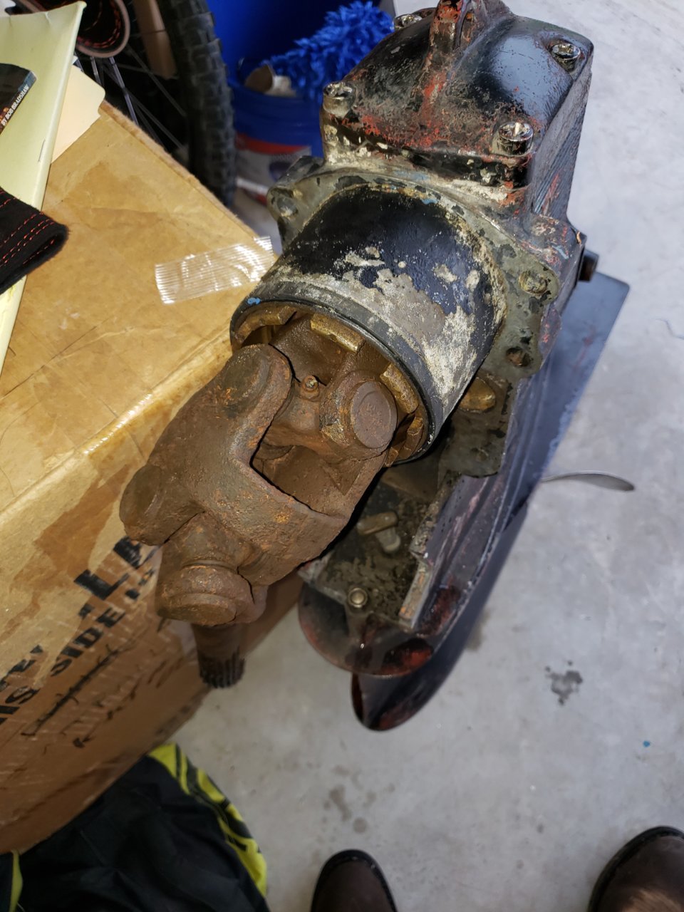

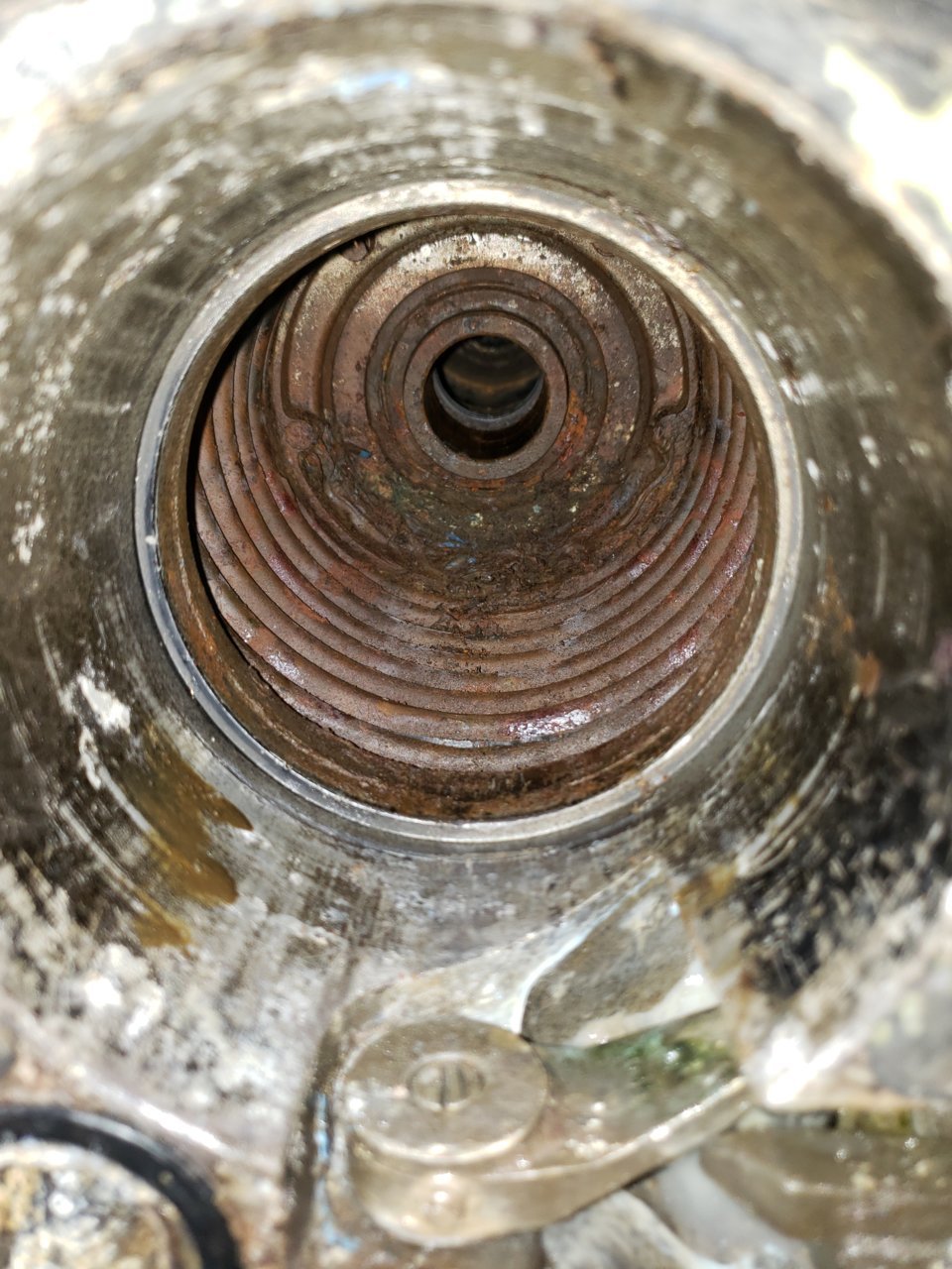

    With the 4banger I don't think I'll be breaking anything hopefully. Just got in from pulling the drive off.
    The u joints show their age, but there is no slop in them. I'll regrease and keep going for the season. The inside of the Bellow is a mess... It sucks because it looks like someone was recently in this outdrive, the bellows exterior look almost new. The shift boot to... The gimble bearing isn't great, but it still rotates smoothly and doesn't hang up... So
    Looks like after this season I'm doing a tear down and rebuild.

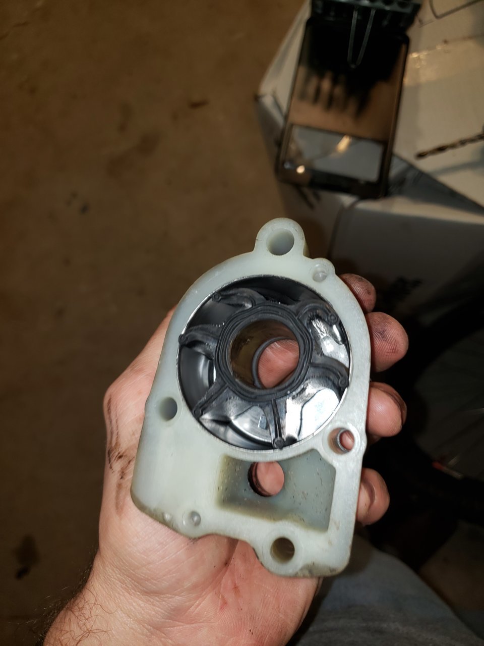

    Well that's an interesting way to install an impeller...
    Trying to figure out my outdrive. The eye loop on the top tells me it's pre-alpha 1... Mc-1 series. But the squared off anti-vent plate says type R and MR. But the output shaft in my lower doesn't have the tension pin thing, which says alpha 1...
    Ugh

    So I compared the pump base I took out of the outdrive with the ones I purchased. The one I took out is a pre-alpha MC1 base. However the lower has been identified as a alpha 1 lower due to the vent plate and the lack of pin on the shaft...
    Soo... Did the owner put in the wrong pump, or am am I incorrectly IDing the base? ... The world may never know

    They both fit Pretty much the same but I've read of you use the wrong one it's bad news.
    But can't find anywhere online to know which one to use lol lol

    I found the serial number for the lower half of my I'll drive and it matches up with a alpha one from 1986. So I was correct and that I have a MC1 upper and alpha one lower. I put the appropriate water pump kit in ( previous folks that were in there put the wrong pump base in...) I put the two halves back together and tomorrow I will start the gimbal bearing and bellows and then do plugs and oil in the engine and out drive and hopefully I will be in the water soon
