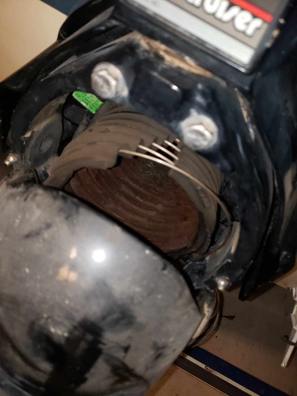

    Easy parts done... Got the 3 new bellows onto the transom side... I walked away for a bit before I start wrestling it to the outdrive side...

    The bellows royally kicked my ass. I spent probably 5+ hours on literally just trying to get them on the outdrive side. I was using the method with the threaded rod and washers as the tool. My issue is no matter where I orient the clamp, I can't get to it when I have the bellows in it's place. I can't get it in place but I can't hold it in place.. my hands and fingers are trashed.
    Kicked. My. butt.

    guess this is what I get for trying to do it without the bellows adhesive. Ordered that, the alignment tool and the bellows tool. I'll rehash it when it all comes in haha.

    Yea, I couldn't hold it on and get to the damn clamps at the same time. Getting the bellows on wasn't the struggle... keeping the dang thing on while manipulating the assembly to get to the clamp.... The engineers need beat with 14 extensions and swivels. I may need to pick up a flex-drive but it's still a tough fit. I ordered some adhesive from Amazon, but of course it's not prime. They didn't have one that was. So now I wait. Im hoping the adhesive will secure the bellows better so I can get to the clamp.

    I got it on without the adhesive! hopefully it holds lol

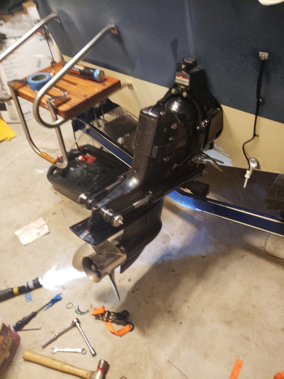

    Got the outdrive put together and put back on, new bellows, new shift cable, adjusted, new water pump, impeller and gaskets. Put new gear lube in it. I even put on a new speedometer thing as the one in the boat was broke.
    Now I just hope the oil seals are good and all the new fluid says INSIDE the outdrive. I have all gears now too!!

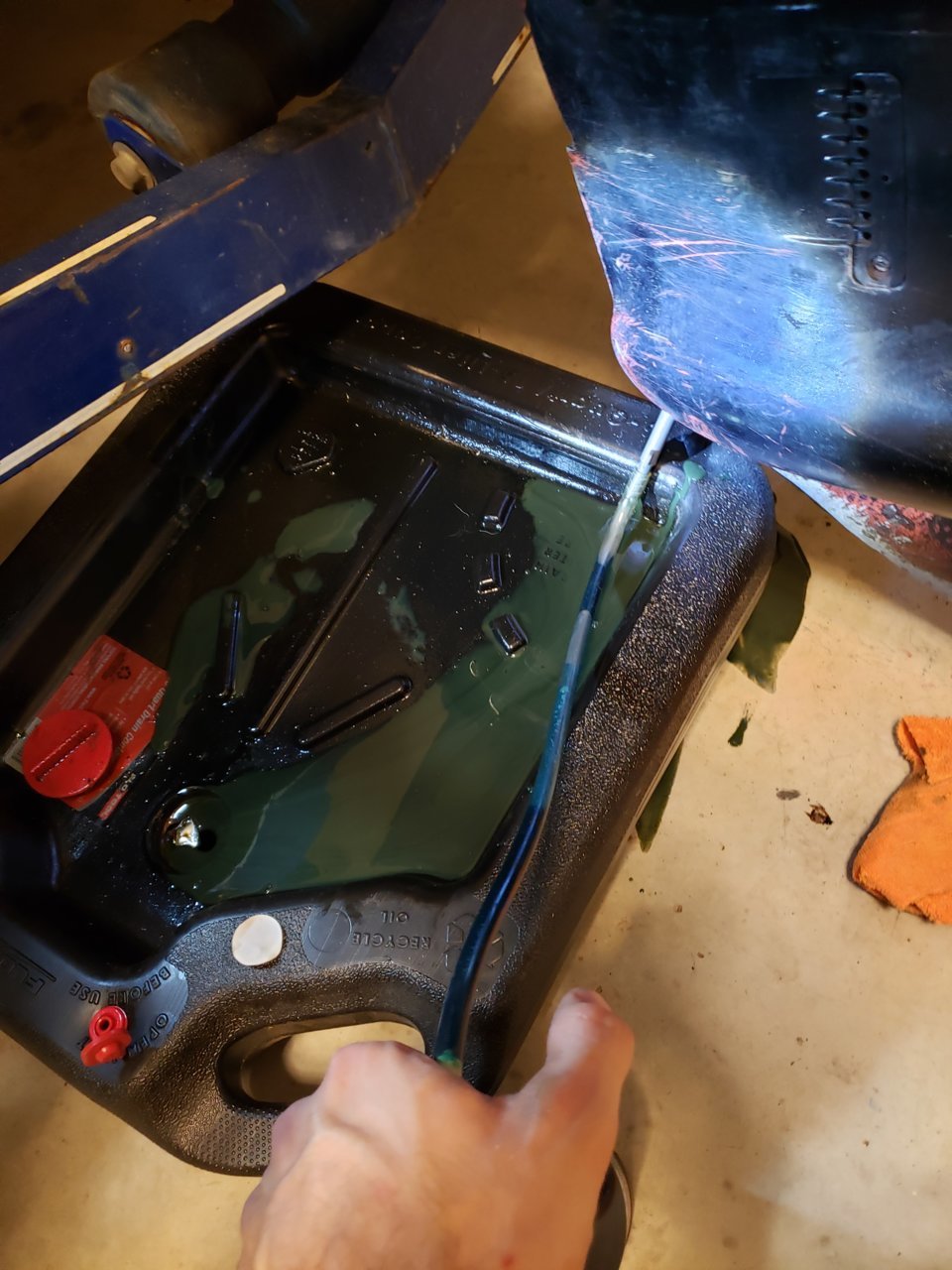

    Drained the old oil, put new plugs, out a fumoto valve on the oil pan (so I can just run a tube out the drain hole) I got the wrong fuel filter kit but the current one looks great. I fiddled with the cables some more and officially have all gears under power.

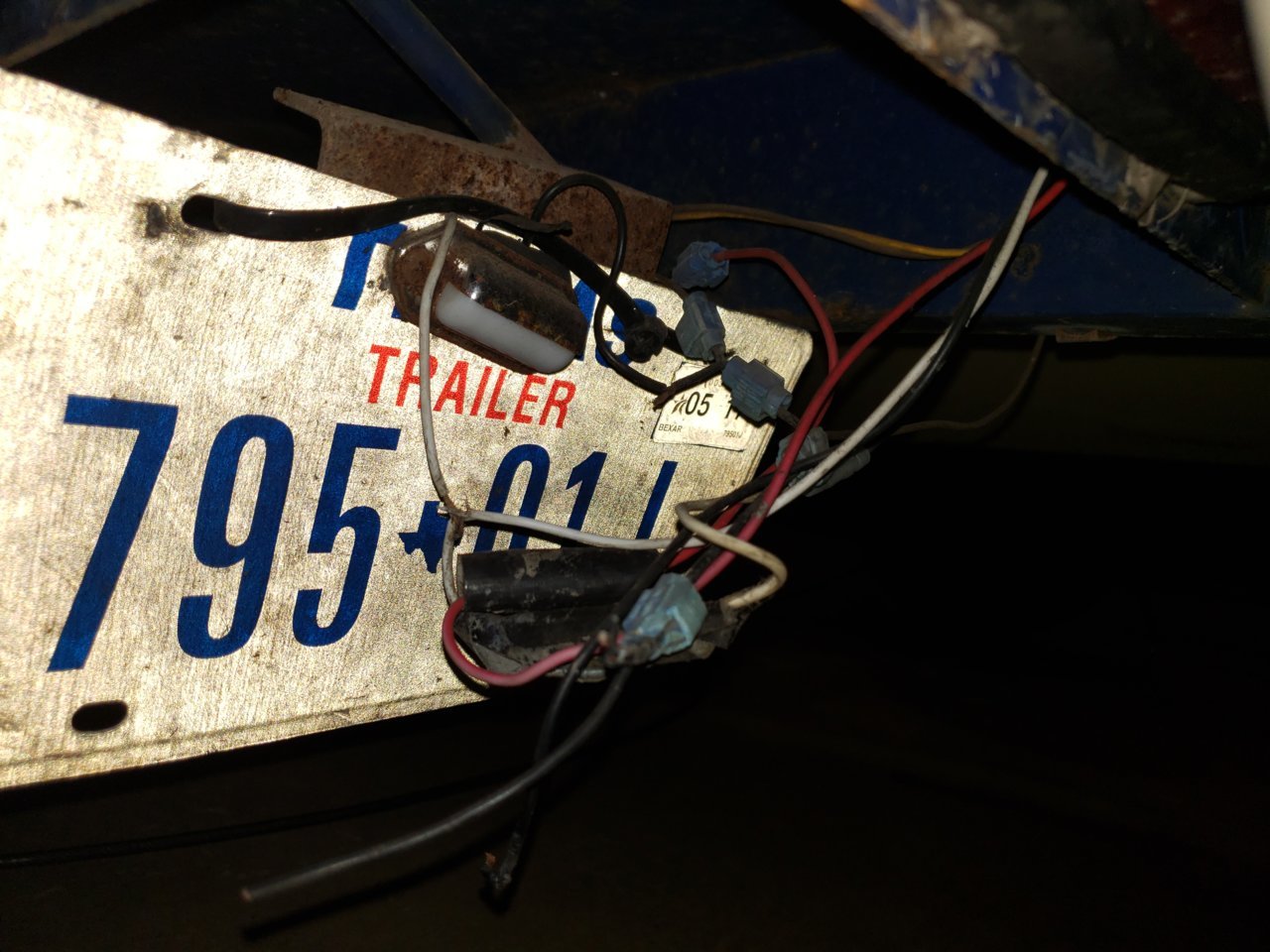

    rewired and replaced all the lights on the trailer... Previous person who wired this thing... should never EVER touch a wire again.... Twist caps, duct tape, twisted wires and literally 5 splice connectors in ONE corner of the trailer. Random wires that are cut/ went nowhere. Nothing was weatherproof. I am pretty anal when it comes to wiring, and always spent too much time and overkill it... SO, everything I did is weather pack connectors WITH shrink wrap. I did cut some corners and used splices, however I packed and coated them completely in RTV (lol). There weren't bushing or anything where the wires passed through cross members, so I ran wire loom through it to protect any rub points and the plug end going to the truck has shrink wrap and wire loom on it to keep it from rubbing/breaking down from being unplugged etc.
    Now I just need to register and title the trailer.....

    This is just an example of the old wiring.... It was that bad....

    On my trailer, the wiring was very similar to yours, random crap connectors if any at all. Some were just taped over twisted wires.
    I just ripped it all out and bought a complete wiring harness.
