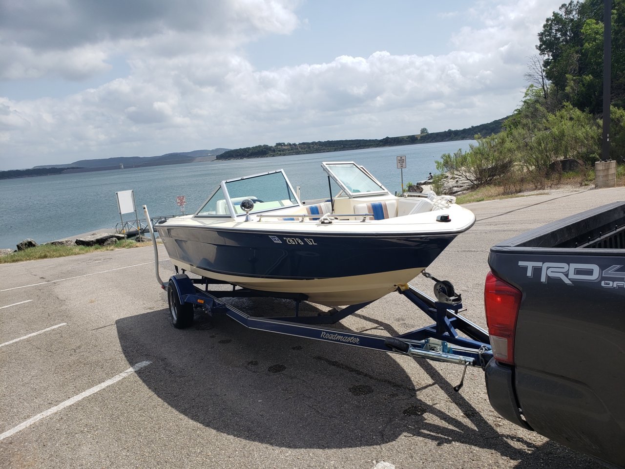

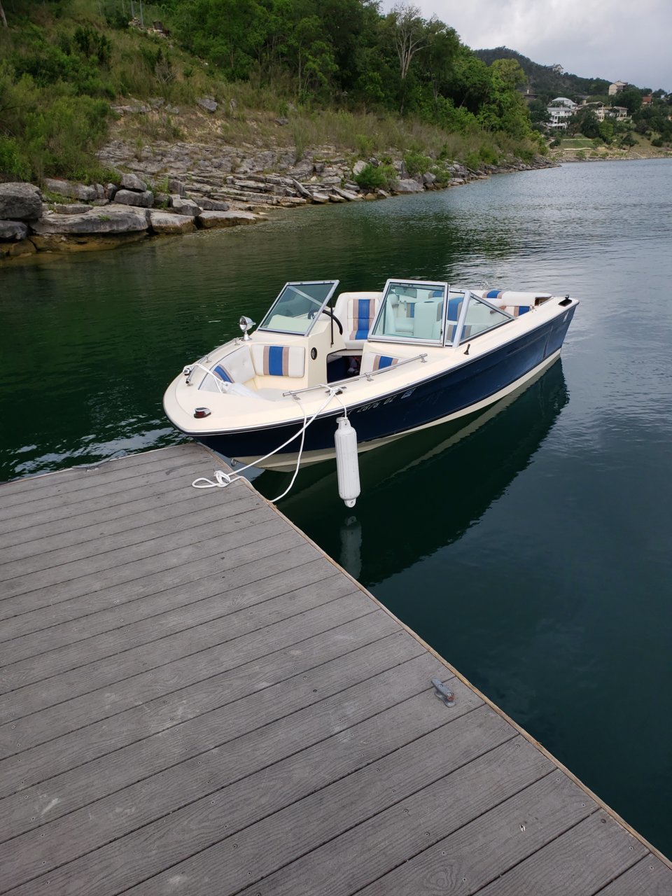

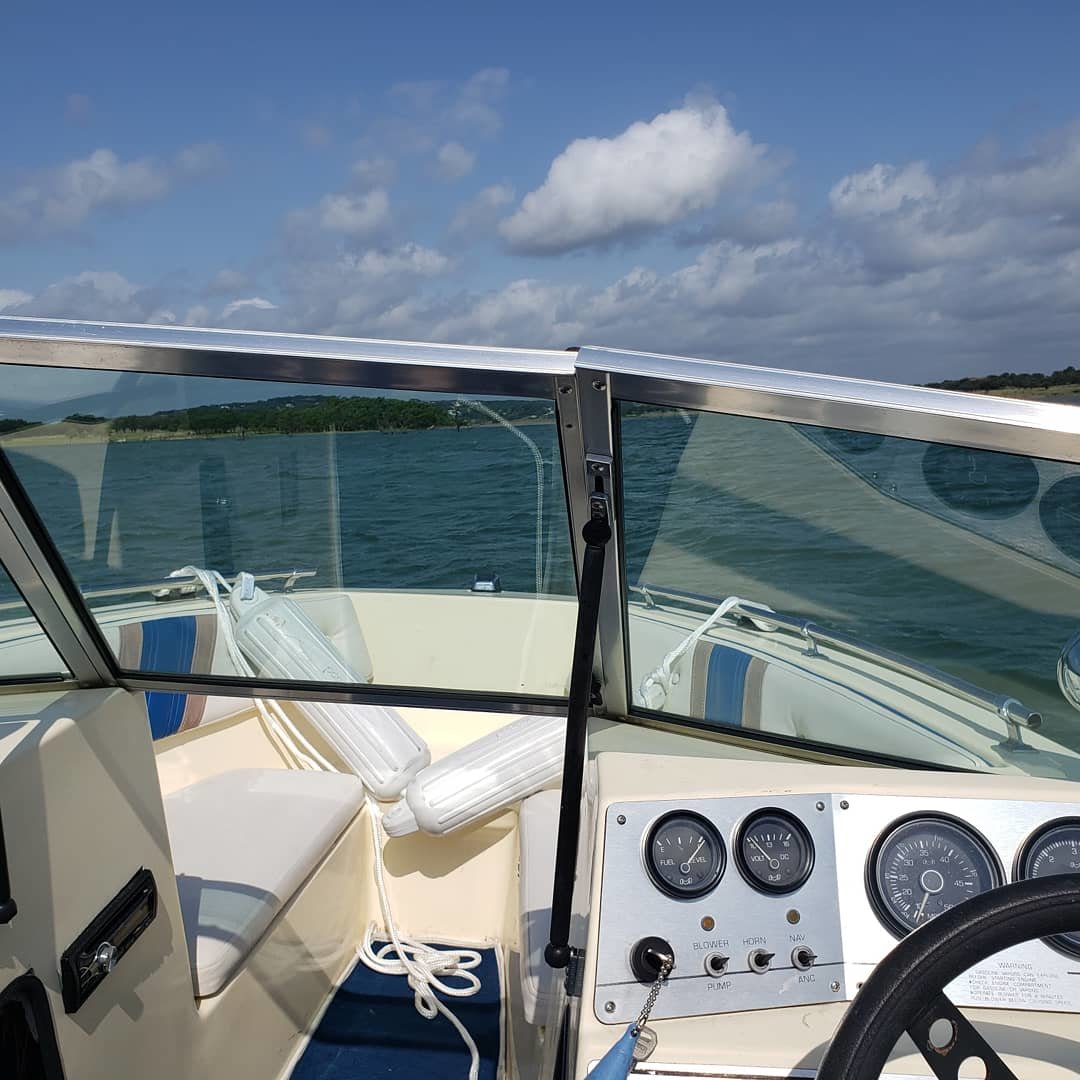

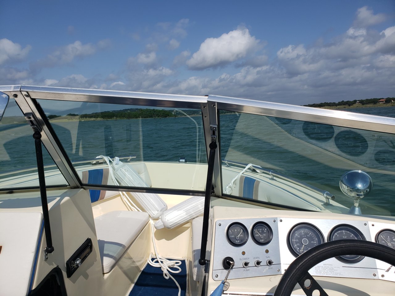

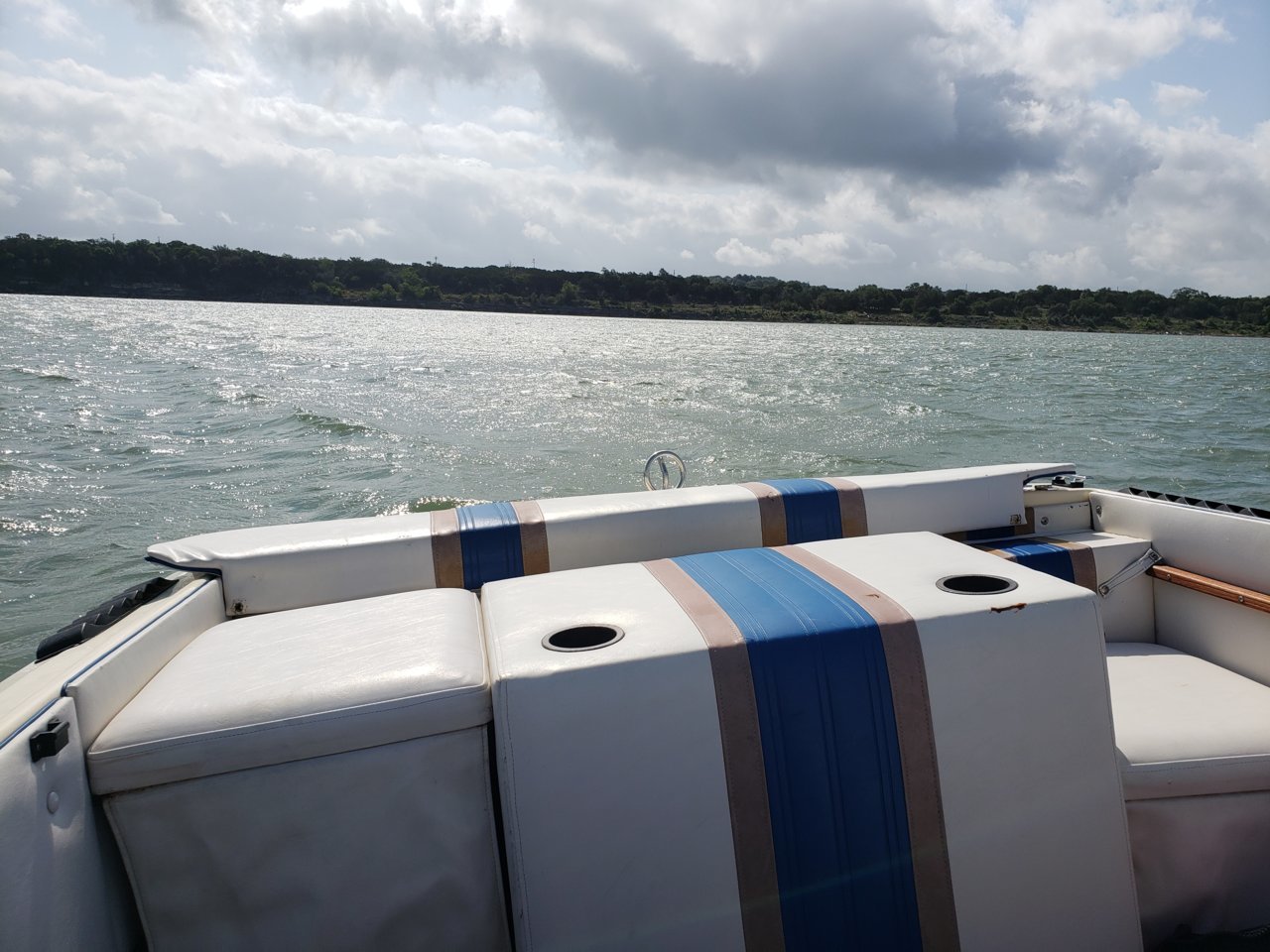

    Sorry no vids of the launch... I did it solo lol.

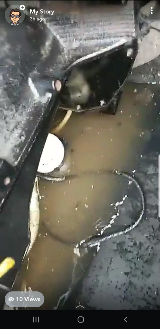

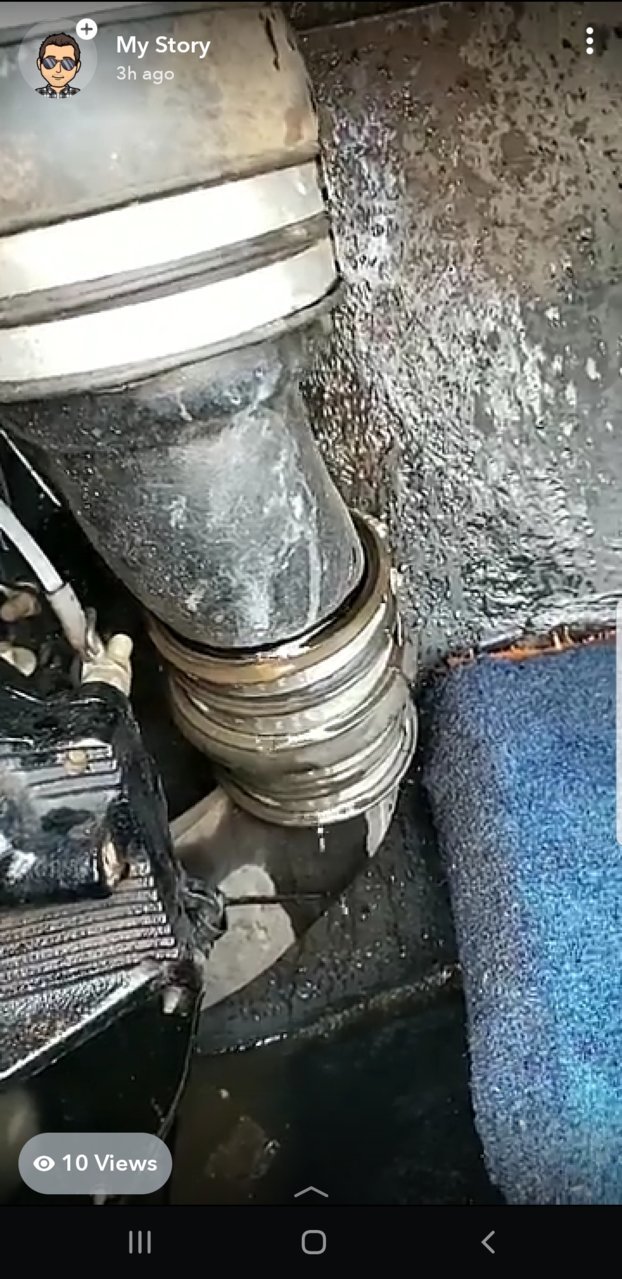

    But no issues on the launch. Started right up, etc. It is a good thing I fixed the bilge pump though... The exhaust/water thing leaks at the rubber couplings. So I had to run the bilge often.
    Also, holy crap was it a bad day to be on the lake... Windy and choppy.. I have literally been on oceans that were smoother. One wave hit me so hard it knocked the storage panel in the floor out of place, and made the anchor bounce. At idle speed, a few waves broke OVER my bow... That was when I decided I had enough and had to slowly make.my way back.
    The throttle doesn't like fast movements. Smooth and slow and I can get onto plane. If I mash it it'll choke out. The boat will cruise at 30mph, I trimmed it out to hit 37-38. But it's only hitting 3800 RPMs at WOT. So I think the prop on it is too big, as evidenced by them cutting the trim tab off to accommodate it. It also favors left sided steering and the steering wheel is hard to move and will fight you... May need to grease something up. Temperature gauge isn't reading either. So I'm either not getting up to temp (thermostat) or the sending unit/gauge is bad. I think I'll just replace all 3.
    Annnd the belt started to squeal at the end.
    But overall, a good day. Just wish it wasn't 2+ foot swells on a damn lake.

    Sorry for the cruddy picture quality... It's a screen shop from snap chat.. and it was tossing and turning. I've never gotten sea sick on a lake before.... But I was close.

    The 4 hose clamps were pretty loose. Well see how that works next time lol.
