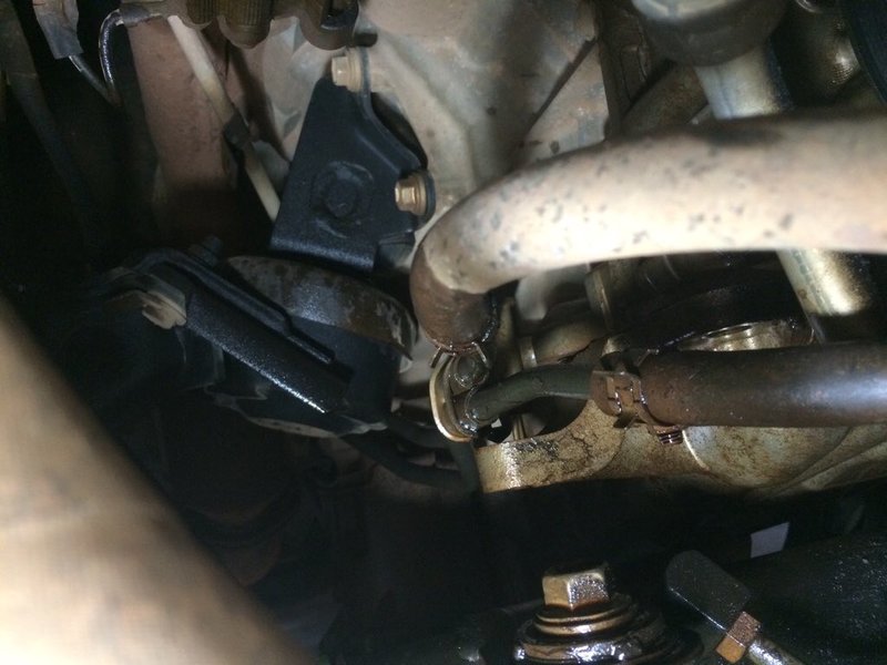

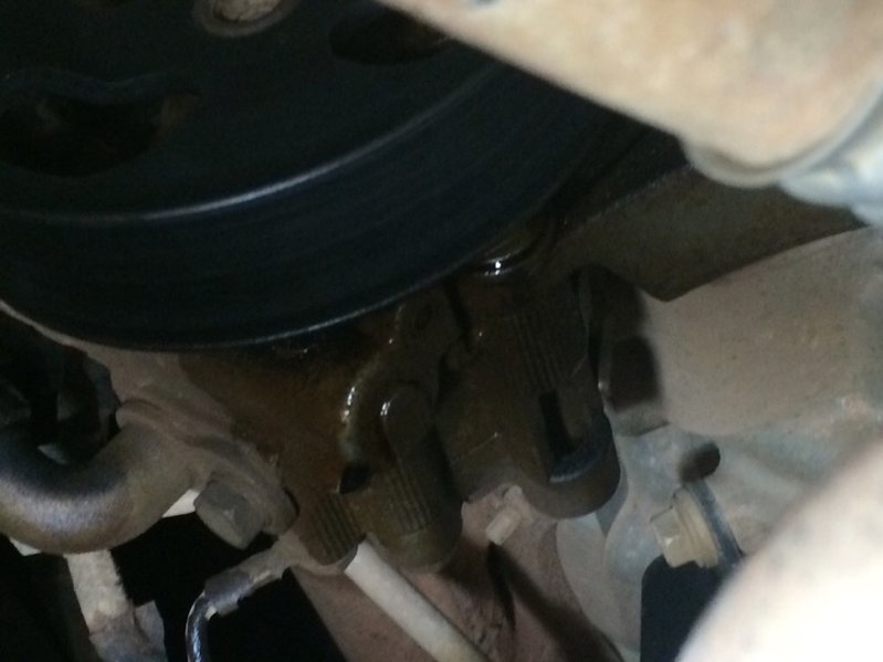

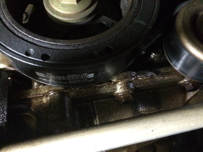

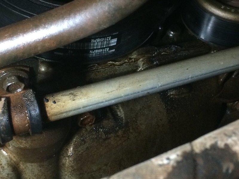

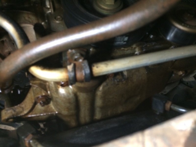

    So last week I noticed I had an oil leak. It didn't seem too bad upon first investigation and just wrote it off as the notorious timing chain cover leak. Well today while installing my wheel spacers things look incredibly worse and leaking in a different location.
    Looks as though it's the seal below the harmonic balancer. I have pictures. So please give me opinions. On whether you think this may be the source and what kind of job am I looking at to fix this leak.
    I'm going to post all the pictures I took. Some may not be useful.
    ImageUploadedByTapatalk1423892784.342474.jpgImageUploadedByTapatalk1423892806.406633.jpgImageUploadedByTapatalk1423892814.055936.jpgImageUploadedByTapatalk1423892822.239951.jpgImageUploadedByTapatalk1423892829.524352.jpgImageUploadedByTapatalk1423892836.342227.jpgImageUploadedByTapatalk1423892850.325684.jpgImageUploadedByTapatalk1423892857.127811.jpg

    Try cleaning it very well with brake cleaner, and then check.
    It may be from the #1 oil pan to block mating surface.

    theres a tsb for the timing cover reseal
    i bet thats what you need. de grease it and see where it comes back from

    Looks just like the leak I have. The only thing that j have s light coat of oil on the power steering pump and a hell of slot if oil near the crank shaft.

    Yea a tsb if your under warranty.not at 155000 miles when the problem shows up. Like I said there is a light coat of oil near the power steering pump and timing chain cover but below the crank shaft there is a hella of lot of oil.

    I would guess that it's the crankshaft seal behind the crankshaft pulley.

    That's what I'm beginning to think. How bad of a job is this?

    ^^ this. Myine leaked there and looked like it was the timing chain cover. Just replace both the sea and pulley.
