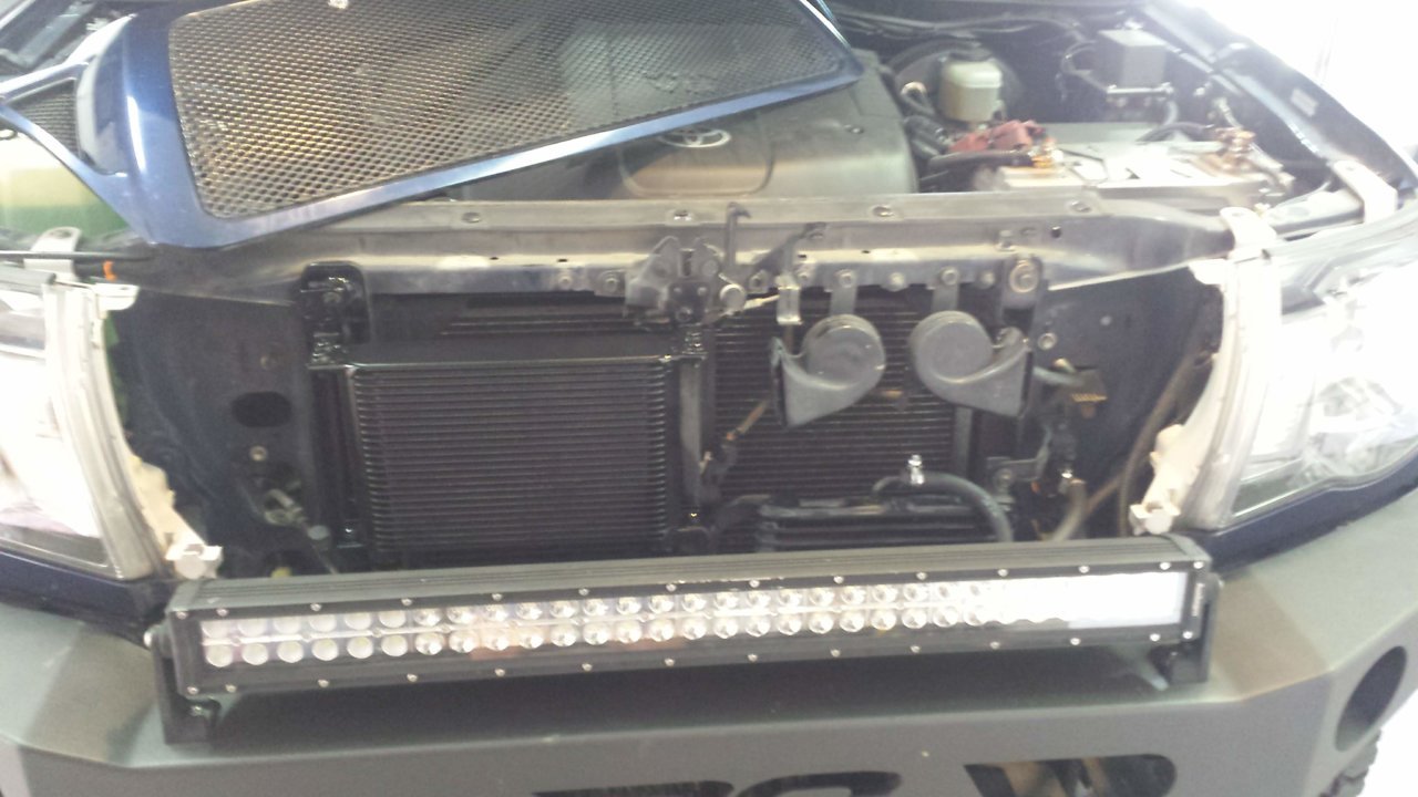

    And BTW, I to upgraded the the stock trans cooler to a larger one. I actually left the stock one and ran the larger one inline. It made a night an day difference.
    Here is a pic of my set up. Sorry for the crummy pic...
