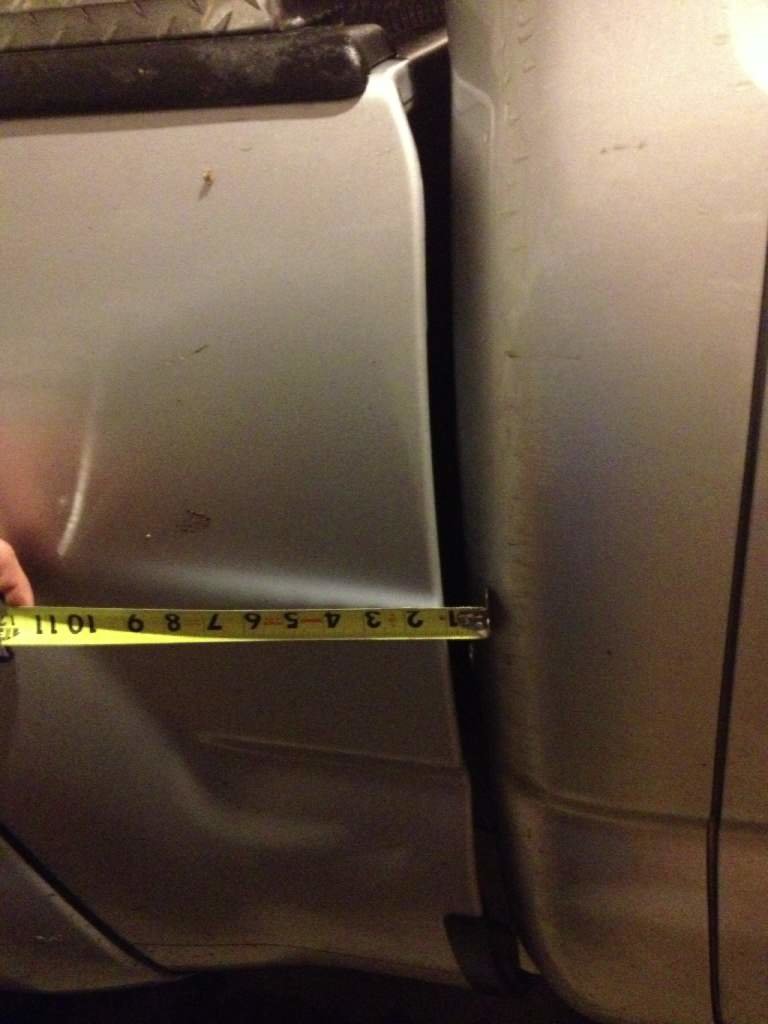

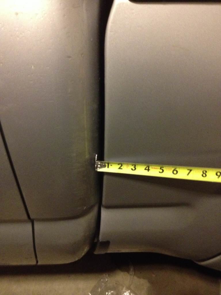

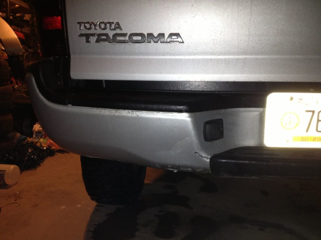

    Today on my way home had a girl run right in the back of me at a stop light(I was stopped at red) at first I didn't think it was too bad just bumper. But then my friend noticed my bed is about a 1/2 closer to the cab on drivers side. She hit more in the driver side and the bumper didn't even hit the bed or anything. That's why I thought nothing of it. She had insure and we did police report so I'm good on that end.

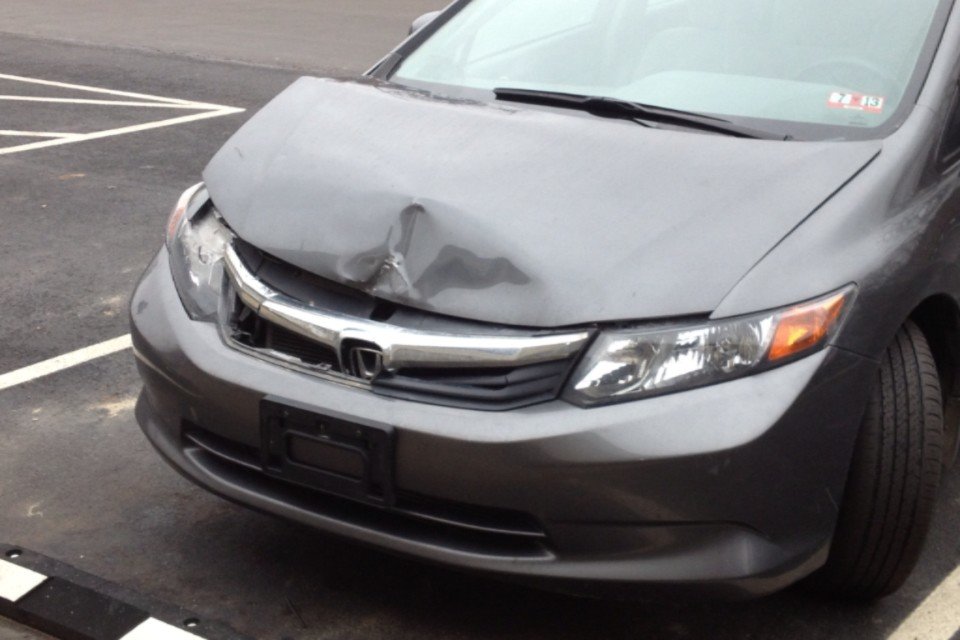

    Her car
    So my questions?
    1- hopefully my bed slid? But bumper didn't hit bed and I think she went more underneath my truck. I looked but did see any thing, but a small bent would be hard to see. I hope not my frame.
    2- my brand new truck- she has geico- has anyone got depreciated value from them? Sucks my new truck already going to have bad carfax!
    Thanks!

    1. Only way to know is to take it to a good collision shop and have them inspect the frame. If you look at the IIHS Tacoma crash test videos in slow-mo, the impact shockwaves causes the frame to vibrate. So it is possible for the bed to slide forward without the bumper touching it. It's easy enough for a shop to check - just loosen the six bed bolts and see if the bed can be adjusted.
    2. For a new Tacoma, bent frame doesn't necessarily mean the vehicle is totaled. Frame replacement is a real possibility.

    A civic hit you too! Lol
