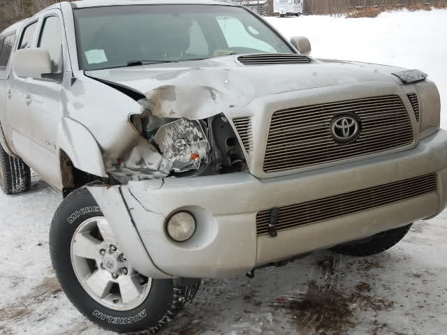

    Last week, hit a tree ! $ 8,000. damage
    Booked-into bodyshop for Dec 28
    I've bought a delivered to the body shop an "ARB" BUMPER
    No winch or lights being installed at this time.
    Q. Is the factOry suspension going to be okay or is it compulsary to modify it ?....any other suggestions?

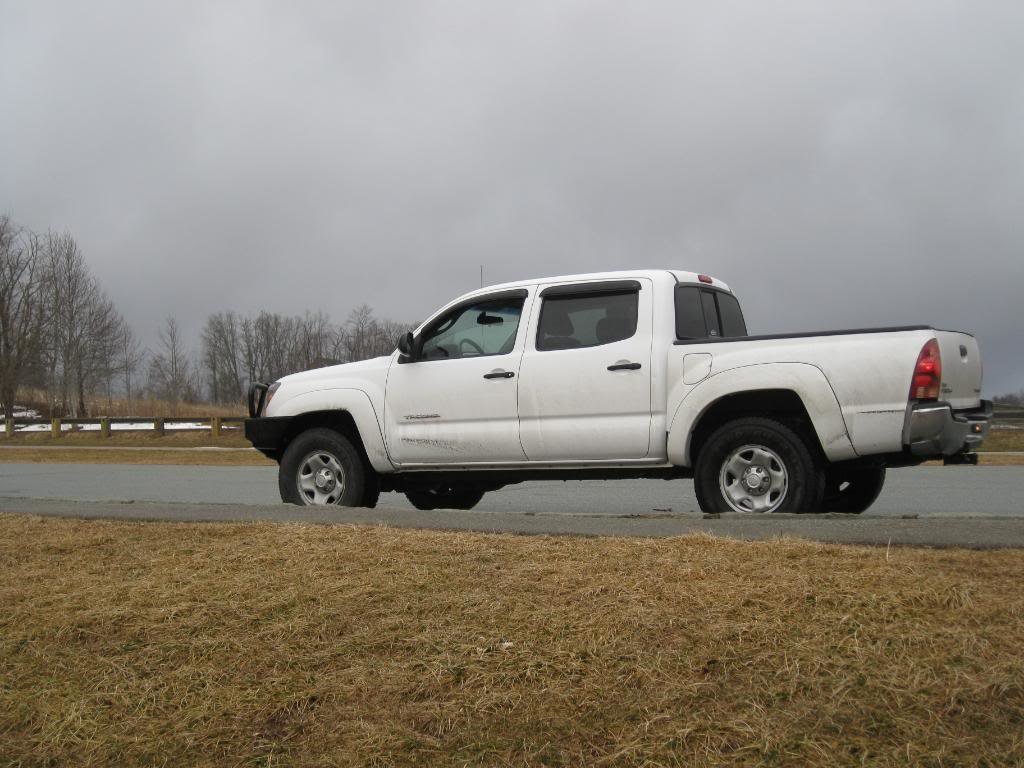

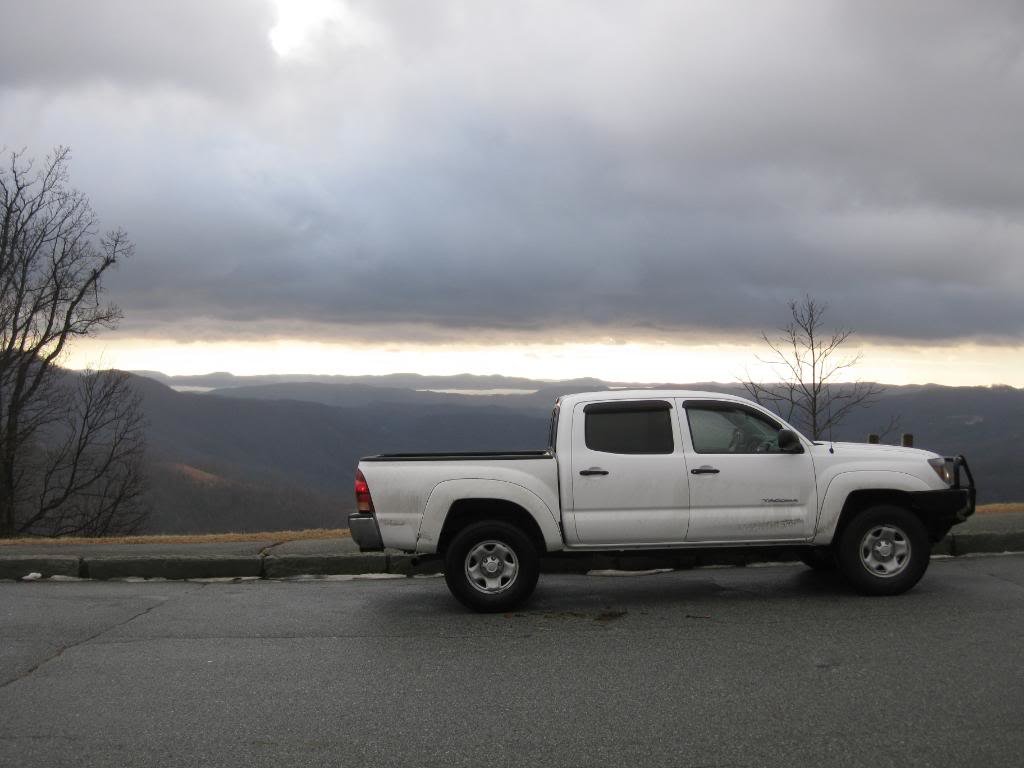

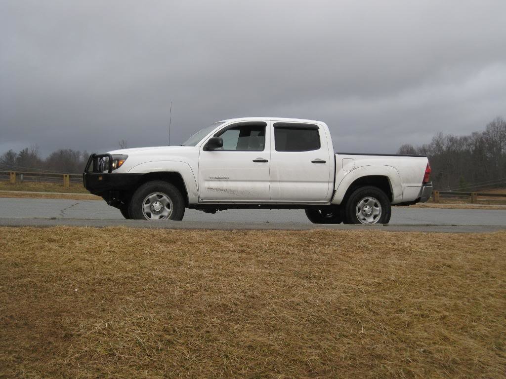

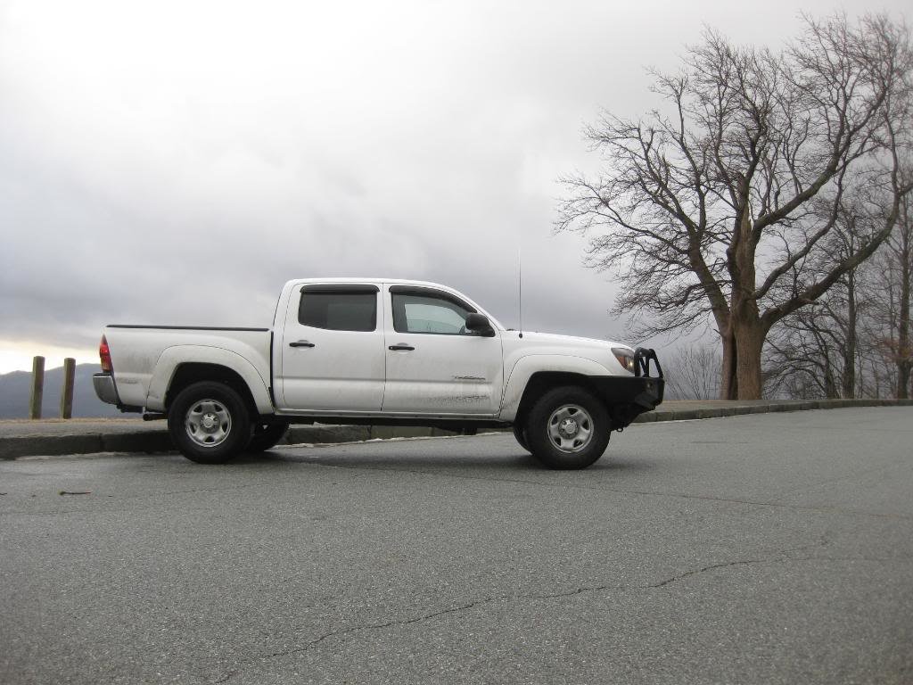

    Got some pics on flat ground.

    I have run stock suspension for a year now. The truck will handle it but I would rather not abuse it.
    Yes you definitely need to upgrade. At the very least a set of bilstein 5100s. I to the point I'm just gonna do it right and go with ome nitros and ome 886x's.
