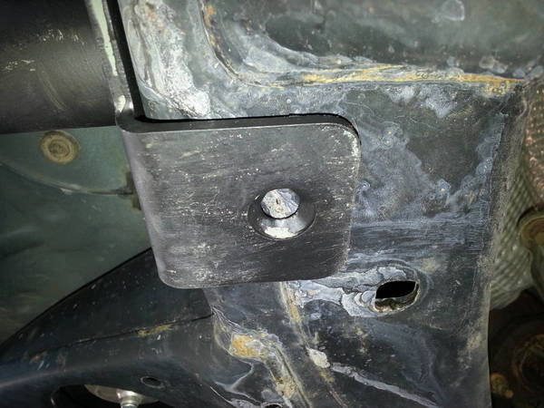

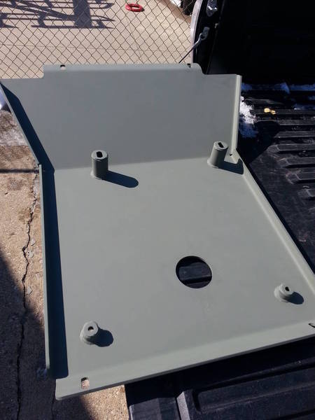

    Front Skid don't fit.
    The front bolt holes are way too far apart, and rearward ones are about an inch off as well. The middle ones line up nice enough, though.

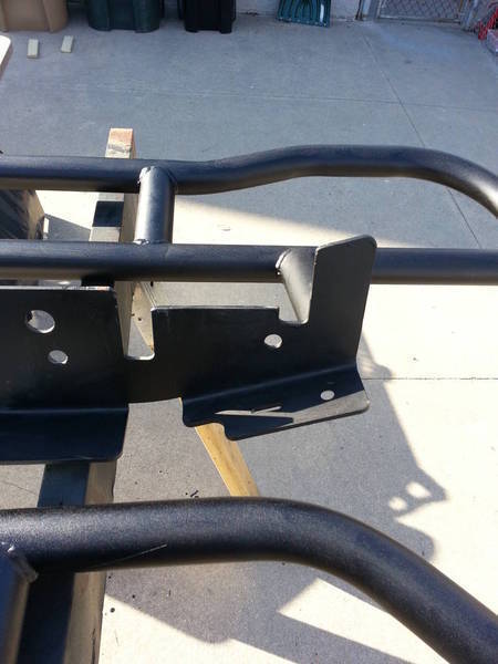

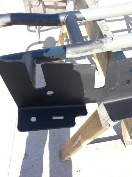

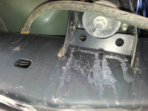

    The sliders are also a bit off.
    This tab here :
    Hits this part about an inch too high.
    And some of the bolt holes to be drilled are right over frame welds or otherwise don't line up real well.
    It's not that big a deal, but I thought you know.

    You need to take off the oem skid plate brackets. Should fit like a champ after that.

    Take off those 2 braces. Then it will line up :)

    As for the sliders, Adam, I busted out the grinder and fixed the slider fitment issue. I don't know if this peculiar to 2012+ tacos, but you might take it under advisement.
    Trim that tab in the middle down a bit and it fits nicely.
    Otherwise (and this is sort of a bad shot) it hits that angled piece there at the body mount and won't seat in all the way.

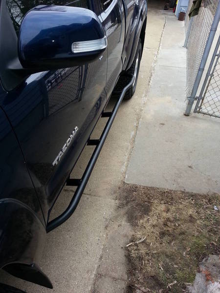

    It's all good, man. I have a model refresh, and this truck was one of the first 2012s made - there is a lot about it that is not quite the same as others. Besides, this is not a hobby for people who can't problem solve.

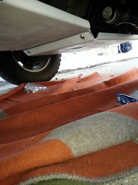

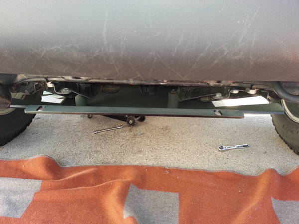

    After the drilling and letting the paint dry, I got the sliders fully installed today. They. Are. Awesome. The truck looks totally bad ass now.
    I'll try and get some better pics maybe tomorrow. Also, the drivers side is a bitch to do, though. Gas tank, brake lines, power cables - all there. The joy of small trucks....
