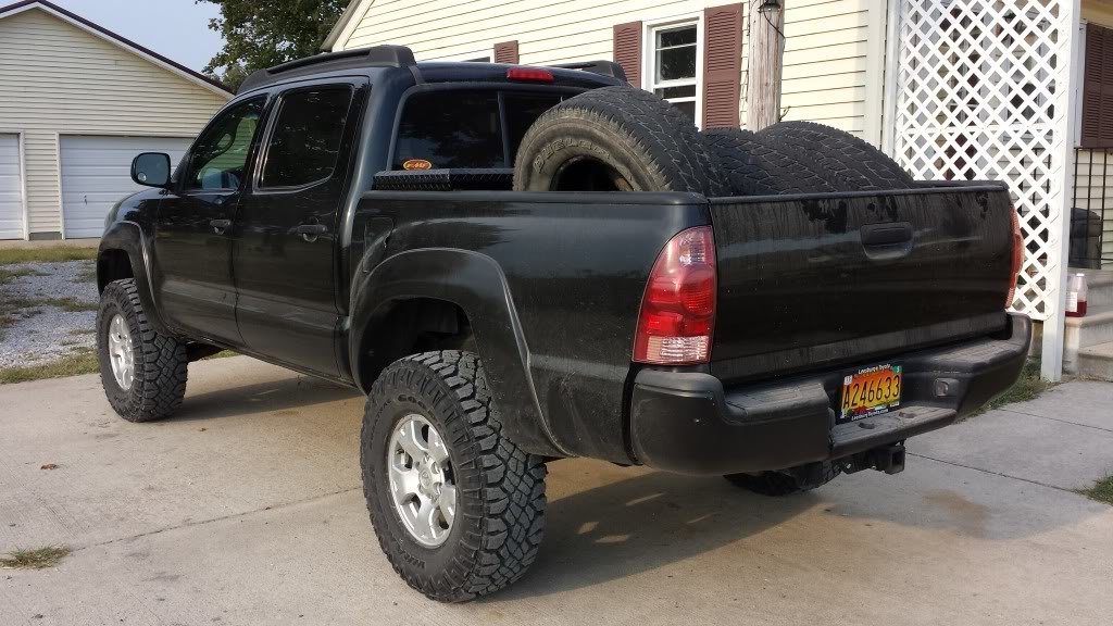

    After putting my lift on over a year ago, my bridgestone duelers were finally worn down enough to justify dropping the cash on some new rubber. I went from 265/70/r16's to the 285/75/r16 Duratracs. Will have to do a little trimming of the plastic inner fender, but other that they ride great paired with the OME suspension. I will say, for anybody lookimg at the dueler ATs, I highly recommend them. Never had any issues, got close to 65k miles out of them
    3" OME Front and Back
    LR UCA's
    1.25 Spidertrax

    Looks sick!
    no cab mount chop? im swapping to 285/70/17 MT/Rs with kevlar next spring and im dreading the idea of having to do the cab mount chop

    What gear ratio does your SR5 run? How much did the 285's bog it down? Looks awesome, congrats.

    Thanks. Its pretty close to the cab mount but I don't wheel too often. I will do it eventually, but for now there's no rub for what I do with the truck. From the write-ups on here it doesn't look too difficult.

    Stock gears. I was actually surprised that there was only a slight difference from take off, barely noticeable. I only drove it home from the shop so I'll report back if I start noticing it more. Thanks man!

    Looks great man,
    I actually love the stock 16x7 wheels with that tire,
    Spacers make it all the better too!

    Thanks for the replies guys. I'm pumped, they've been a long time comin. I feel like the guys at the shop thought i was weird because I negged the waiting room and stood at the entrance of the bay watching the process haha. Just trimmed the plastic. Piece of cake with a razor blade, no more rub at full lock, at least on flat land...
