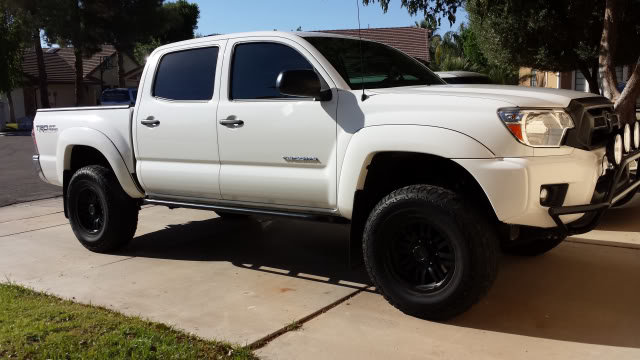

    Sierra Expeditions did the install and I couldn't be happier. I was very impressed with their price for the install and their customer service. I sourced the parts from various vendors but they did the install.
    Bilstein 5100's all around, OME 8500's, ICON AAL. Rides great and I think it looks great.

    Looking good!!! :thumbsup: What wheels and tires are you running?

    They're the MB Motorsports with Hankook Dynapros that were listed in the AZ classifieds a couple weeks ago.
    I'll be listing the stock wheels, tires, and suspension in the classifieds soon.

    $80/hr - They charged me for two hours plus a $15 shop fee.
    I bought the shocks from Down South Motorsports for $310 shipped. The ICON AAL from SDHQ (PM them for TW member pricing). And the OME 8500's from Sierra Expeditions for $180. So all in I was just shy of $900 including install plus $50 for an alignment at Big O.

    Nice looking truck! What size tires and setting on the 5100's?

    Looks great! I have the same truck except an Access cab and will have my lift on in a couple weeks. Which front light bar is that you have? And did you just plasti dip your grill?

    To me it appears to be an Avid Offroad lightbar

    Correct. Super nice guys down there! Initially they were just going to rebuild the struts for me with the springs I bought from them and my supplied Bilsteins. But I asked how much to just install the whole thing and I couldn't turn down the price!
    265/75/16 and the 5100's are at .85 I think.
    Avid light bar and I painted the grill with Fusion black satin paint.
    Correct!

    Looks Sweet! How much lift did it end up giving you? Any need for new UCA's or any other add-ons?

    I didn't take any "before" measurements so I'm not sure how much lift I got but the general consensus is 3" with he 885's and Billsteins set at .85. From what I understand UCA's are recommended with a 3" lift. I'll probably get them eventually but it did align ok so I'm not too concerned with it.
