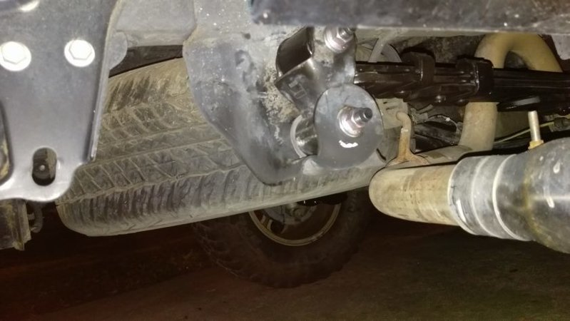

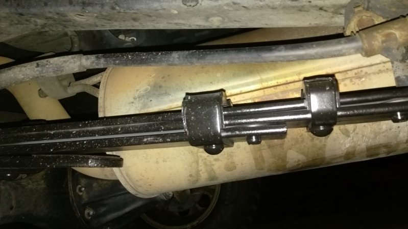

    Hello everyone! Finally I got the call from the dealership that my new leafs arrived! I got them installed yesterday. I have to admit they did a good job and the new leafs are alot better quality! The tech told me I was very lucky! My originals were by far the VERY WORST condition leafs he had ever seen and were already starting to crack!
    Anyway, I see the new leafs have the extra clamps and rivet/weld spots.
    Anyone know if my Deaver Add-A-Leaf I had installed on my original leaf pack will fit without any issues or modifying anything like the new clamps, etc...?
    Also, how do you tell which AAL goes on which side?
    Thanks in advance :)

    When I dropped it off I asked, the rep helping me about reinstalling the AAL, said he would ask what the exact terms were. He called me about an hour later and said that the terms for recall stated that the vehicle has to leave the premisis at factury specs after the new leafs were installed. I asked if i signed a waver or something and paid for the labor could they do it. He said no. I didnt push it too much.
    I think the previous poster who said they made him remove the front lift also kinda verifies that the rep was telling the trueth. The dealership i used probably assumed that it only applid to the back since thats where the work was to be done and maybe the dealership he went to assumed it ment the front and back ???

    I mean...it litterally takes about an hour to install both aal's if you have the proper tools.
    Just do it at home.

    If you didn't get tbem back, you need to go buy new centering bolts for the leafs. Off the top of my head I wanna say 3/8" bolt works, but youll need to measure the current leafs and the AAL leafs and add that all together to get your length. Also a fun fact, youll need to grind down the bolt head to fit in the hole on the perch on your axle. This was just all from a quick Home Depot run and I didn't want to spend an hour looking for the perfect bolt.

    Just make sure you have a good set of medium c clamps. All your hardware is going to be new. U bolts, nuts,...so they will zip right off.
    As far as the left/right config...just check the manufacturers site. Also....my old aal in my first gen not only was side specific but the longer end faced a certain direction.
    Im pretty sure 2nd gens dont have this as I installed a set of aals that came with a friends dakaar kit and the were equal length from the center hole out.

    Thanks bro, but way ahead of you :) already bought new center pins. :)

    Deavers have different lengths for front and rear sides starting from the center pin whole. Think i figured it out, the 18" side goes to the back and i think the one with the worst ware on the front pad must have been on the left side (tacoma lean)
