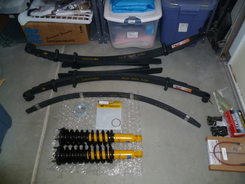

    Received my OME kit for my 04 TRD 4wd. Everything looks great and very heavy. It looks like I forgot to order the diff drop or they forgot. Rear shocks haven't came in. Have Bilsteins 5125's on the back for now. Anyways I have a few questions that I hope someone could answer.
    1. Where does the extra leaf go? Third row down? Why no squeak / friction pad? What kind of grease do I need? Is it alright to use the same grease as the driveline? Why is the center part of the extra leafs flat looking, not curved. What should that center pin be torqued to?
    2. What side of the truck does the leafs go?
    3. Where does that 5mm trim packer go? Is it even needed?
    4. Looks like the 10mm lift enhance kit sits on top of the strut assembly. I'm I correct? This should level out the truck, right?
    5. I need to to grease the bushings when installing in the leafs and shackles and then afterwards? Is it alright to use the same grease that I have for the driveline?
    6. What amount of for the front diff. I see 3/4 & 1". I should probably just get the one from Wheelers.

    The aal goes in where it fits in length longest to shortest the pre installed bushing goes toward front of truck witch side? U will have to look up. The aal does not mater not side specific. The 5mm goes on driver's side to level the truck not sure how it goes in. 10mm goes on top of struts before install. Grease some guys say there is chassis spec grease but semi's use reg grease all around and they run thousands of miles. I like the lucus red and tacky. Hope this helps happy wheeling and post pics.

    The 5mm trim packer goes on the driver side to compensate for "taco lean"

    The trim packer is what corrects the lean. It goes in between the coil and the top plate (need spring compressor to take this apart)
    The 10mm lift enhancer kit does sit on the top of the strut and it gives you additional lift. It does not correct lean.

    Unless for some reason the first gen shocks are set up different than the 2nd gen 90000's , the OME trim packer ring goes on the drivers side shock at the bottom , below the spring perch .

    Got everything from Wheelers. I would have thought they would have installed that trim packer but I guess they don't. I've figured out where it goes so I'll have to do it myself. The other day, I bought some Royal Purple Ultra Performance Grease for my driveline. Haven't used it yet. Is this safe to use for the bushing, etc? The shape of the extra leafs have me a little concerned. They just don't look right not being fully curved but rather flat in the middle. From how long they are, and not having those friction pads, it look like it's going to be the thrid one down since the top two don't have the fiction pads eigher. I going to be calling Wheelers on Monday to find out.

    OP , when you are talking about the trim packer , do you mean the OME one that is in the bag in your picture in the first post ?

    OP ,
    The OME trim packer kit , which is in the bag in your photo , is to compensate for drivers side lean .
    It installs on the BOTTOM of the drivers side shock , below the spring perch , and in your picture looks like there already is a brass coloured ring below the spring perch on the upper shock in your picture , is that the case ?

    Thanks OZ-T. The ring was already installed. I never noticed it. One less thing to worry about. Anyone have any tips on how to install the extended brake line?
