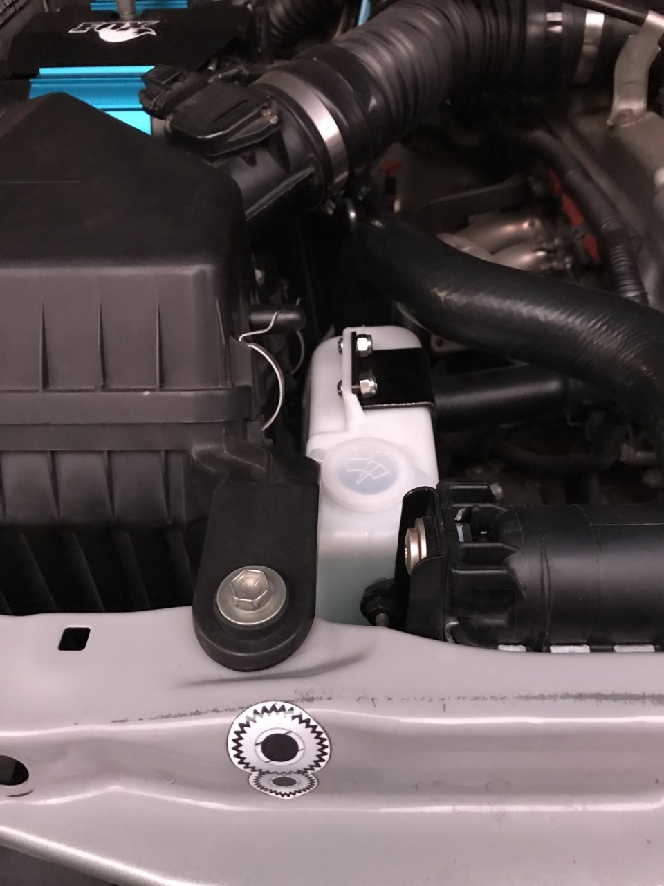

    Here is where I re-located mine:

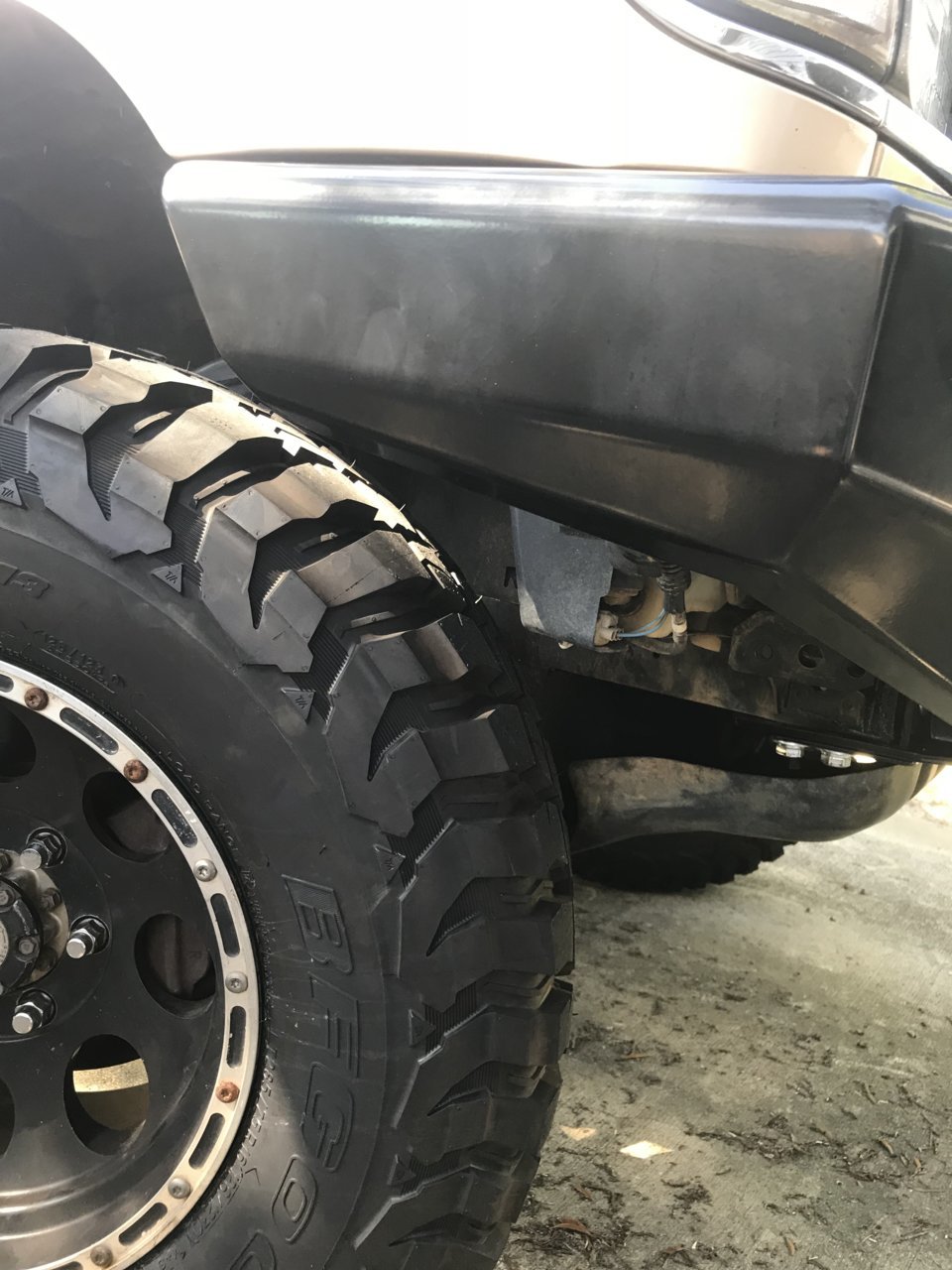

    I haven’t done anything with mine yet. I also have 285’s. It also sticks down some. I can see where it might would rub with some compression. I just got these tires last week and upgraded from 265/75. I’ll find out where all they will rub on my first trip off road. I may also move mine up like you did. Thanks for the tip.

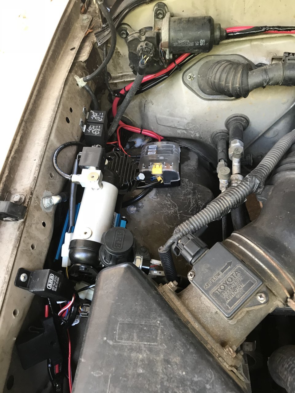

    I’ll have to come up with something. I don’t have cc but I have my Arb compressor and fuse block/ relays mounted in that location.

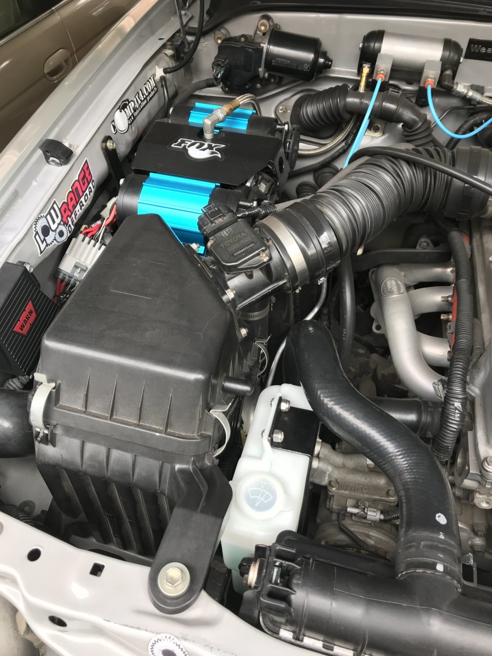

    Here is why I mounted my reservoir where I did:

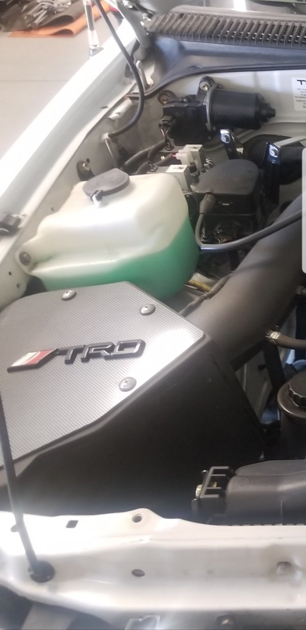

    I like that air box

    If you don't have ABS it's a super easy fit. The washer is from a 95-2000 tacoma. If you have ABS, it's still a super easy fit and you only need to bend the bracket for the ABS slightly.
    https://www.tacomaworld.com/threads...r-1st-gen-tacomas.441906/page-3#post-18761486
    Here's mine:
