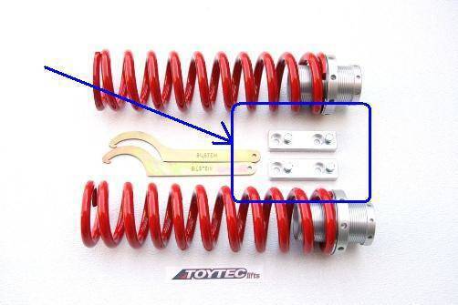

    One of the parts I ordered was the adjustable coilovers from ToyTec. But, when I opened the box, it appears that the swaybar relocator was missing.
    That's what this is, right?
    Is this an essential part of the lift? I'm going to call them tomorrow, just wondering how important that part is...

    The sway bar re-location bracket moves the sway bar forward so it will not contact the adjustable coilover sleeves. You may not need it depending on how high you lift your truck. I lifted mine 2.5" with the driver's side 1/2" higher than passenger side to offset for taco lean and I certainly needed it. If you runa higher setting you might be ok, but I would install it anyway just to be safe. It is a simple install. Call Doug at ToyTec and tell him it was missing from the kit. He is a good guy and I am sure he will take care of you.
    Here is a few tips: Set yours up a little higher than you planned and adjust down from there. It is much easier to adjust the coils down than up. Also, check your Taco for any lean issues. Drive it 500 - 1,000 miles before making adjustments. Mine settled after a long 800 400 mile trip to NC. You may have to offset yours as I did mine. Let me know if you have any questions. I think you will be really happy with the set up, I love mine. The Eibach springs with the Bilsteins work very well together.

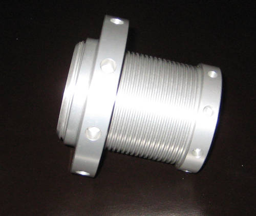

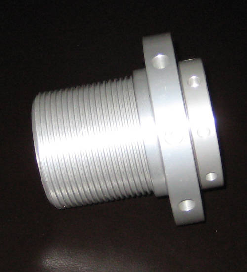

    Also, which of these settings is a higher lift?
    Exhibit A:
    Exhibit B:

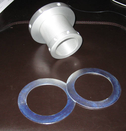

    And what are these two rings for? They were on the adjustable sleeve...

    On the install instructions,Read the second line.#15 talks about the washers.

    The highest setting would be (Exhibit B). The lowest will be pic (Exhibit A)The Steel washers will go between the spring and the coil sleeve. Be sure to greese them! This will aid you in adjustment. Both washers go together.

    Grease them with what? Anything in particular?

    In another thread I said that you keep the spring seat from the shocks.:eek: I was wrong.:eek: Line #12 clearly states you discard the coil & seat.My apologies.:)

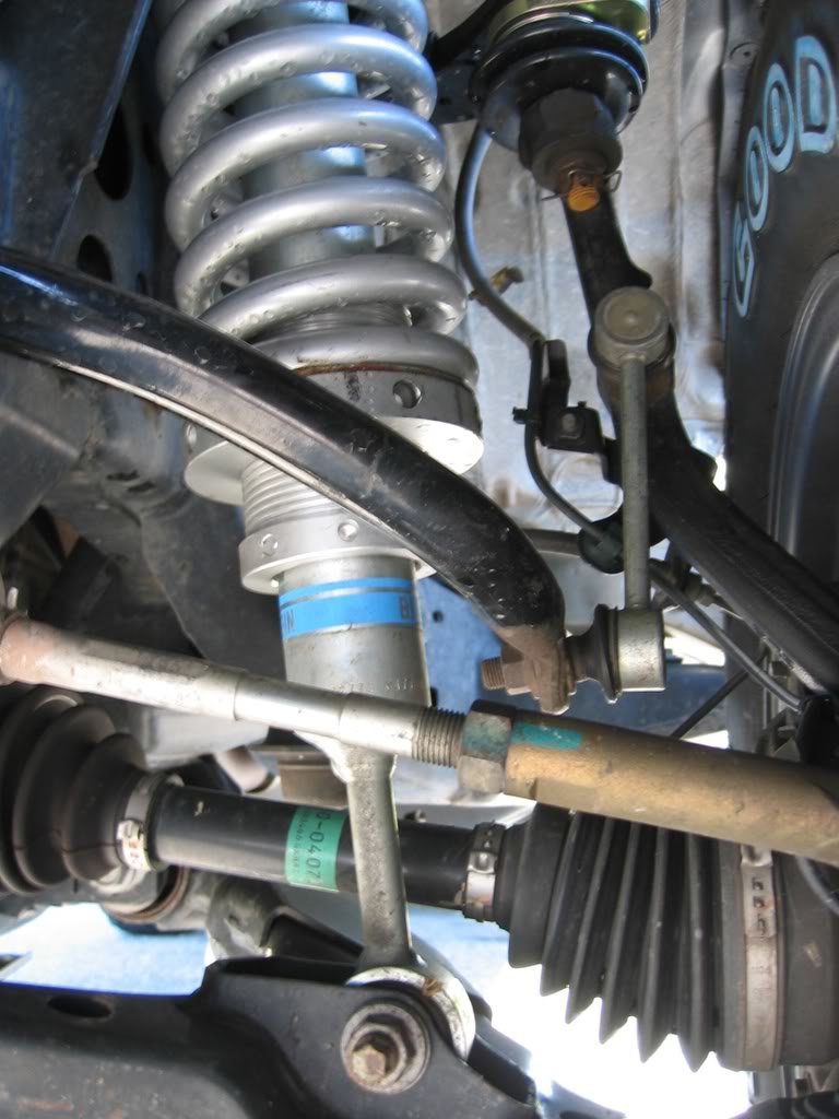

    Here is a pic of my driver's side:

    Thanks for the pic. I have those instructions printed out, I just haven't taken the time to read them yet. I figured I would have time to read them before my Friday install...

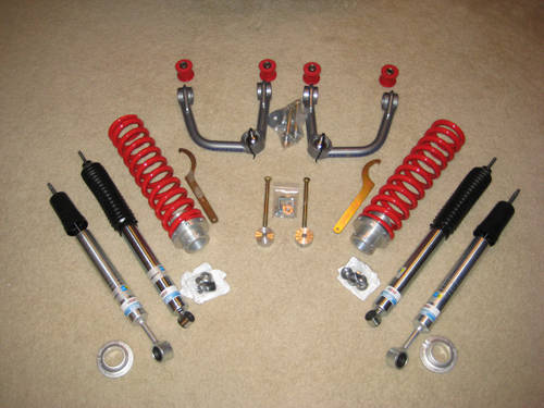

    Just for good measure, I took a picture of all my parts (forgot to include the AAL)...

    Nice set-up, looks killer. How about the wheels and tires?

    I'm gonna stay with my stock wheels for now - not ready to move up to 17x9s. But I ordered BFG M/T KM2 285/75s yesterday - be here Friday or Monday. Can't wait to see it all done!

    I like the red coils.Mine are silver.Thinking spray can.:D

    Funny thing is.....that they are the exact same!
