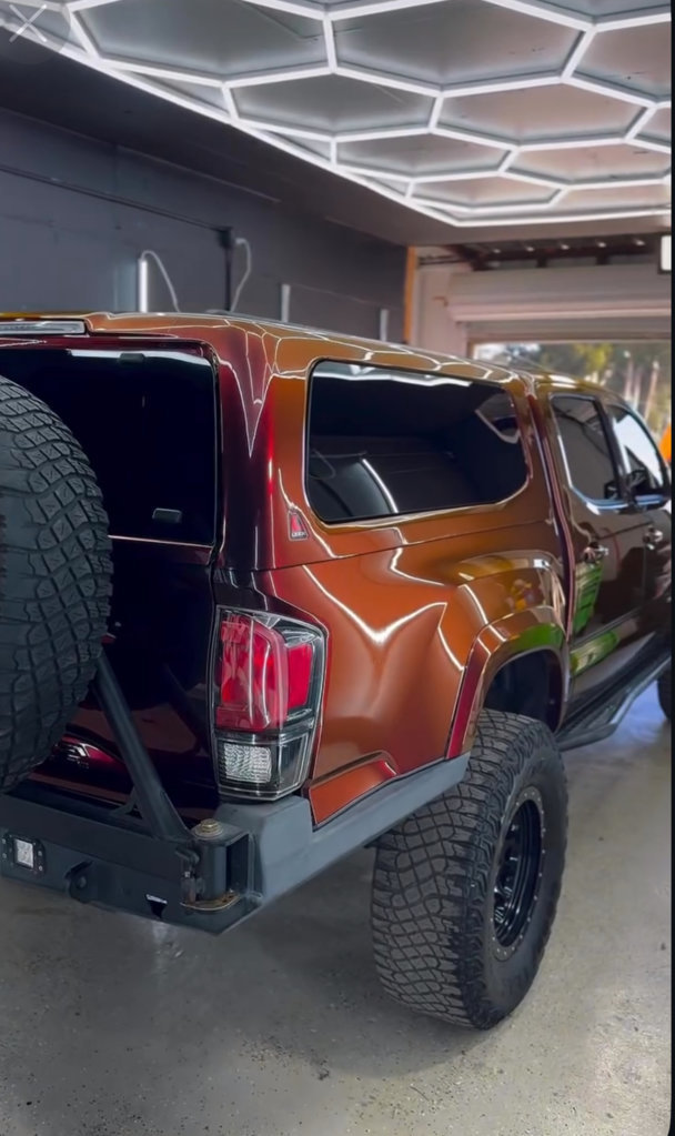

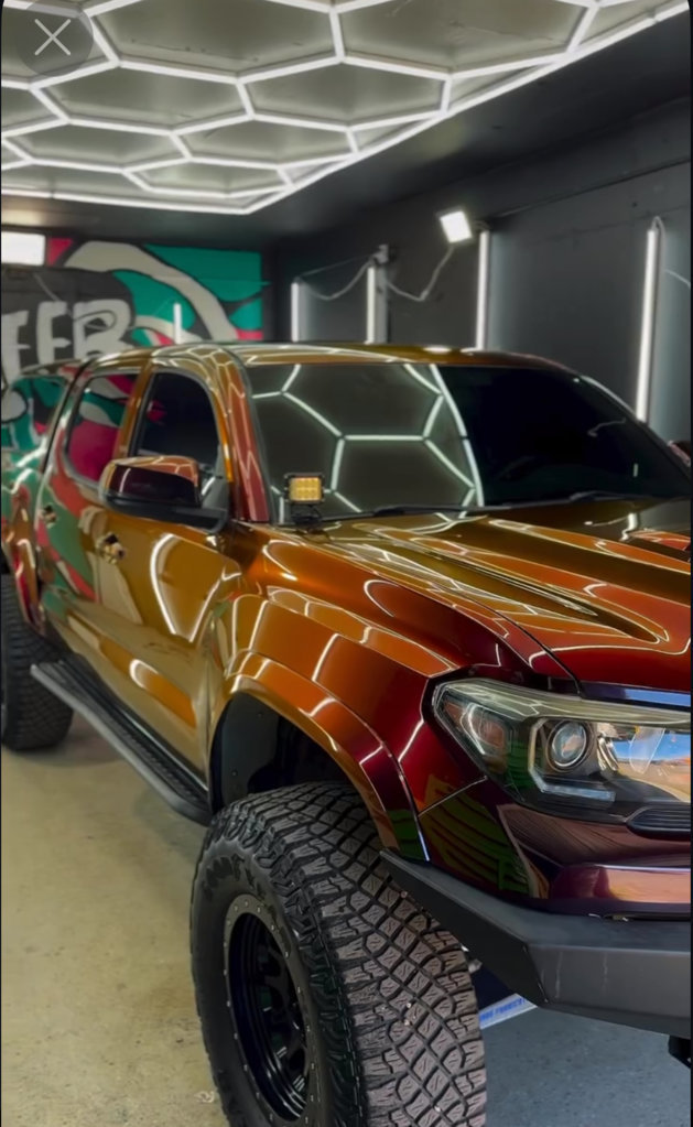

Got my truck wrapped, then this happened…

    Nice wrap!

    BTW - Sick ass wrap. Hope your engine is running as good as it looks soon.

    Nice wrap! Maybe Toyota should wrap vehicles instead of painting them.

    That wrap is :nuclear:

    (Love the wrap)

    Is the Wrap a ChromaLusion look a like?

    wraps have come a long way but at the end of the day they just dont hold up aswell as paint and will degrade in a few years.
