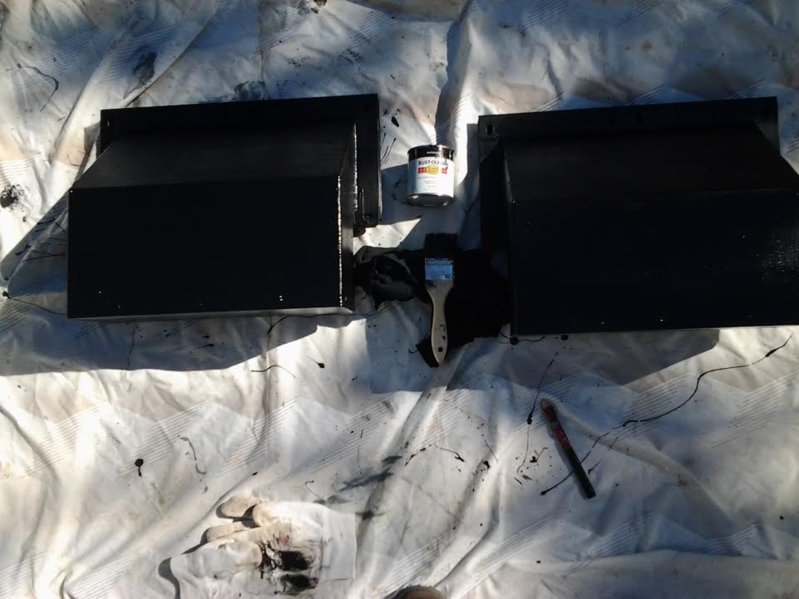

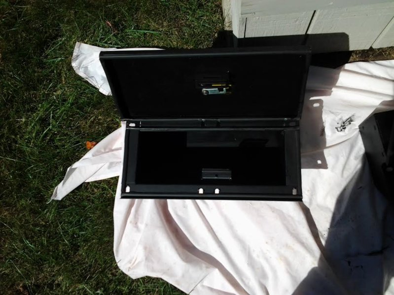

    https://www.tacomaworld.com/threads/tuffy-box-rehab.452125/#post-13281598 I made this thread up a while back after reading this thread removed my boxes and repainted them with Rustoleum and are holding up , I deleted some pictures from my Albums so there aren't a lot of pictures showing, but basically during the summer hot months I put on multiply coats and let bake in the sun of oil based paint. good to know that Tuffy is sending you a new box cause I have since sold my plastic OEMs.

    tuffy boxes are nice but initially I would recommend putting protective coat on them before installing new. Tuffy recommends a rubberized under coating spray to them after the install, I yanked mine out and painted inside and outside with multiply coats of Rustoleum oil based paint and reinstalled.
