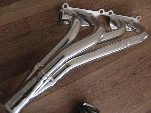

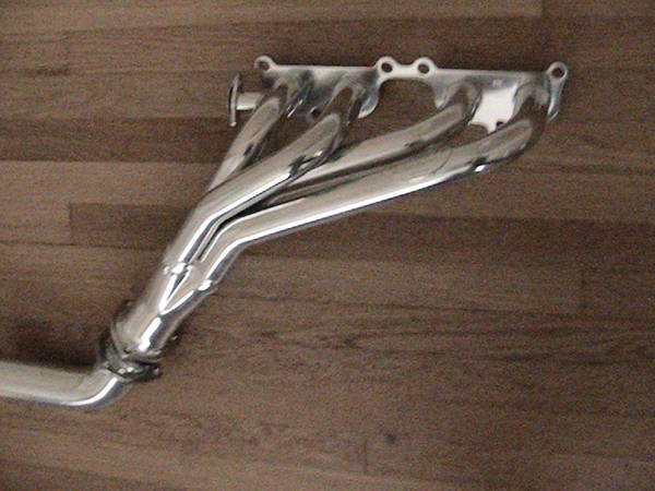

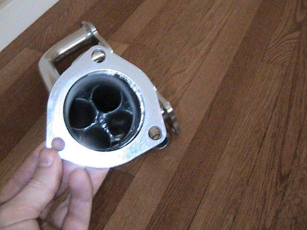

    Hey I just received my DT Tri Y? Does anybody know or remember the part number(THY-506)? Are the 2.4 and 2.7 the same? What did it look like? when I was looking on the internet the "pic" looked like the front 2 cly went together then the back 2 cly combined then those 2 combined thus the "tri y". The one I recieved all 4 cly combined in one. Thx Adam

    Looks like you got the 4 into 1 headers.

    This is what I was thinking?
    " "TRI-Y DESIGN" headers, the primary tubes are paired in a 4-into-2 and 2-into-l formation. This increases the cylinder scavenging effect and improves engine breathing by utilizing the exhaust velocity of one cylinder to help the exhaust velocity of another."

    That is what I thought. I specificly asked for the Tri Y. They are from URD. Not sure what to do. Is it a big enough differance to make a stink. I dont want to be a dick but but it is a lot of money and I want to get what I asked for. Any thoughts?Advice? Thx

    Its not the first time URD screweed something up. I would get the Tri-Y headers. Big gains on the low and midrange with it. Much better than the 4 into 1.

    I am sorry to hear that you are not happy with your new header.
    That is the only header we have for your application. If wish you may return it.
