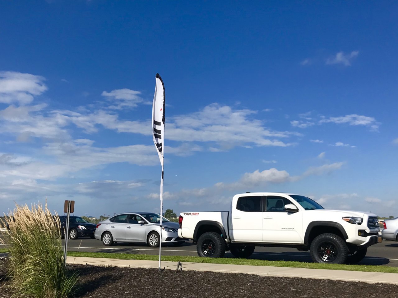

    Thanks all! Got them swap out of the old rims...Nitto ridge Grapplers 285/70R17FB66CFCA-9223-4D96-AD39-979721A4B4E4.jpg

    Looks great, what lift do you have?

    Its just a shitty daystar 2.5” puck lift...gonna be figuring out something shortly

    Nothing wrong with a spacer lift if you don’t go wheeling.
