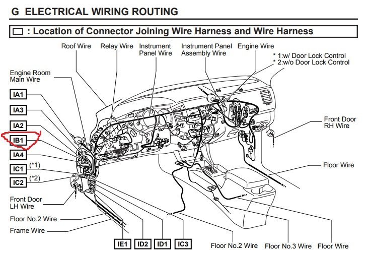

GOT P2433 CODE&P1613 CODE NEED HELP FINDING THE SENSOR LOCATION

    IT'S a 2012 TACOMA 2.7, 5spd,4wd truck wont start had p1604 code first,now got p2433,p1613, changed out fuel pump,injectors,fuel pressure line,throttle body,still wont start,turns over but no crank.

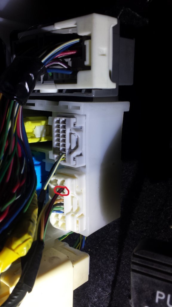

    Those codes are all to do with the Secondary Air Injection System (SAIS), none of them would cause a no start.
    Check connector IB1 Pin 8 (Black/Red) behind the left kick panel for a burnt pin, if it's not burnt then make sure you have power there during cranking.
