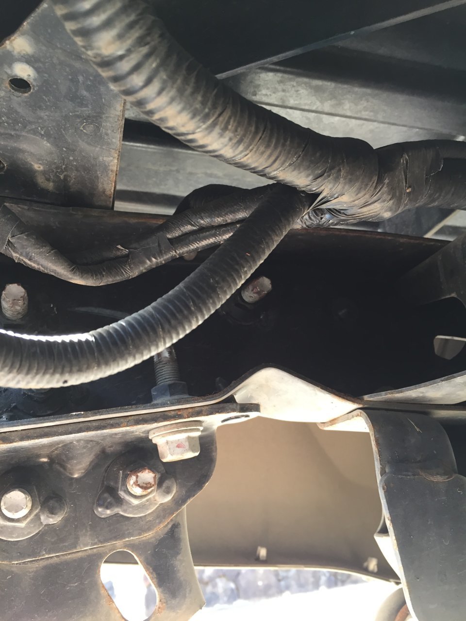

    In my industry, I have seen numerous rear end hits on gen 2 and 3 Tacomas. The hit is on the frame-mounted trailer hitch, and it bends the rear most frame tabs down. Many insurance companies will consider this totaled, though the damage is really minor. Take a look at the rear frame tabs. Look for this buckle, or worse. The rear of the truck is to the right in this photo, the rear end hit was directly on the trailer hitch. This truck was considered totaled by insurance, though it cost only $500 to pull those bends out. Someone's loss, my win, and I don't mind a salvage title at the price I got.IMG_6876.jpg

    Check the frame between the bed and cab. My truck was totaled out because of the frame damage. This was my truck when it was totaled out...
