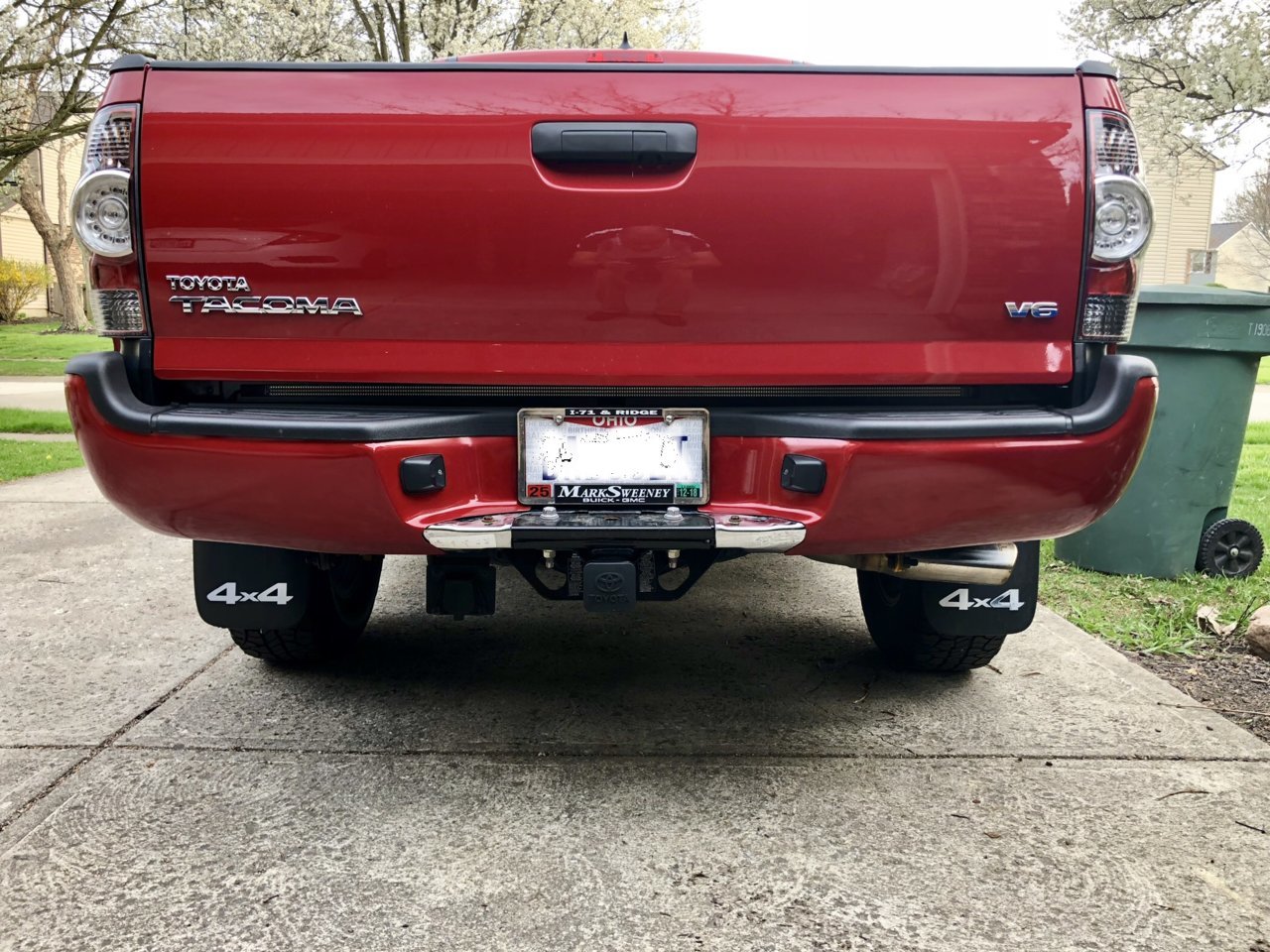

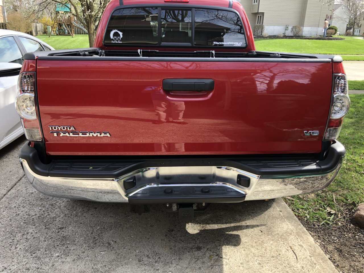

    Finally pulled the trigger and bought a set of bumper shields to cover the ugly chrome bumper.

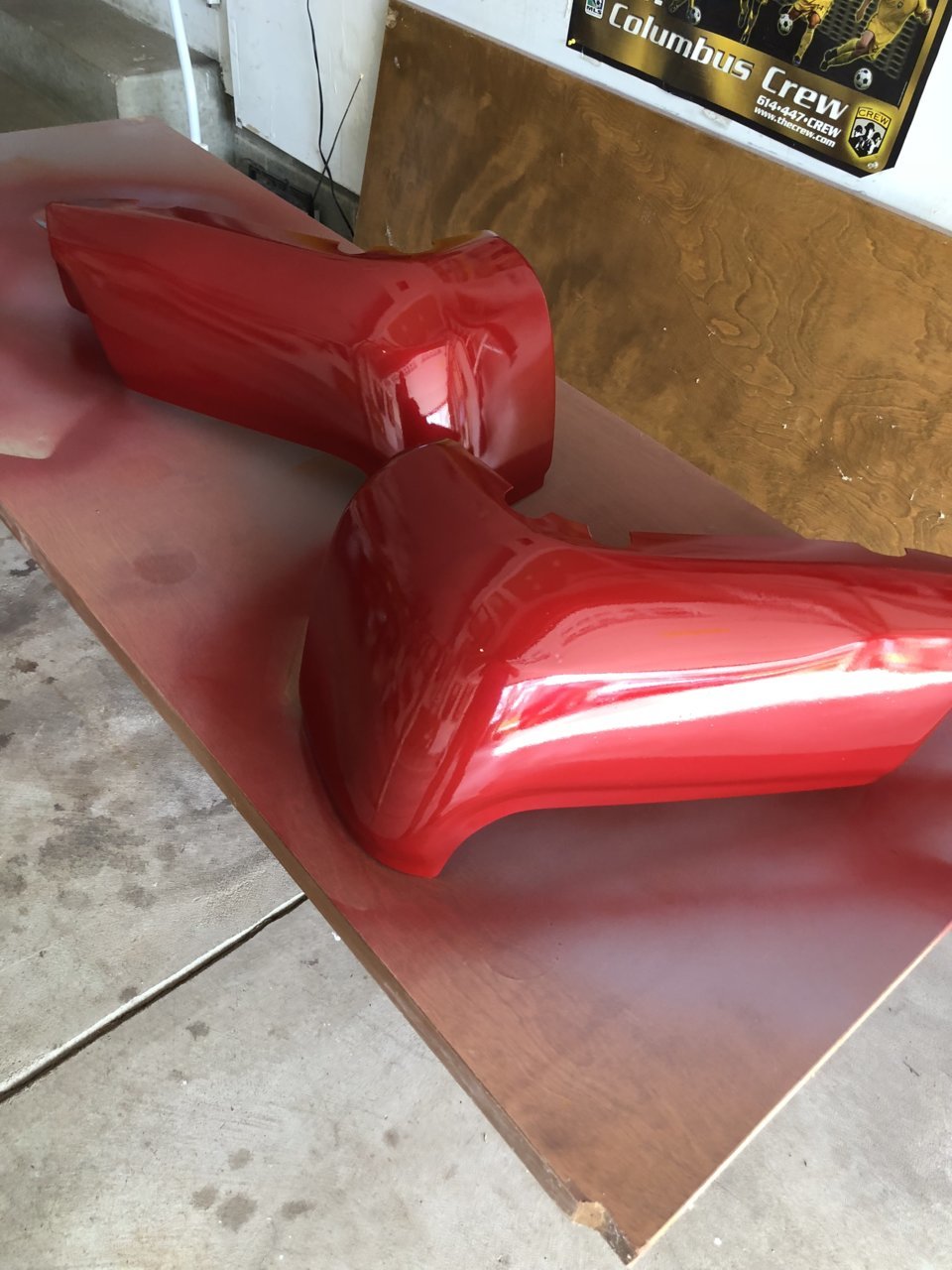

    I purchased the paintable black ABS plastic and painted them to match the bumper. Lightly sanded down the plastic first, followed by a coat of adhesion promoter, 2 coats of primer, and 3 coats of base color (Barcelona Red), and finally 3 coats of clear coat. The trick is not to rush it. Let each coat dry off before going to the next step.
    Perfect match if I may say so myself.
    Very happy with the outcome.

    They are secured firmly in place by double sided 3M foam tape and the upper lip slides under the trim piece. The license plate light housing and the black bumper shield just below the license plate holds it in place.
