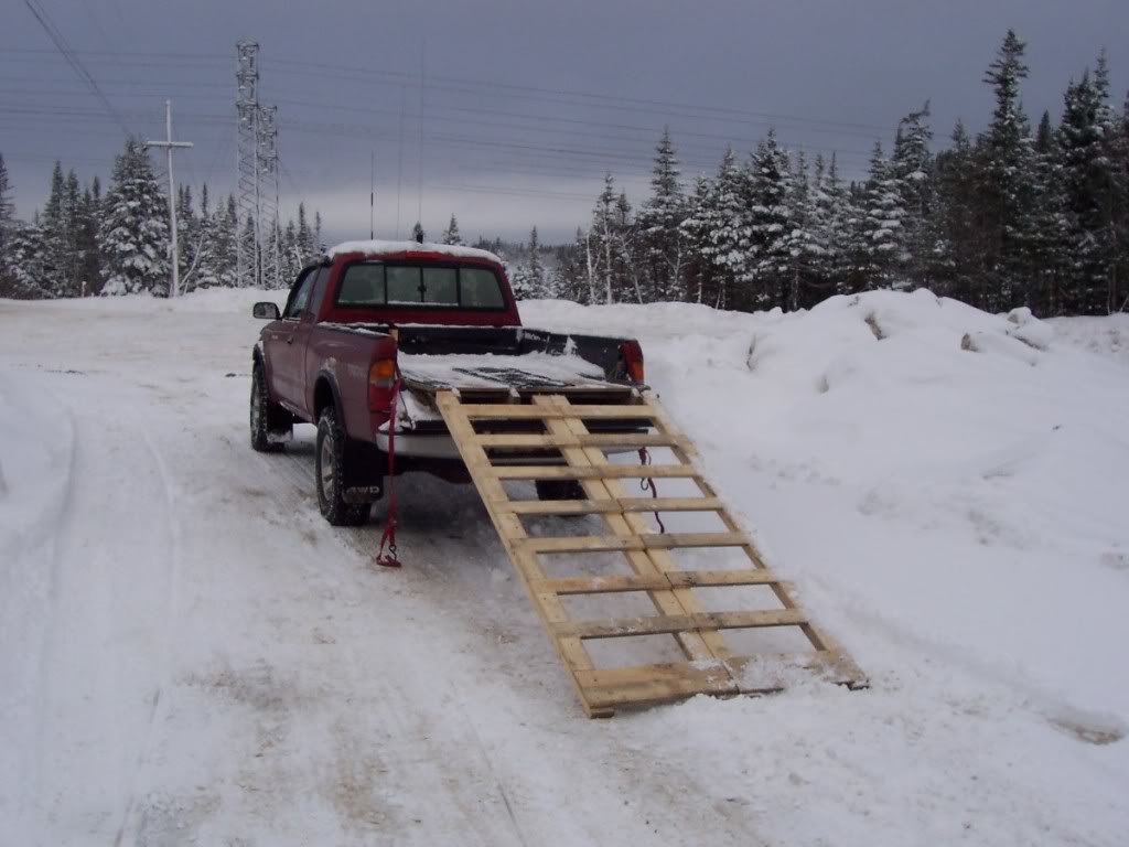

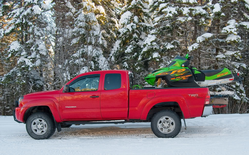

    To eliminate buckling of the tailgate I fabbed up a little false floor platform that enables you to store some loading ramps underneath. A trailer doesn't really fit my needs as I live on a very large hill and backing it into the driveway after a run would be nearly impossible.
    My 2005 TRD Off Road has the leaf TSB done in addition to some Firestone air bags installed in the rear. 5100's up front set at 1.75". I only inflate the bags to 35 psi or so even with the weight of the platform and sled in the back. Bags are rated at 100 psi max so lots of leeway left. The bags are well worth the money and prevents that sagged out look while running lots of weight in the rear. No problems to level to stock height or a height to complement the 5100's up front.
    Pics show my winter steelies as well as the smaller 245/75/16 ice radials I use in winter. Color keyed grill also removed to avoid rock chipping from heavily sanded roads.

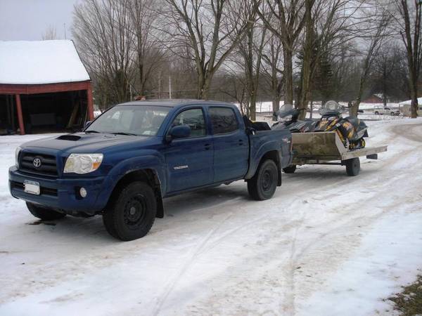

    Nice homemade setup.
    My days of wrestling the sled in the old Ranger's bed are over, esp w/ a 5ft deck. I take the easy route now.
    Also hard to see, but had 700 lbs of wood in the bed in this pic too. TSB essential. And of course, snow tires.

    Wow with your sled in the back its not sagging at all. Looks good!!!

    That is a great deck, I have not seen one like that in a Tacoma, but have watched a few put em up on the sled decks that sit on the bed rails. Hats off to all that ride it loading it up there. :thumbsup:

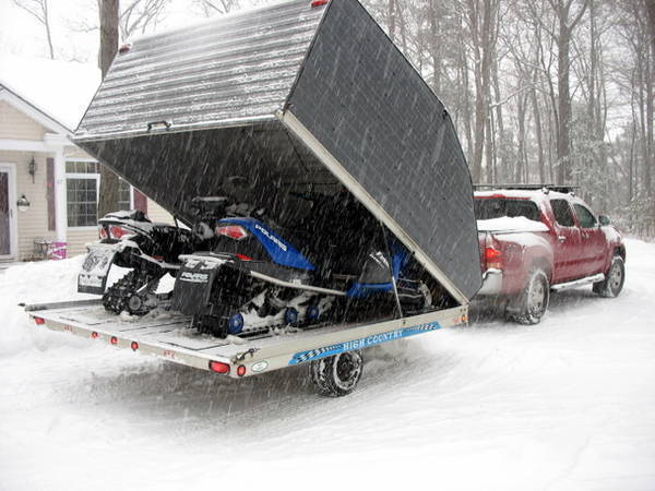

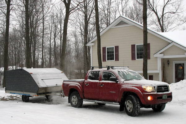

    I also swap out my tire setup with a set of studded tires for more traction for winter towing, great idea on swapping out the grill too, for I am going to have a color-matched done this spring so I guess I will keep my chrome grill.
    My setup is all aluminum tilt enclosed, it tows nice but likes to eat up my gas with so much drag. It does provide nice summer storage tho. We are heading up to camp again tomorrow, cannot wait!

    The thing I don't like about the sled decks over the rails is that the center of gravity of the truck is increased dramatically. Even raising my sled up 8-10 inches level with the wheel wells makes a HUGE difference when cornering. I see sled decks on lots of half tons but wouldn't try it myself on anything less than a 3/4 ton.
    Love the yard - especially all the trees. What species are the larger/taller ones?

    Thank you, one of the reasons I liked the yard was it was flat & surrounded by healthy trees, maple and oak. My neighbor is a fellow sledder & owns a tree company who pruned them up high for me :) I do get lots of leaves in the fall though ....

    What kind of gas mileage are you getting with your set-up?

    It averages around 11-12 on mostly secondary hilly roads & minimal highway/flats...because of the elevation, OD is off. Also a lot of the time it is in 4WD. It tows great though fwiw.

    Sorry to bring this thread back up, but how in the hell did you manage to bolt that down to your truck? I just bought a tacoma and need something like this to haul my sled around, cant seem to figure out how I'd bolt the ramp down into the truck.

    If you do the " Add D ring mod " you can secure the ramp and deck at the front of the bed .
    Not sure if this is how Fortech did it though

    To keep the platform from falling out of the truck, I have a couple of eye bolts attached to the rear so I can tie it into the truck (note yellow rope).
    If you are worried about the front of the platform popping up while you are climbing the ramp, I've never had a problem. If it would make you feel better however, I mounted a piece of 2x4 vertically at the front of the ramp. On the top of the 2x4 I cut a notch in the shape of a V. If the 2x4 is the same height (or higher) than your front tie down points, you can run a strap from one side of the bed to the other, passing through the notch in the 2x4. This will keep it from popping up. Kinda hard to see and I wish I had a better pic, but you can kinda see the 2x4 in the front of the bed of the below pic. That's the setup I used in my previous '98 Tacoma.
