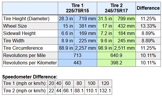

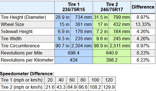

    drewmox
    drewmox Well-Known Member
    Jun 15, 2020
    #331556
    130
    Andrew
    2003 4x4 3.4L Black DC
    SS3 Fogs, Bilstein 5100s, KC Cyclone 3rd brake, stock AF otherwise.
    The size difference is a bit more compared to original.
    Previous vs new:
    Stock vs new:
    The weight of the entire wheel is going to make a difference too. Rotational mass is a lot "heavier" than static weight on the truck, so it's going to take a lot more power to move than something loaded in your bed.
    All the theories are going to be different from each person, but your real world experience is all the proof you need that it is negatively effecting your MPG. Rest assured though anyone who changes to a larger wheel and tire always loses MPG, you are not alone. :crapstorm:
