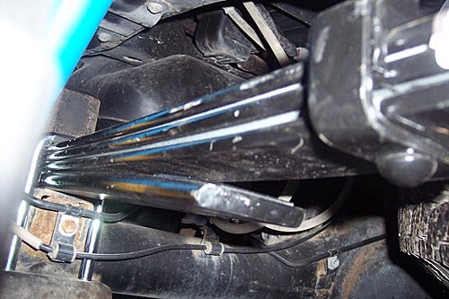

Got the leaf Spring TSB. Here are some pics !

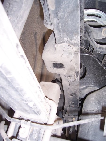

    Discovered the TSB yesterday. My 07 Dcab bottoms frequently. I've got shiny spots were the bump stops hit. I'm at 18 months and 42K miles, but see in the posts that many have succeeded in getting it done when past 3yr/36K. Got an appt tomorrow and have contacted toy c/s via email, but have not got a response yet. We'll see what happens.
    Added pic of shinny spots.

    ok on all these add a leaf lifts that bring 1.5 " of lift, does that mean with the tsb (4leaves)? does the tsb add lift or not?
  15. Aug 17, 2008 at 10:12 AM
    #255
    tacomaman06
    tacomaman06 Carolina Alliance: Enforcer
    May 1, 2007
    #1475
    26,212
    Will
    York,South Carolina
    '16 Tundra TRD Pro
    getting there....
    with the tsb springs, you will have a bit of lift in the rear, but over time, it will settle a bit.

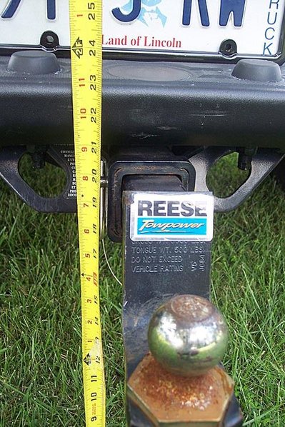

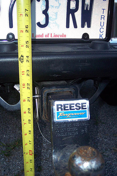

    Here are some shots of my before and after. They were wrong about the extended warranty coverage, extended would not cover the TSB ... however, my truck was only 2k over on miles, so they were able to do the TSB as a goodwill.
    The new leafs raised the back about 1 1/4". I was lucky and my dealer did my front shocks also. The truck rides so much better, especially when loaded. Huge thanks to Marion Toyota!
    Jay
