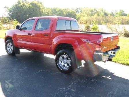

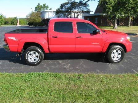

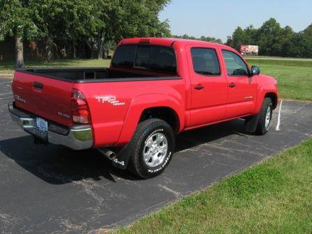

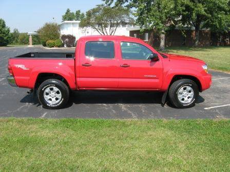

    Before and after rear spring TSB pics. Just 1" higher in back. Not too noticable. But very happy about the ride!:D
    Before
    After
    Before
    After
