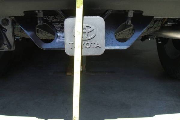

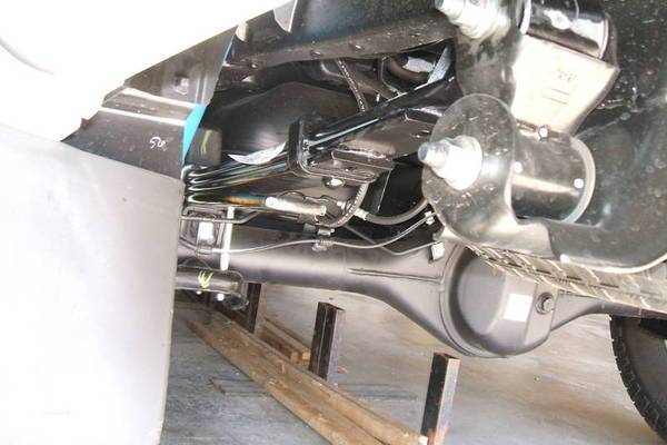

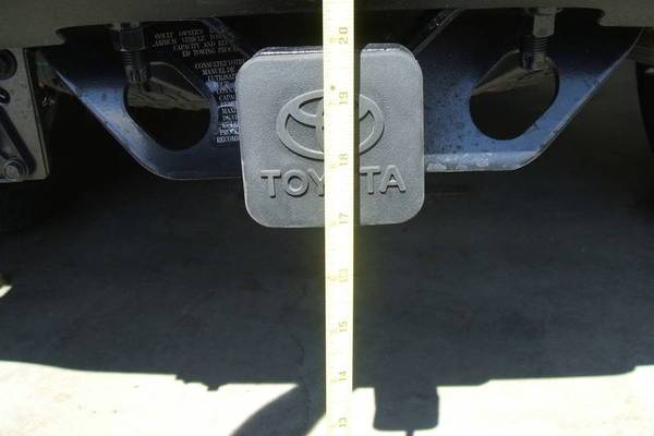

    They replaced it with just 3 leafs again? What are the part #'s on top of the spring? If the last digits are 04550 RH and 04190 LH you still have newer OLD parts. You mind checking?

    Sorry, seems they replaced yours with new OLD parts.
    Mine are 4 leaf springs. They did not replace the shocks. I had a TRD truck with the Bilstein's already, as the TSB states. I got the 4 leafs, U bolts, and a alignment in about 4 hours. Raised the rear approx. .75" and made the ride more firm, as in sports car like. I like the way it feels already.
