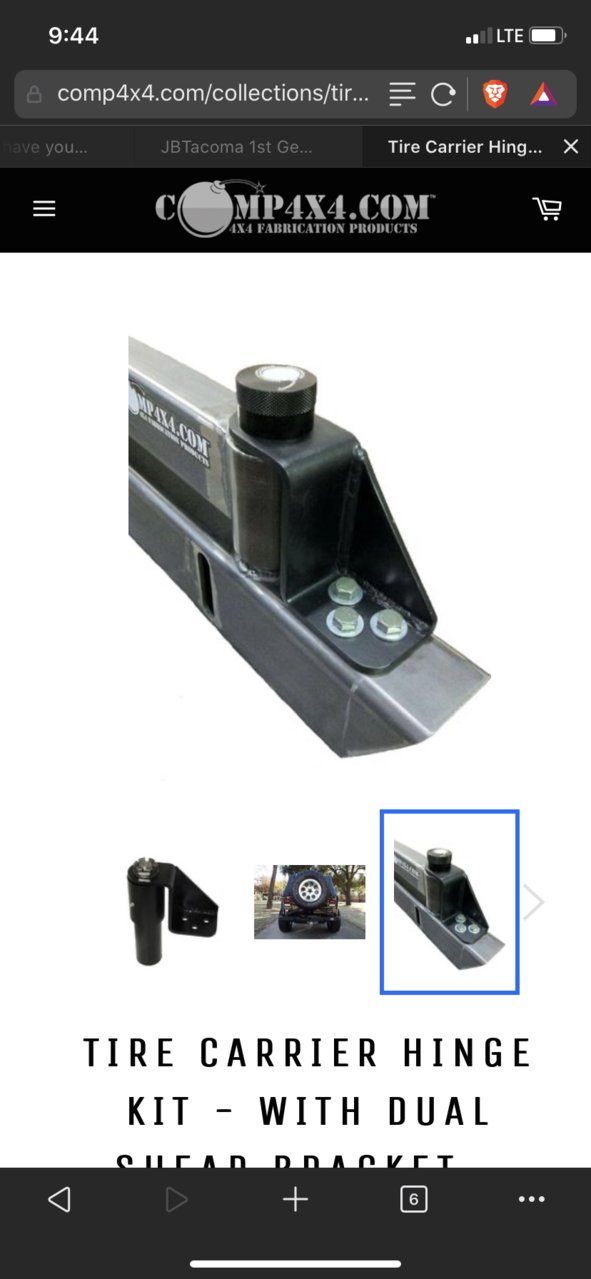

    Anyone know what the "C" shaped bracket is called or where I can get one? I've looked on Comp4x4's website where this pic was originally from but the only issue is this pic was found under a pinterest page under a google image search. The actual website doesnt seem to have this exact setup anymore.
    Trying my hardest to create Fernandos setup since it doesnt envolve cutting off the shackle mounts.

    I saw that too. Don't think it'd work though. Our bumpers are the same width as the tailgate. So the bracket needs to come off the side of the bumper so the tailgate can open without hitting the coupling bracket. Thx for posting though!

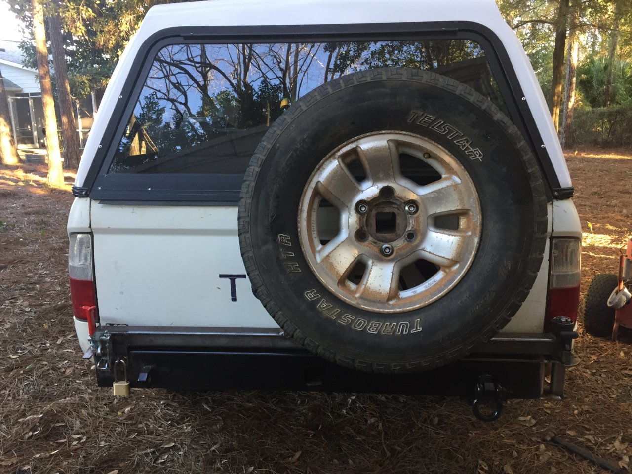

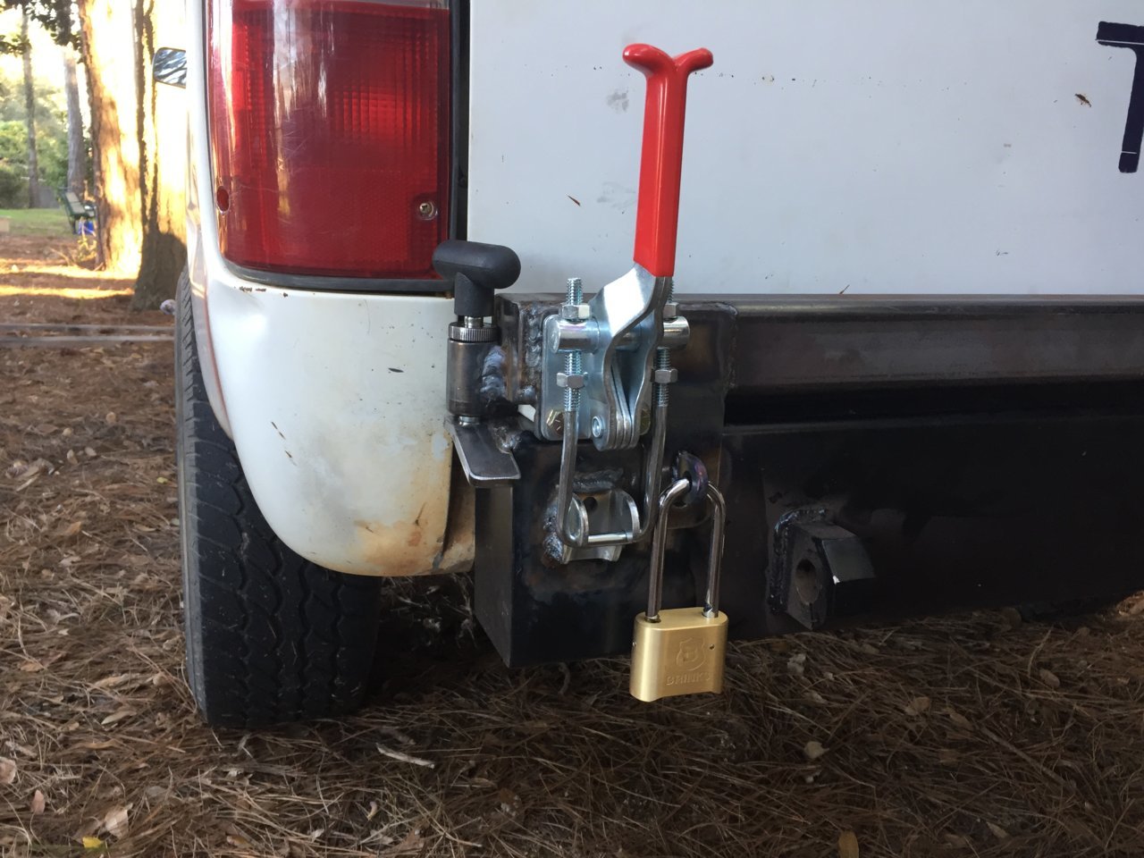

    Here’s what i did. Bumper is a piece of 3x5 3/16 wall. I’ve boxed everything below the bearing and it’s all painted now

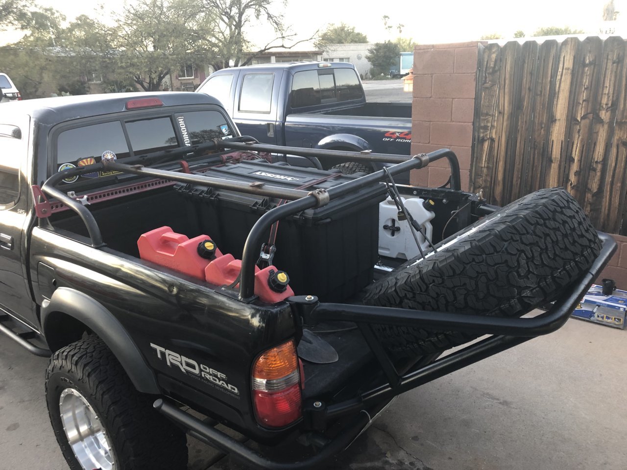

    Just installed my swing out today.
