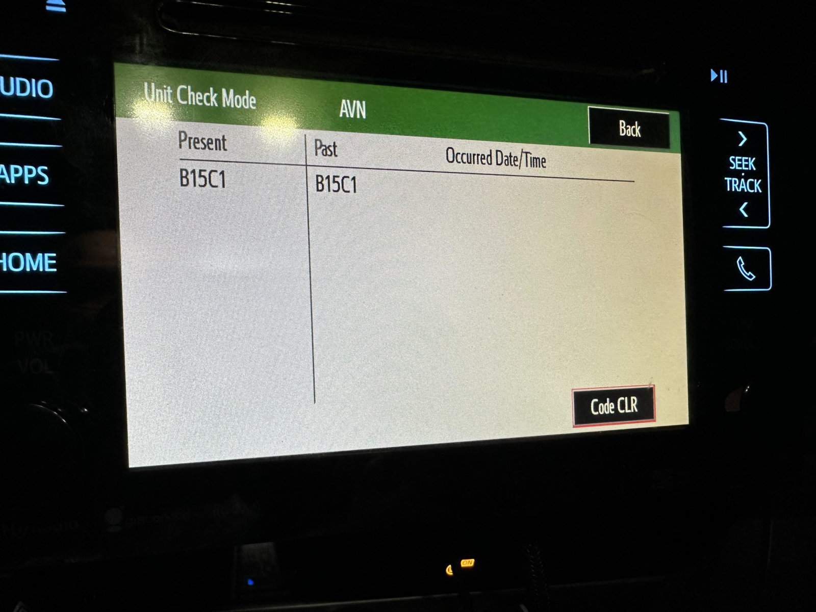

    Since I've had to reinstall the Entune 2 (long story), my radio time never set, and I didn't get a GPS signal. I thought it was going to be a problem with not having the antenna properly seated in the rear of the radio, but I pulled it out and everything is seated normally. Bringing up the diagnostic menu on the Entune 2 gave me the following message:
    B15C1 - GPS Antenna Connection Malfunction Break
    Clearing the code and retesting immediately brings it back, so it's antenna related.
    So here are a couple of questions:
    1. How difficult is it to swap the OEM GPS antenna? I found one online for $175, but it looks like getting it into location might be a PITA.
    2. Is there a cheaper aftermarket GPS antenna I could go with? (The 3.0 looks to be the same GPS antenna connection as the 2.0)
    3. Is there another diagnostic step I'm missing?
