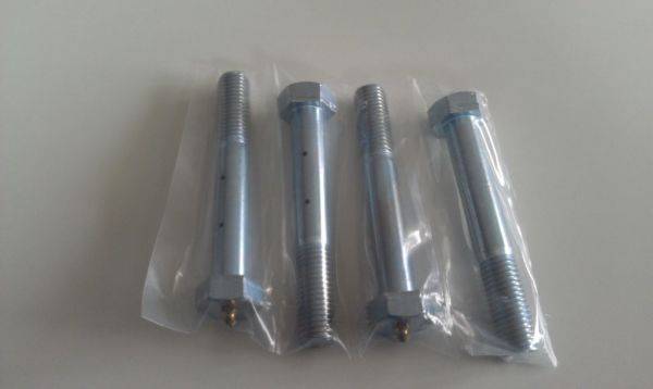

    Well Saturday's projects have arrived.
    New Greasable Bolts for the springs. I forgot to order the nuts so I will have to pick some up.
    And the Defined Engineering Extended Length Shackles.
    I forgot how much larger Greasable bolts were. I am going to have to hone the holes on the spring mounts in front and the shackles in back. I will also need to remove the bushing sleeve on the spring bushings. Nothing crazy but a bit more time consuming now.

    What size are those new shackles?
  10. Apr 11, 2013 at 4:10 AM
    #250
    Gramps
    Gramps [OP] My walker is faster than your Prius!
    Feb 7, 2011
    #50695
    14,329
    Gramps
    Colorado! Where else?
    07 TRD DC 4x4
    A small handful of select mods.
    They are 1/2 inch longer over stock. Since the flip I have has adjustable holes I can play around a bit to see what works best.

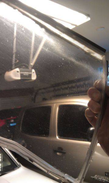

    Cleaned up the lenses on the headlights this morning. Used the 3000 grit wet sanding discs from an old lense renew kit I had and then the head light polish on a buffer to finish them off.
    Just a bit of oxidation on them
    All cleaned up
    The deep pits did not come out. I would have had to go through the entire Lense Renew process and really sand down the lenses to get rid of the pits. But this will work out just fine as the completed headlights will get clear bra on them before install.
    Hopefully I will be re-gluing them tonight. Just waiting on something to customize the BHLM. Hopefully it comes in the mail today. :cool:
