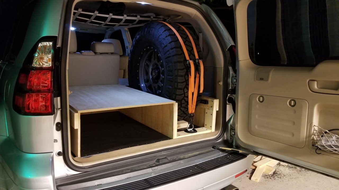

    Getting shit done on Agnus. Storage and a sleeping platform. Should be able to get it finished this weekend.
    20180930_143053.jpg 20180930_184938.jpg 20180930_194335.jpg 20180930_202439.jpg
    Replaced the 2 orange straps on the tire with one wide 2 inch strap from Murdoch's already. Top of the drawer will get a piece of HDPE Plastic just like the bottom under the drawer did. Plan is just to build a fiction slide drawer at this time.
    Wings and front platforn will get tan automotive carpet on them.
    And I pick up a new fridge plus a winch on Friday. :D

    Wow, sucks you have to store the Spare back there, eats up a bit of limited room for sure.

    I prefer it that way vs a swingout with all that weight bouncing around on a hinge slowly working its way to sheer off the bumper.
    Actually pretty happy a 35 inch tire fits vertically in there. I could actually fit a 37 inch tire in there.

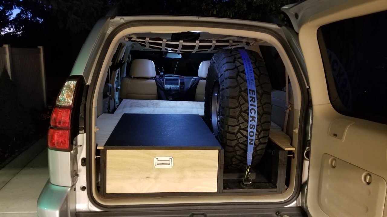

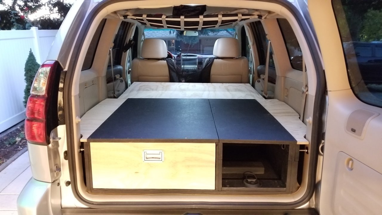

    Things getting done today. Need to get out to RT next weekend!
