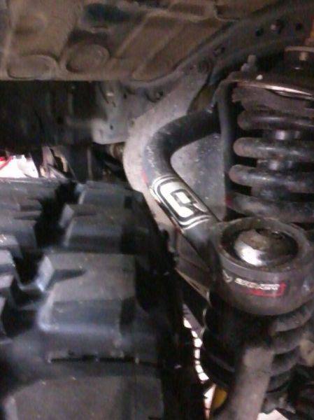

    Thanks. You clear everything fine or should I consider 3.5 BS?

    full lock
    i'll be crawling under there more sunday most likely to see first hand and do some clearancing
