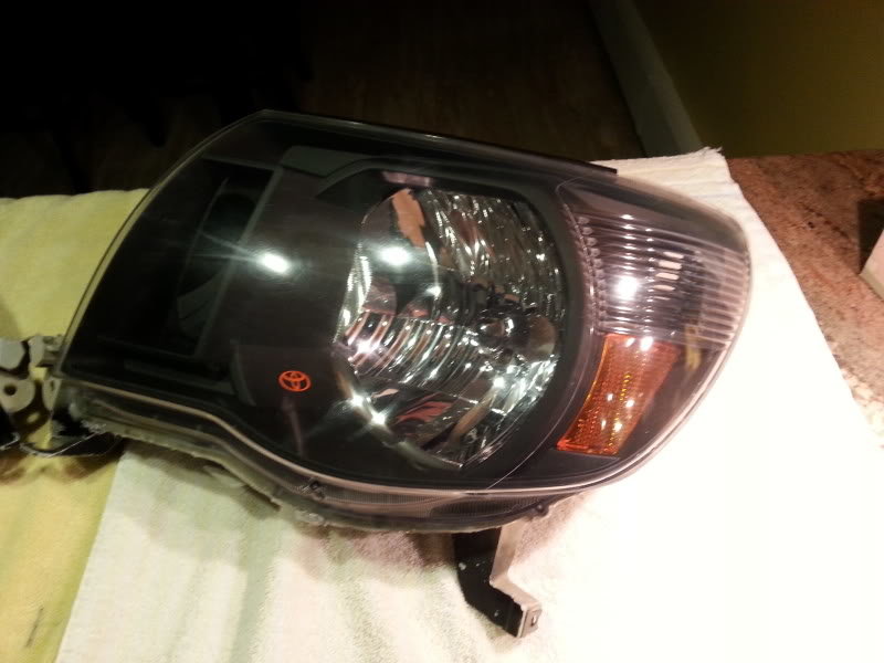

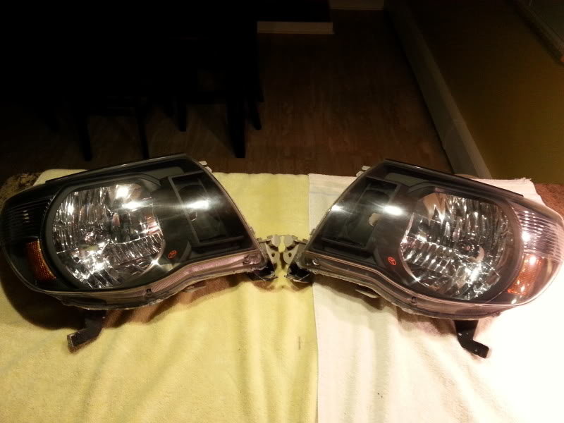

    All Finished and sealed up with some kick ass silicone. I will put the front end of my truck back together tomorrow. They turned out pretty good.

    Nice work gramps. :popcorn: for the picture with it all on there.

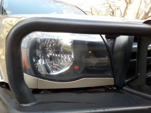

    Here is a one side shot on the truck.
    I have to get a better full front shot cause the one I took looks goofy. Thanks for the compliments guys.

    Do you have any pics of how you trimmed your ARB for clearance?

    Sorry man. It was done quite some time ago as part of a charity fund raiser for Wheelers for the Wounded. I did not get pics. But what I did was straight line cut it with a plasma cutter. It meets up with the body line in the middle of the fender. Then we welded a piece of plate back on the end, ground it down and sprayed it black. Plenty of room so far and it should clear 35's in the future.

    No worries - appreciate the description. I now have a pretty good sense for how and where you trimmed it from your pictures as well.
