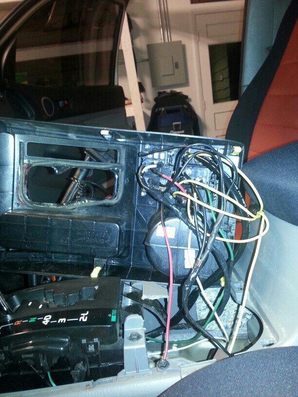

    Just how your wiring looks underneath, how you mounted the switch holder. And any other pics you might have

    Really the only other pic I have is this one.
    The holder has tabs on it like the switches. So just cut the hole ( I used a dremel) large enough to let the holder slip in and it will hold just fine.
    Take note of where you position it. If you go too close to the auto shifter there are some parts underneath that hold the shifter in place that will be in the way. I found out the hard way with the two winch switches above.
    All of the power leads go back to the engine bay coming from a Blue Sea Fuse panel I installed. The accessory power for the switch lighting comes from an accessory wire by the shifter that lights up the shift panel when the lights are on. I also used a common ground screw that was right there in the center console to ground all of the switches. I sodered everything and put heat shrink on it all so hopefully none of it ever comes apart.

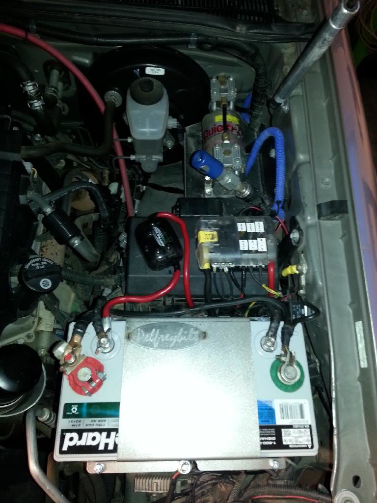

    I am a bit late getting around to posting pics but last weekend I installed my Pelfreybilt Battery Cage with Die Hard Group 31M battery. I also cleaned up my wiring a bit. But now I am out of room on my Blue Sea. I am gonna have to get a larger one. ;)

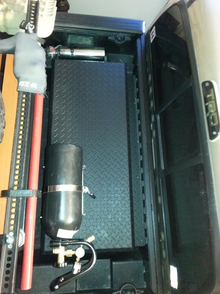

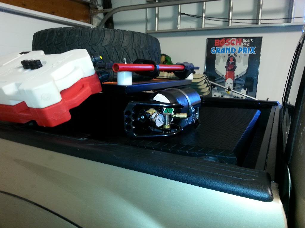

    Today I mounted my CO2 tank holder and tank. This was the only place that I could access it. I might be moving to a full bed rack sometime this year and will move the location then. But for now it is secure and easily accessible.
    It has a bag for winter use to keep it warm and I want to pick up the rubber molded base to protect the tank a bit.

    still able to easily open the toolbox?

    You have to pull the lid up but the supports will hold it up once up. I only plan to keep the tank in the mount when wheeling. I will store it in the garage at other times.
