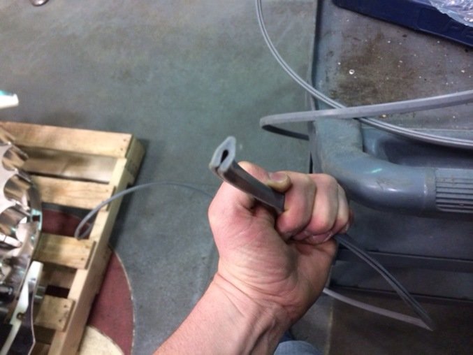

    Will this work

    Might if it was black. Does it have adhesive in it or does it have "catch" fins in the channel to hold it in place. Is the total width about 1/2"?
    That gray might look cool on a Silver truck though.

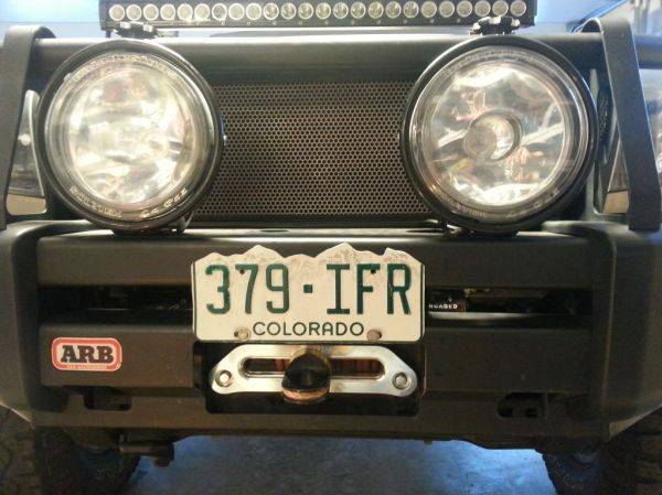

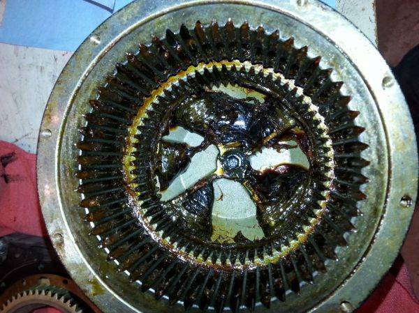

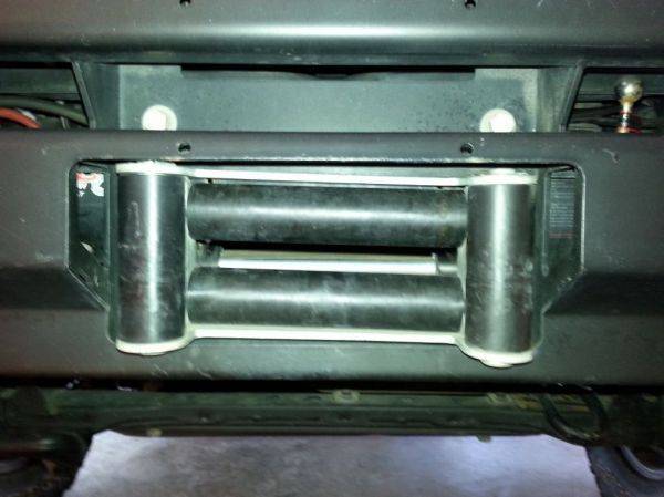

    Took out the XRC8 today to re-grease it. Upon removal I noticed that a slight incident where my dog turned on my winch on and wrapped it up a bit bent the fair lead fairly well. So much that the roller would not turn. Rather then try to square it up I just decided to replace it.
    So from there I went about tearing down the gear box and re-greasing. Simittybilt suggested I use Mobil 28 Aviation Grease. So that is what I got.
    It was time:
    Picked up a Spidertrax offset Hawse Fairlead and got it installed. Now I just have to keep an eye on angle pulls so the line does not make contact with the bumper and fray it.
    An now my front license plate holder will no longer work because it was designed to hold onto the rollers. I tried another design that slips into the hawse lead but it did not work either due to the amount the hawse is recessed in the bumper.
    So both will be up for sale soon.
    So I just decided to hard mount the license plate an redrill the holes on the plate to match the silly Aussies and their small plates. I didn't like the plate sticking up above the top of the bumper so I "modified" it "Dylan" style. :D
