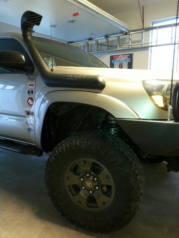

    Started in on the fender trimming today to fit 315's. Got the front done. Tomorrow the rear.

    Looking good Gramps. Thanks for letting me join in on that.
