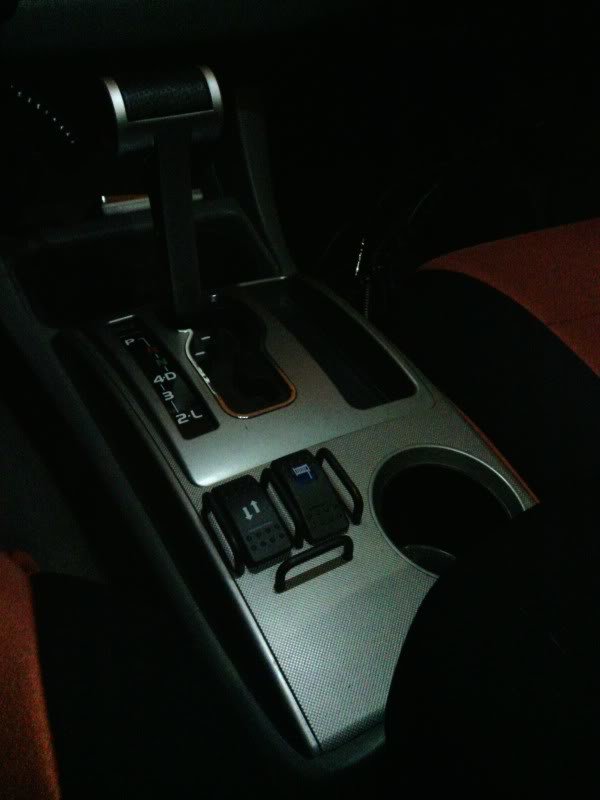

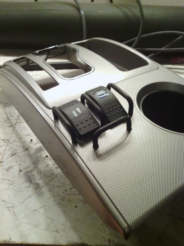

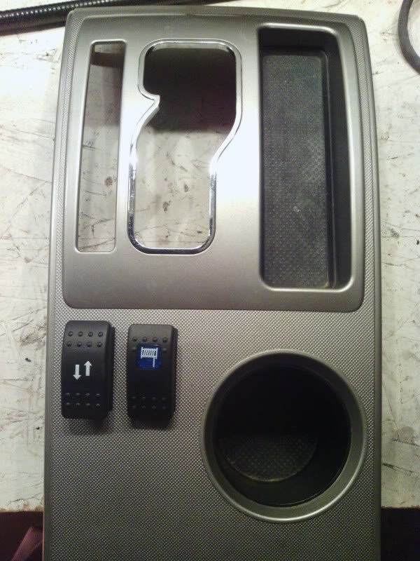

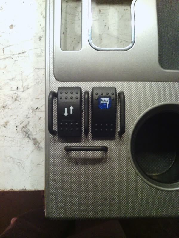

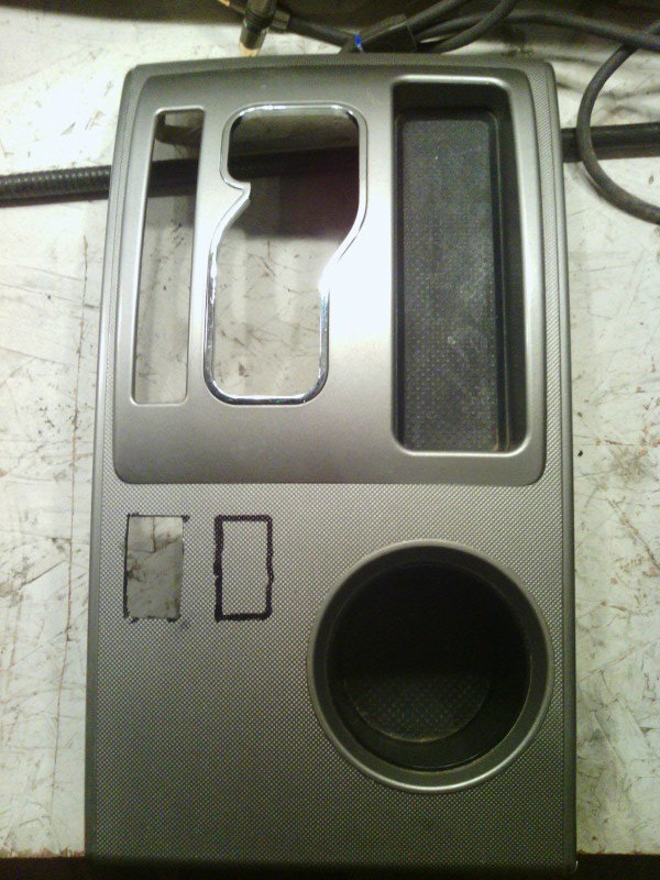

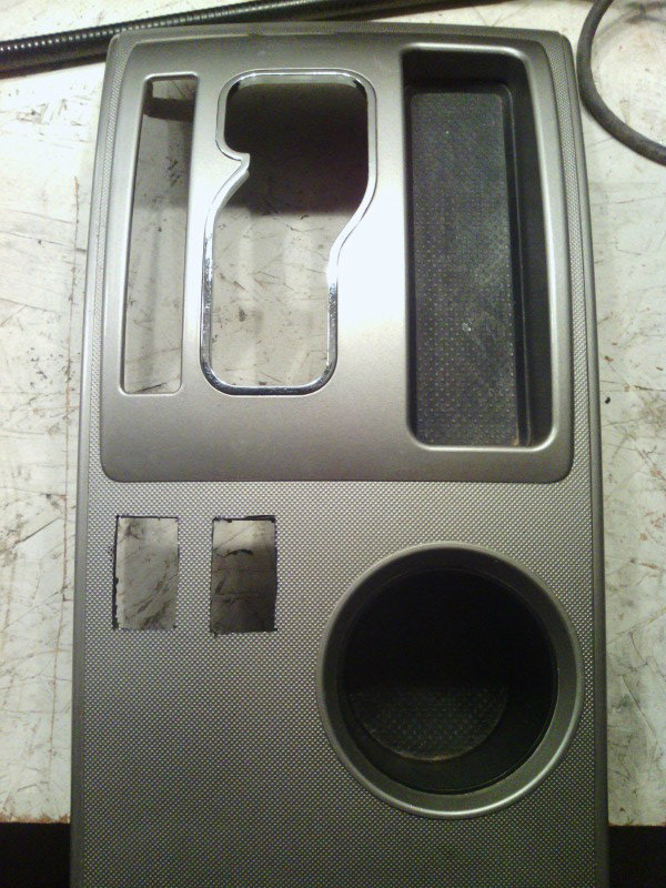

    OK. Finished step one of the in cab winch controls. Wanted the controls to be easy to access while steering the truck still in a sticky situation. I am not feeling pulling the head liner down yet to put a set of controls up in the ceiling. So the next best place is on the center console. My problem is I have a clumsy German Shepard that likes to take over the drivers seat when I vacate it. So I need to protect the switches somehow so the winch did not accidentally get turned on. Found this website with switch protection bars for airplanes.
    http://www.periheliondesign.com/switchguards.htm
    They did the trick once i painted them flat black. :)
    Note to anyone following my switch location. With an Auto this switch location requires cutting of one cross support and a portion of the auto slider cover (not certain what this is called) under the center console. I did it this way because eventually I will have 2 more switches mounted behind these.
    Not a perfect art but luckily the switch covers any imperfections made while cutting with a Dermal. :D
    Switches installed now:
    Trying to get each of these installed perfect was a pain.
    This kind of shows how they protect:
    And installed:
    So next weekend I will work on running the wiring and getting everything wired up. Oh and not to mention I need to move the control box under the hood and get longer cables for the winch. Should make for a fun weekend.
