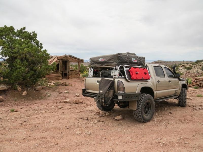

    Nice Rack! Do the sides with the Rotopax swing up?

    Thanks man. Yes they do swing up. At the moment it is a prototype. I am working with Low Range Off Road and they are currently revising the design. I will have more information about it in the future.
